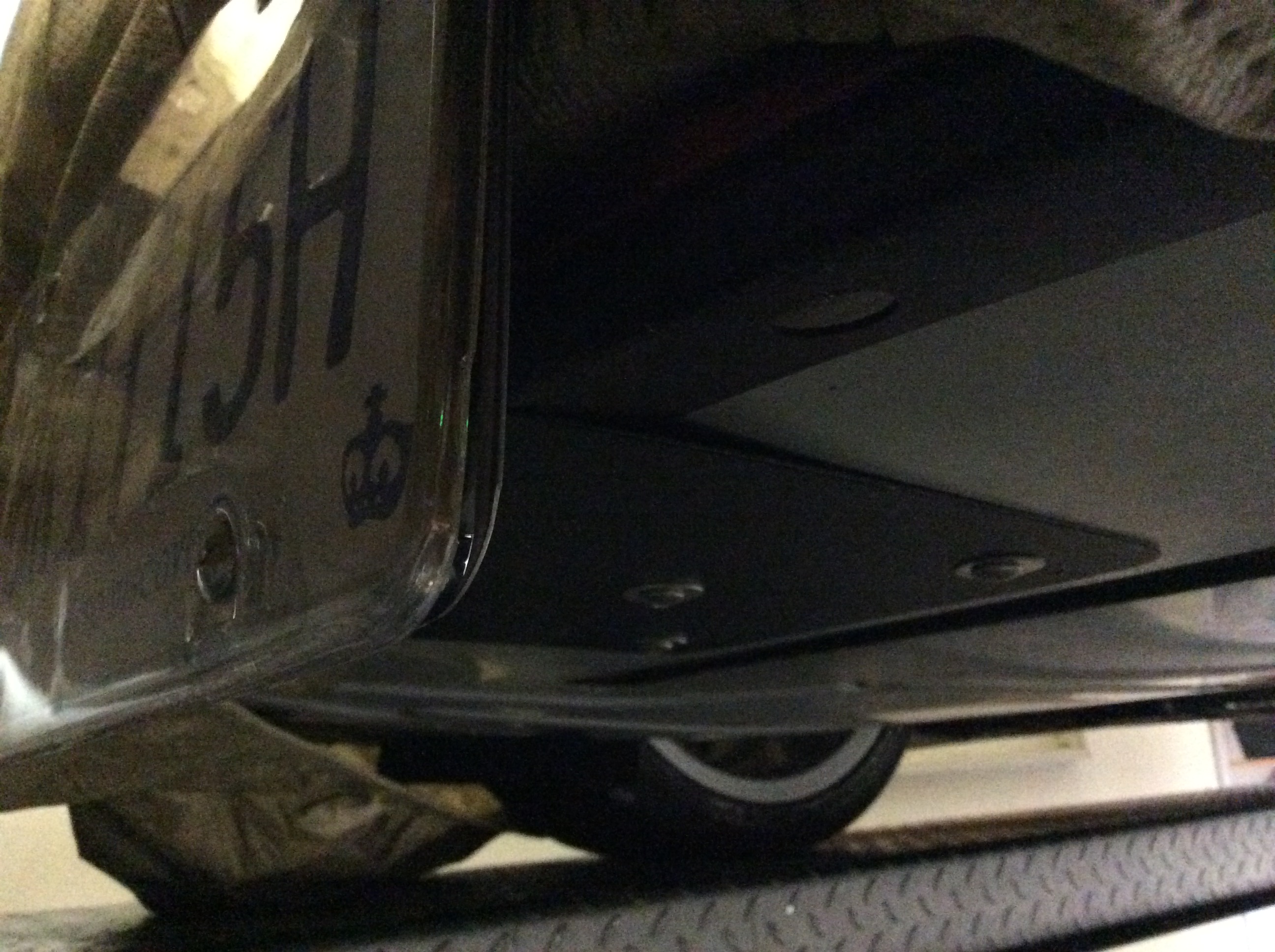

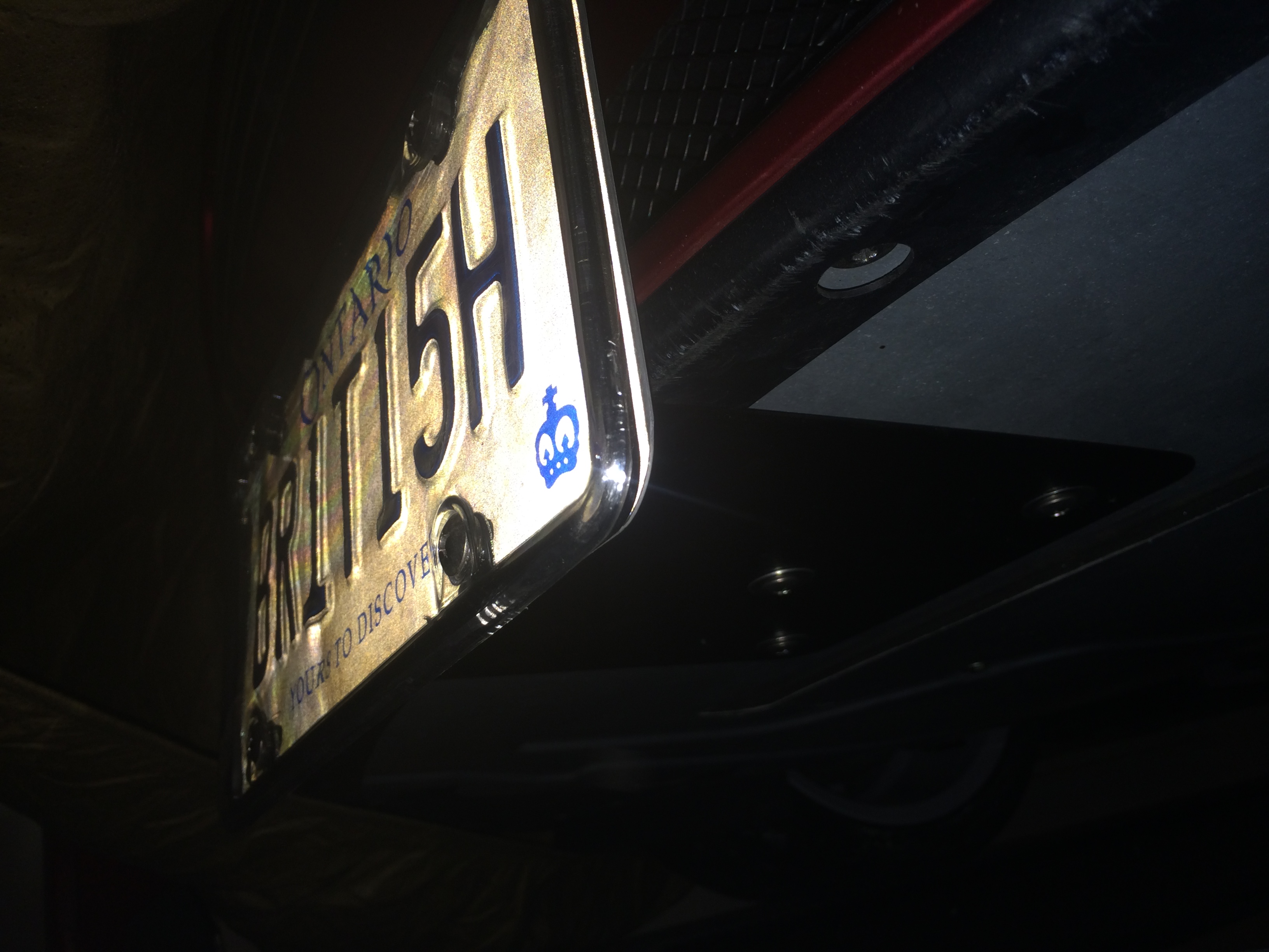

I got my Vanatage from the US (no front plate) Front plates are required in Ontario but I didn't want to drill the bumper/spoil the front look of the car so I made my own bracket . Just a simple piece of reasonable thickness sheet metal bent at 90 degrees then used some aluminum flat bar the make some plate supports . The sheet metal fastens to the front undertray . I drilled it and installed nutserts so it can accept a 1/4" bolt . The whole thing can be removed easily and all that will be left is the nutserts in the undertray .
Pics aren't great but you get the idea .
Are you able to actually post up better pics when you get a chance? Unfortunately I live in a state in the US where front plate is required as well

Please don't drill into the front bumper of any Vantage. All Astons sold in the USA come from the factory with a front plate mounting bracket. If you bought your car used and it doesn't have one, chances are the previous owner did not include it with the car when it was sold. The bracket bolts into two black vertical beams in the front structure of the car. If you look through the slats behind the grille you should see the holes where the bolts go.
You can contact your dealer to get a replacement bracket. If you live in a state that requires a front plate, they should supply you one at time of sale, so make sure to ask for it.

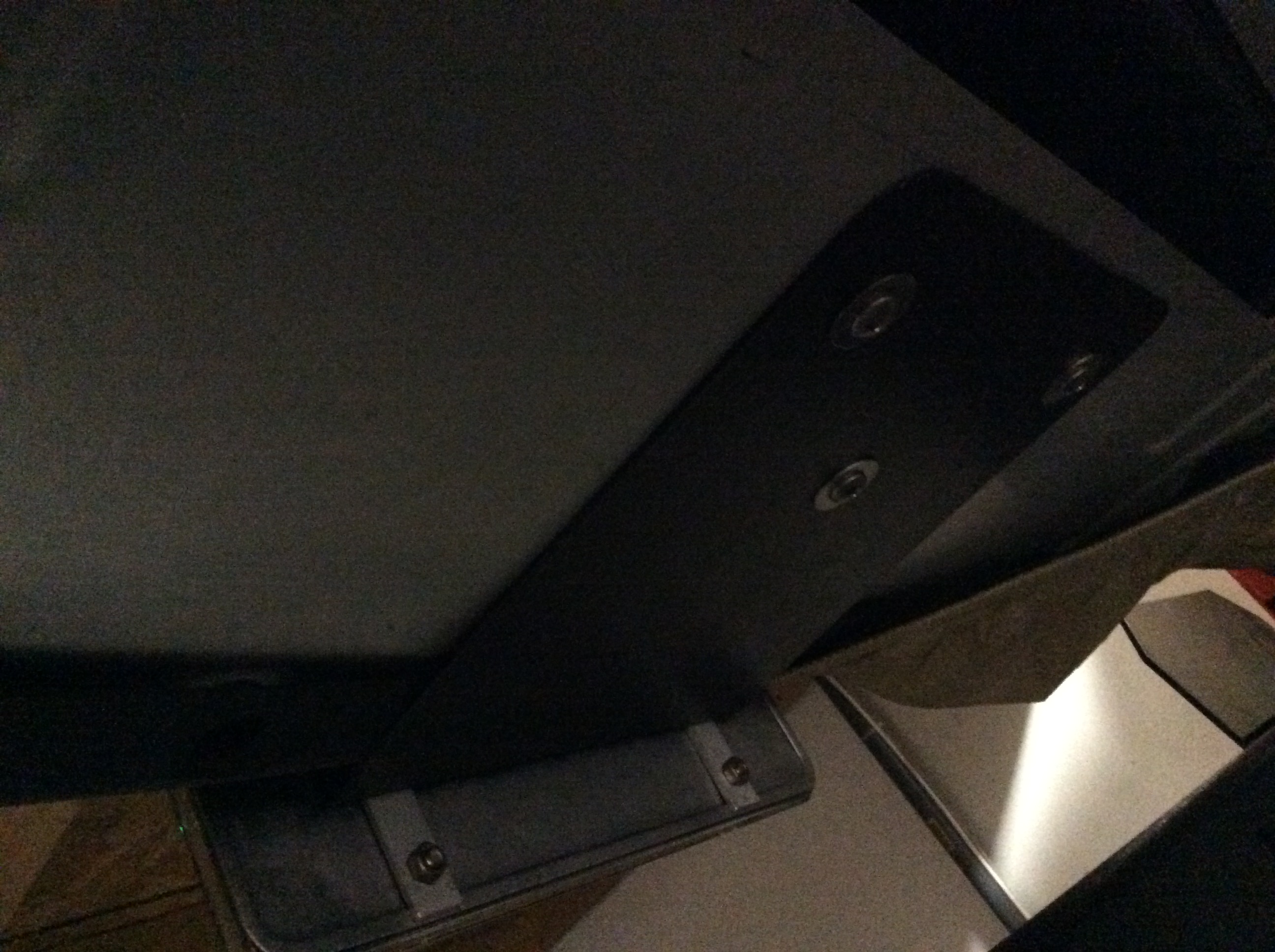

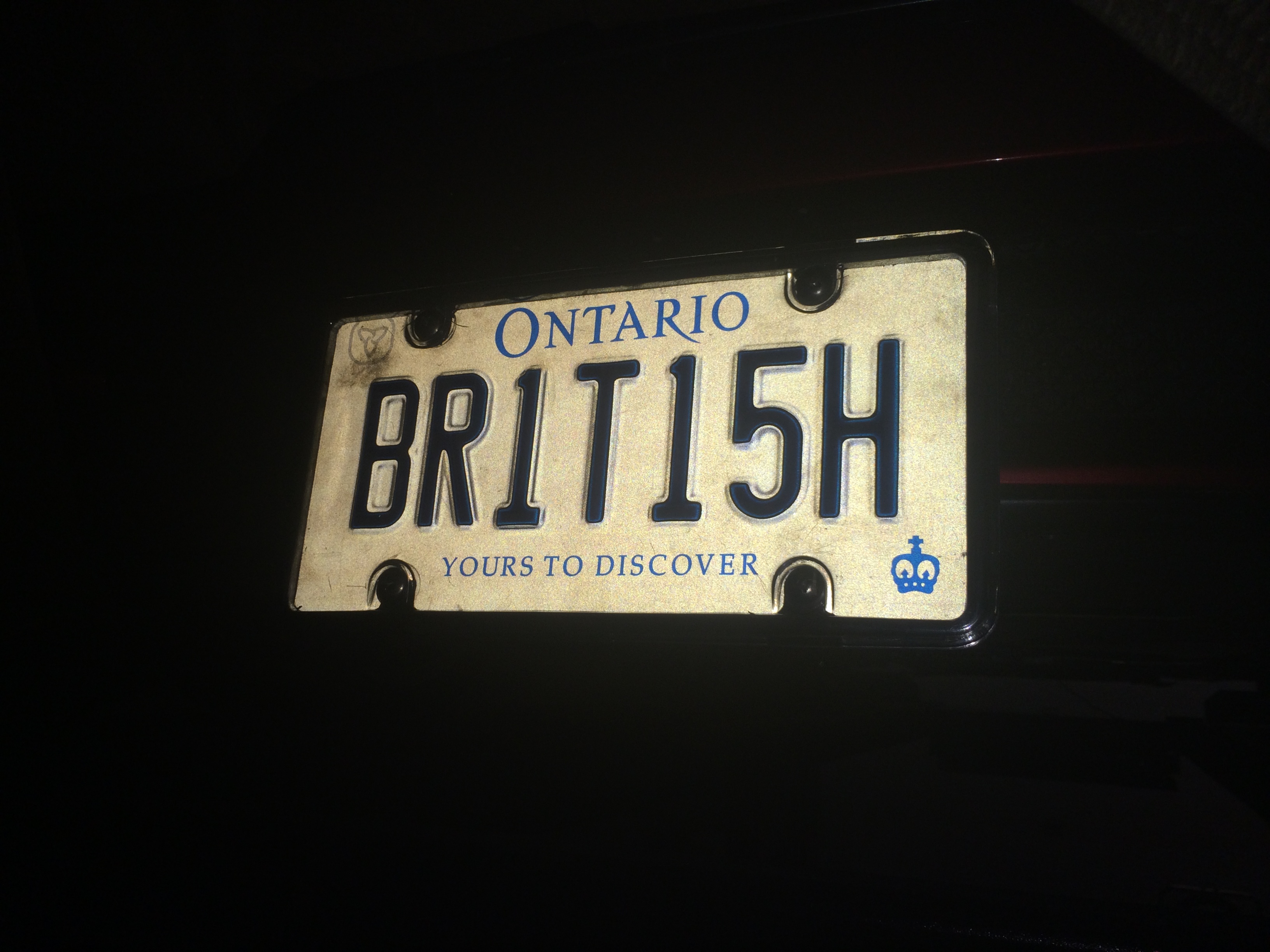

These are better . Im also going to put 2 more nutserts closer to the front to eliminate the flex in the sheet metal . If you used thicker sheet it would be better .
