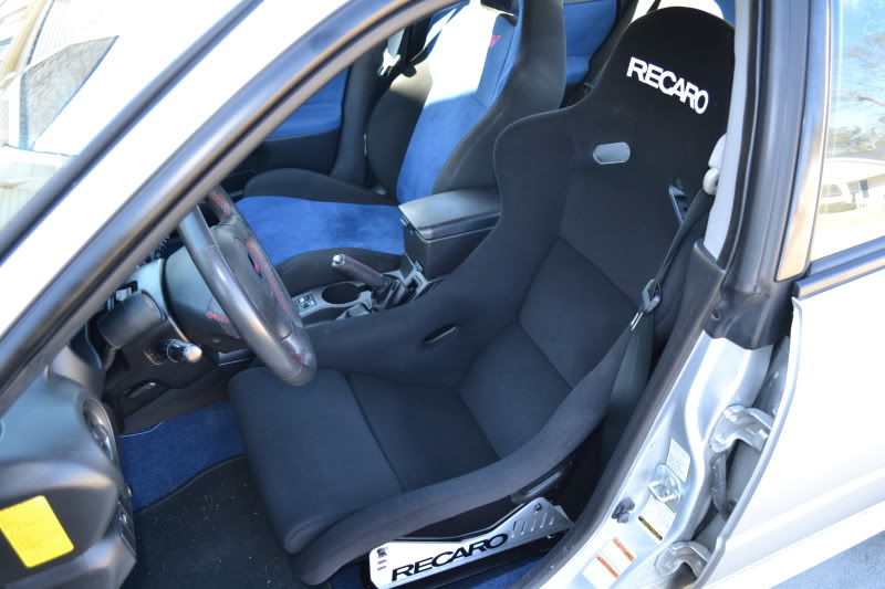

Nobody local carries Recaro in-house I used to own a PP so I know I can daily it. This is a pic of my [former] car:

I haven't been in a Profi, so I don't know if it'd be okay daily. I'm a smaller guy (5'7", 165 lbs, 31" waist) so I could probably get away with a Profi, but I don't want to make my car too much of a track car. It needs to be comfortable enough that I can still take it out for a night on the town without my imaginary girlfriend hating the ride. When I do the second seat, I'll be matching it to the driver seat so the more comfortable, the better.
But... if you wouldn't mind getting a quote for a PP and a Profi so I can see what the difference would be. That'd be awesome.
