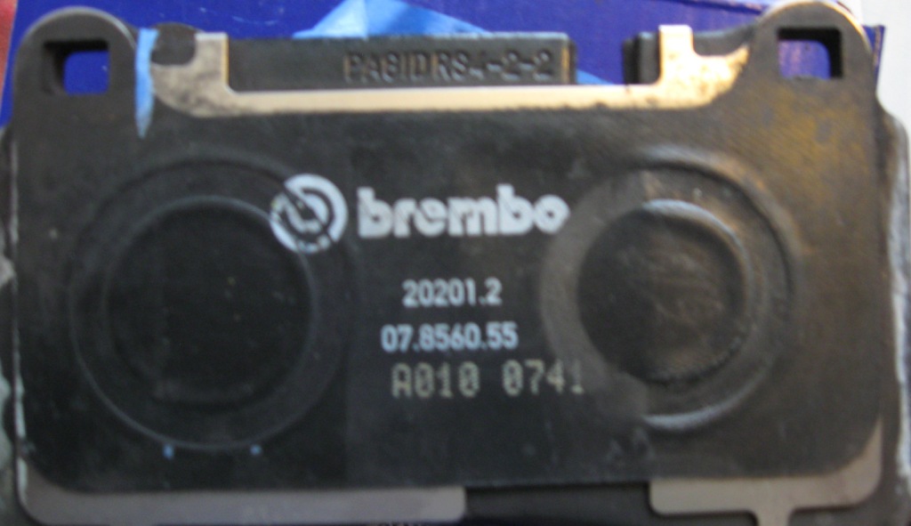

Can someone tell me who the manufacturer of Aston Martin's pads for the v8 vantage is.
By this I mean when you buy pads in a AM box and which have Aston Martin stamped on the pads - what is the name of the pad manufacturer on there as well?
If possible a picture would be appreciated

They're Brembo pads but I believe they were actually manufactured by Pagid. I saw a pic somewhere that showed that in the back of the pad.

Originally Posted by telum01
You posted while I was out taking the blurry photo
OEM front pad from a '07 Vantage:Brembo/Pagid RS4-2-2
No longer on the vehicle: replaced with Porterfield R4-S pads

Perfect if the Pagid RS4-2-2 are the oe pad. That's what I'd hoped and seen some pics of elsewhere - a nice pad material. Wanted to be sure it's oe spec as likely to mean less squeal!
Yes pagid definitely an oe manufacturer, but can't see them making pads which are branded as brembo?
The OEM Pagid pads are very dusty and can be noisy as well...that's why they have been replaced.
Use the "forum search" to find out more, as there are numerous threads on the subject.
