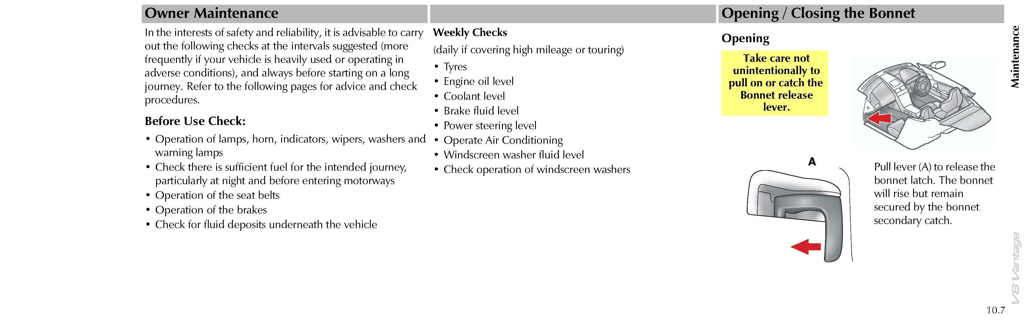

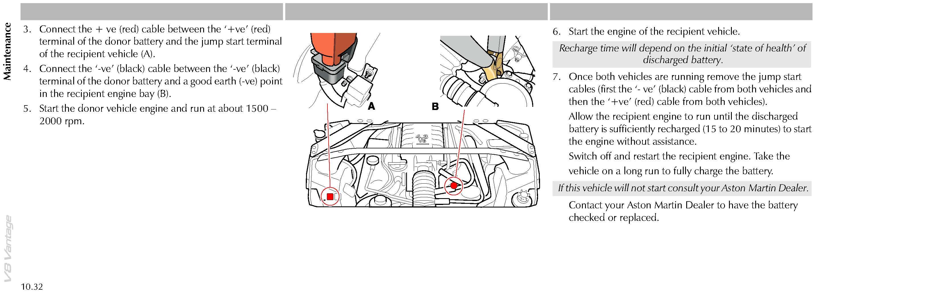

If the battery is original, its 8/9 years old by now and most probably won't hold a charge; a replacement would be a better solution. The "bonnet" release lever location is in the same place on a LHD vehicle.
You can try to get it going by just opening the hood and following the "jump starting" procedure.
