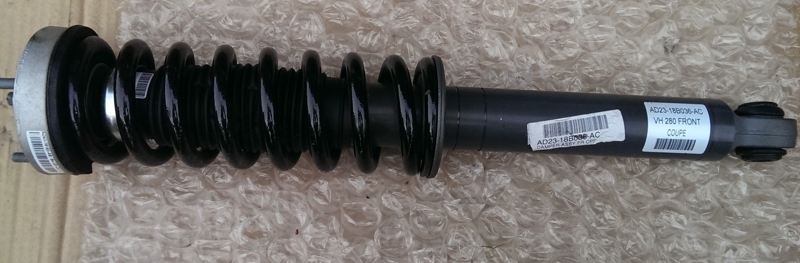

Your thread made me look at a pic of the shock absorber for the v12v.
I think it already has the grooves for the spring perch at a lower position, see below!

Glad my thread was helpful Wow that vantage v12 strut sure does look to have groves already there. Very interesting.......
