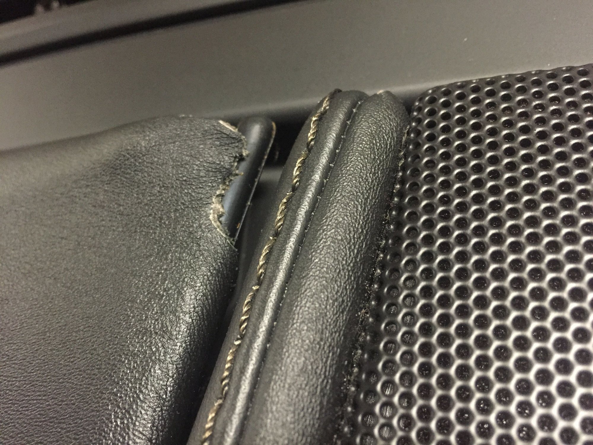

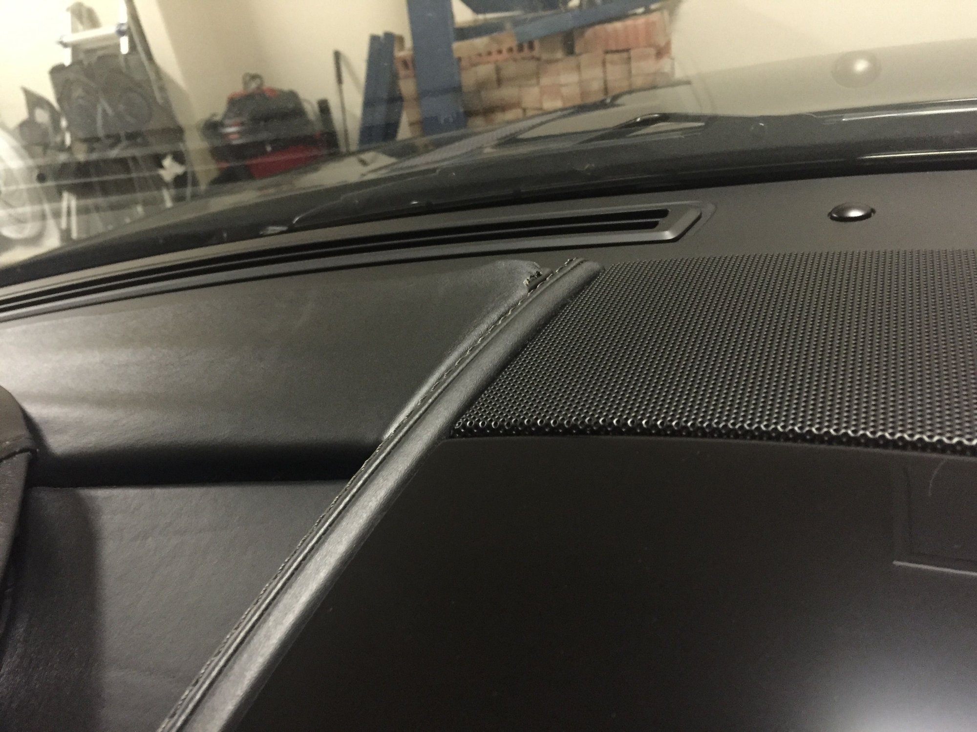

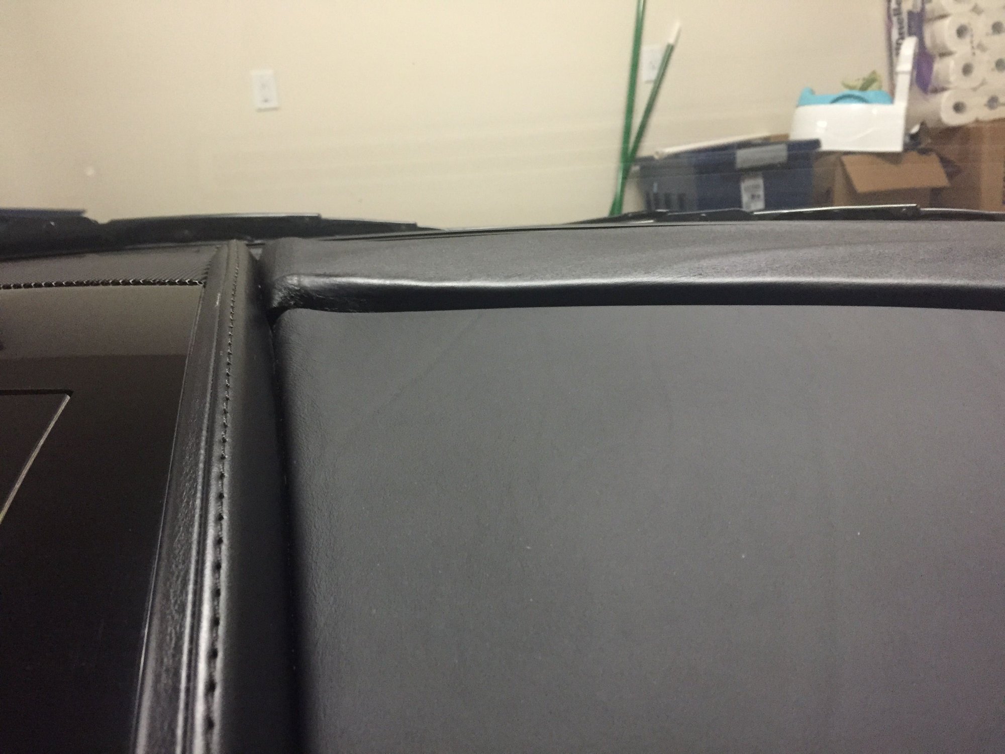

Hey guys,
I am new here and just recently purchased a 2007 AM V8V. I have this leather dash issue and was wondering if anyone new of good leather upholstery repair in the Austin Tx Area?
Also has anyone used the dash panels from v collection?
https://www.vcollection.com/products.../Interior_Trim
Thanks

As mentioned, it's an easy fix for a good auto upholstery shop.
The problem is that Aston used a glue on the earlier cars that doesn't withstand heat too well. So the glue softens and the leather come loose enough to contract.

Replacing the original leather with new 'matched' leather is going to be difficult - there is one company that supplies leather to AML. You can get the leather yourself through a third party, but unless you get the OEM leather, I'm not sure how good your chances will be of a perfect match.
Repairing the original leather is easy. They apply new glue (that can withstand the heat) and stretch the original leather back into place (which is how it is done at the factory). It's inexpensive and easy.
