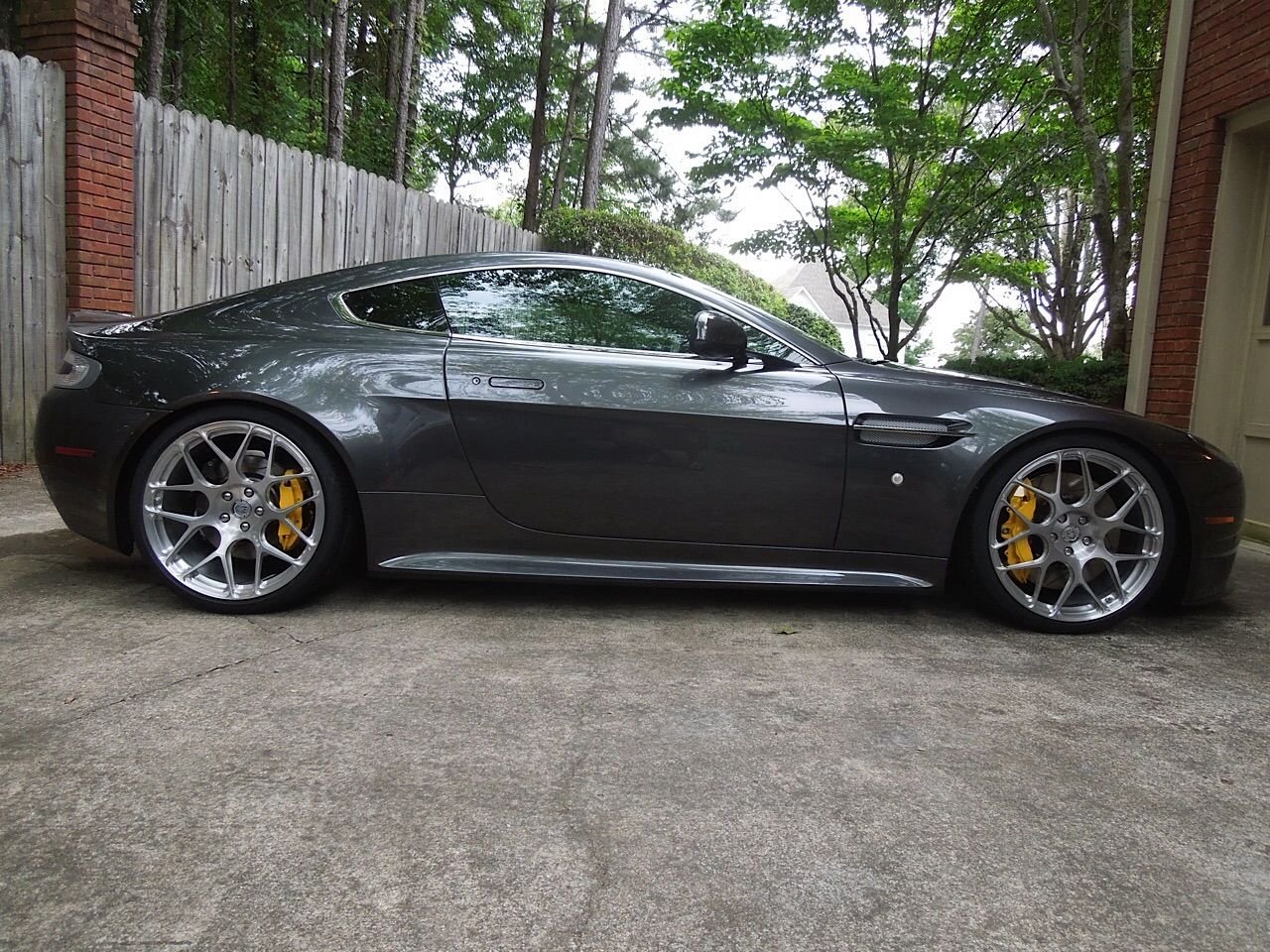

Here's what my car looks like with H&R springs, slightly larger tires (0.3" taller in front, 0.4" taller in rear), and custom wheels (same width and diameter as OEM 19" 7-spoke wheels, but with a more aggressive offset). The taller tires definitely help me get over speed bumps with less risk of scraping in the middle. Yes, I've noticed lol.
It doesn't take much to improve the stance on these cars.

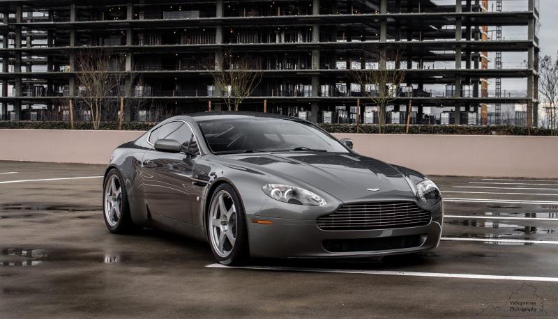

RSC lowering springs and wheel spacers with factory 5-spoke 19" wheels and stock Bridgestone Potenza RE050A tires:
