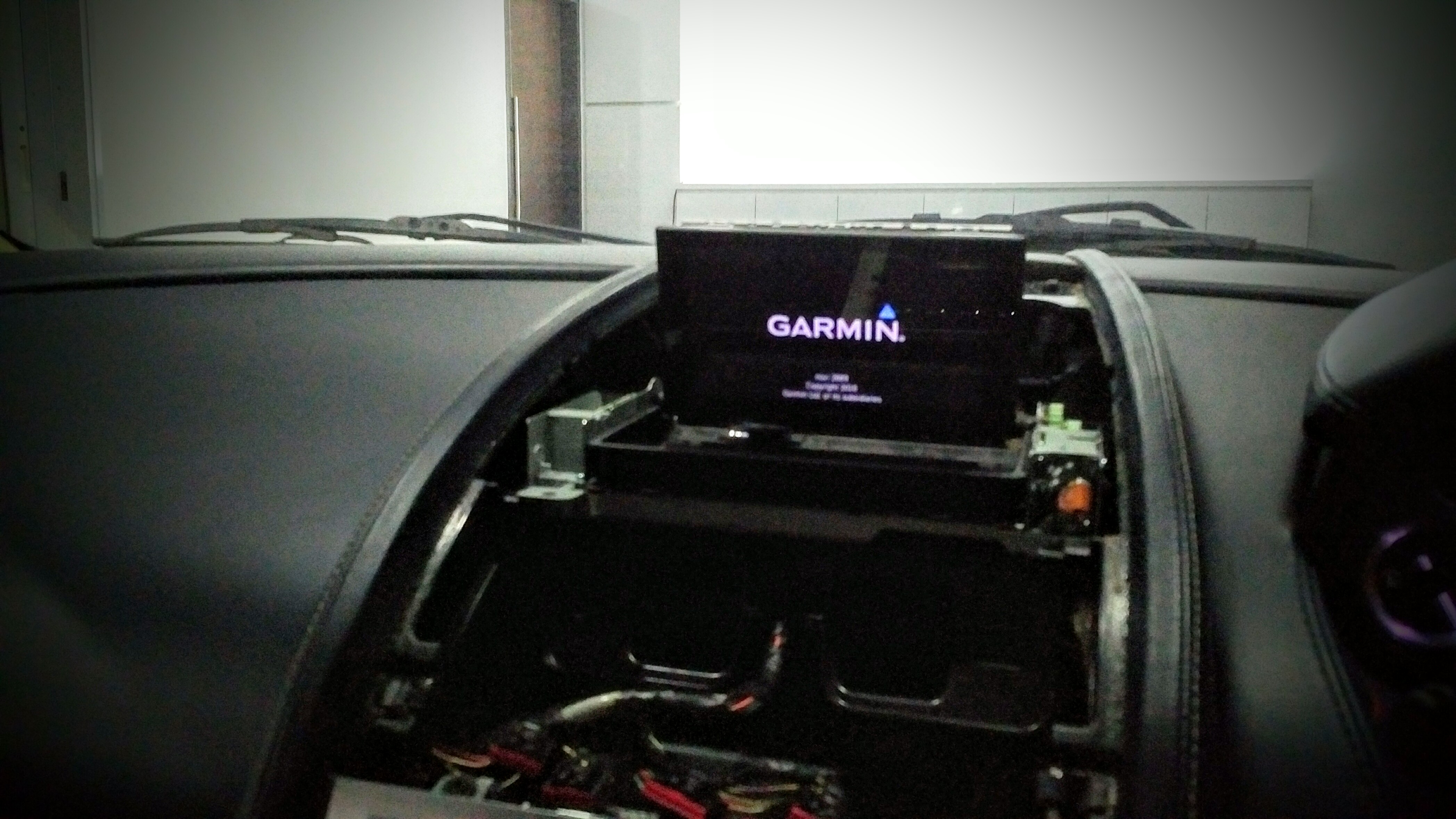

Teaser..

The hardest bit will be fitting a new bezel around the garmin to make it look neat. If ran tests on the Garmin last night and the Bluetooth function works great: the Garmin screen act as display for all you saved phonenumbers so you can speeddial, search, accept incoming calls etc. The speaker quality is excellent too.
I will power the unit with a switched 12V which I will take from the center console. To enable map-updates in future, I'll make the power-cable USB-ported which will allow me to do updates without taking the SD card out once it's all build in.

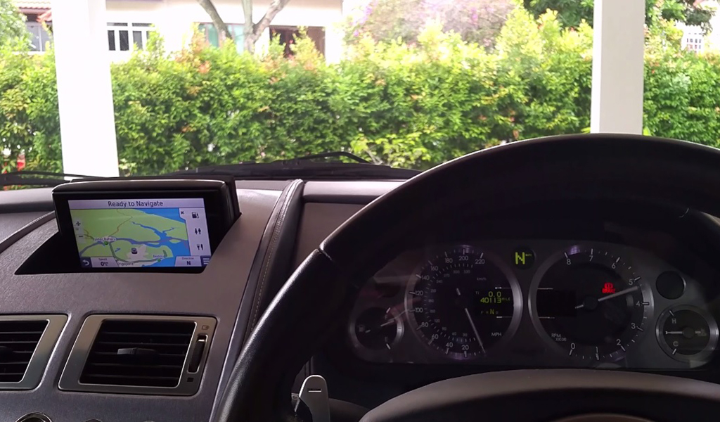

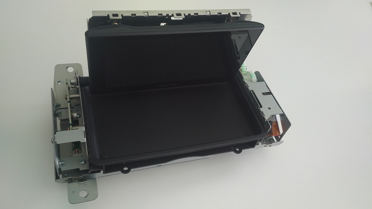

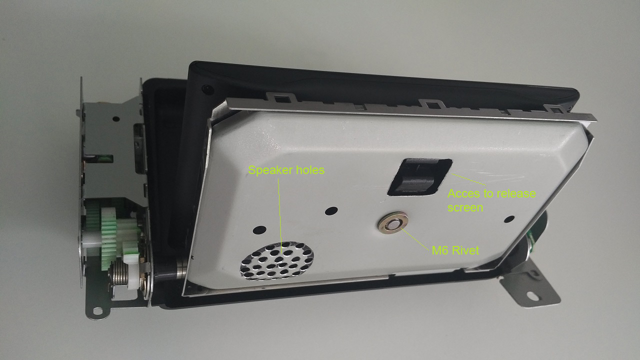

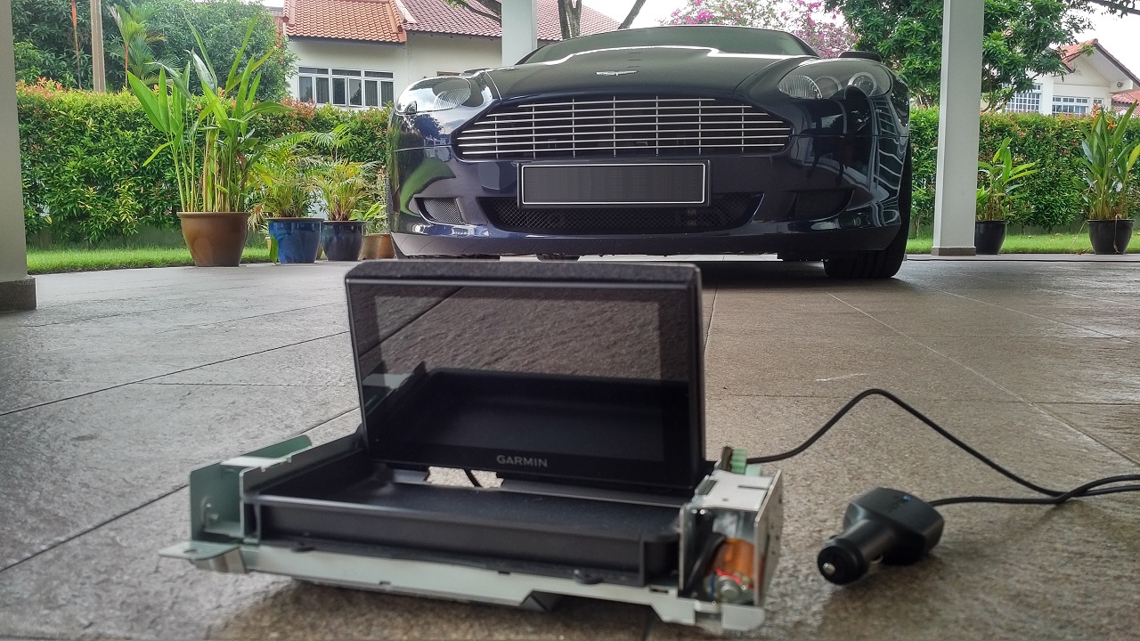

I finished the works over the weekend. pictures say it all.
- As with all my mods; its a fully reversible process;
- 12V is taken from the cigarette lighter. Upon starting the car the SatNav pops-up. On switch-off it disappears in the slope;
- I've finished the bezel with thick felt for now. Will ultimately make a full enclosure/bezel to give it a better appearance when opened.
The only con at this stage would be the fact that the screen pops-open at start-up of the car. Other then that I'm very happy with the result thus far.

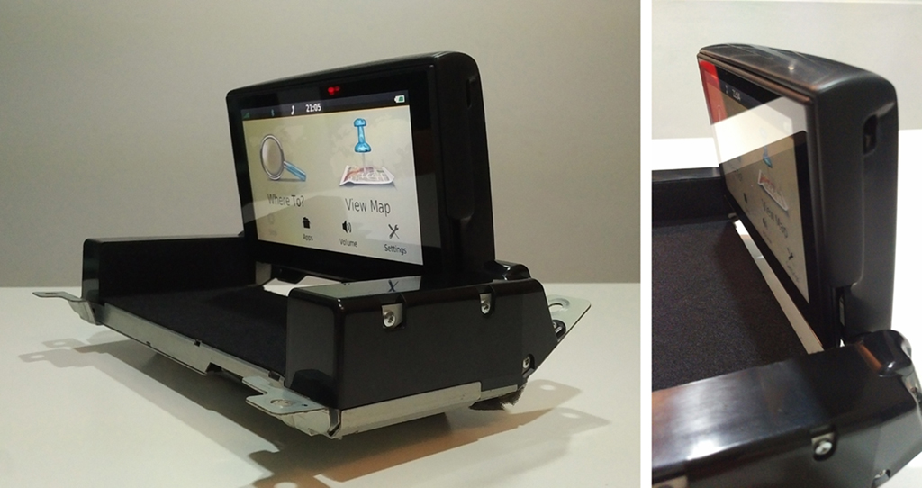

The finished product with the bezel now fully made to suit the interior better. A gloss-silver finish around the bezel edge did cross my mind but I decided to keep the satin look for it to blend better with the rest. Works like a charm!
