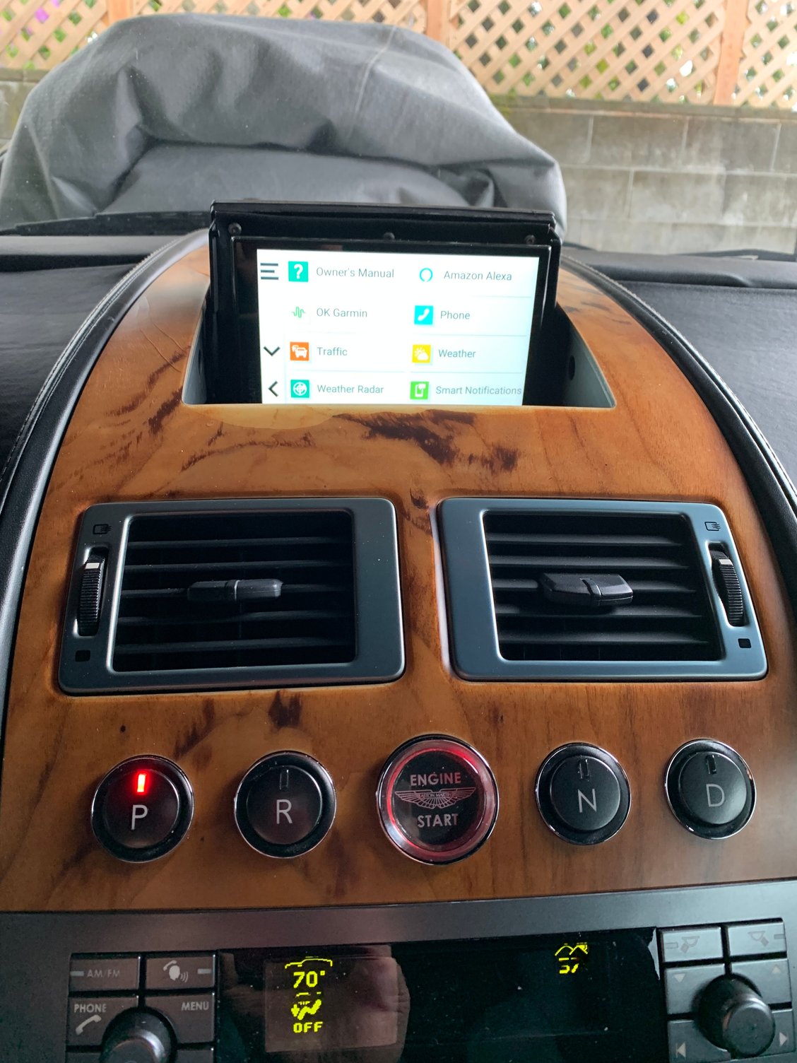

i replaced mine with Garmin Drivesmart 66. same mounting as sdekoning (i wish i had seen this post prior to conversion as i did not cut speaker holes, etc). reused factory bezels. I have it raise and lower with a button (also turns on/off Garmin)

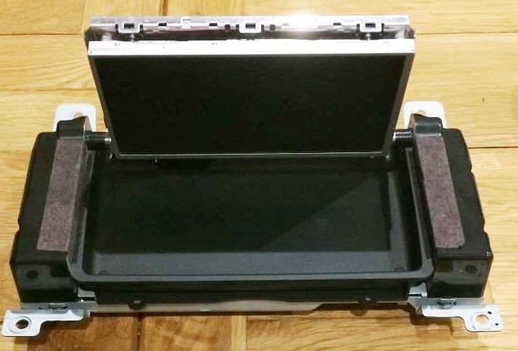

the Volvo screen metal surround is 3 9/16 x 6 3/32
i do like the wireless backup camera, touchscreen and voice control of the Garmin
Reply
Apr 25, 2024 | 09:51 AM
  #54
ragingfool35 those must be the dimensions of the opening for the screen. While useful, I was hoping to get measurements of the area behind that opening. I.e. what is the largest CarPlay/Android Auto housing that could be fit into the stock flip-up display mechanism.
Reply
Apr 26, 2024 | 09:52 PM
  #55
the glass screen is encased in metal. this then bolts onto the frame. the dimensions above are for that.
its a 7 minute job to pop the waterfall out and unbolt the 4 screws to remove this if you want to measure everything
Reply
Apr 28, 2024 | 11:15 AM
  #56
Thanks! The "7 minute job" comment is more valuable than any dimensions!

I started my “cheapskate” conversion to the Garmin Drivesmart 66 before stumbling across this thread. the end result looks like this:
I pulled the old display unit entirely and fashioned a leather liner for the exposed area. It’s not beautiful but it’s not any uglier than the original hunk of plastic from the factory. The unit easily flips up and down manually with no issues. I’ll have to decide whether I’d rather hollow out the original unit and stick the Garmin in it. One advantage of the current set up is I can dismount the Garmin and carry it with me. Also I have easy access to the buttons and parts on the rear. Anyway, one more way to skin the cat.
