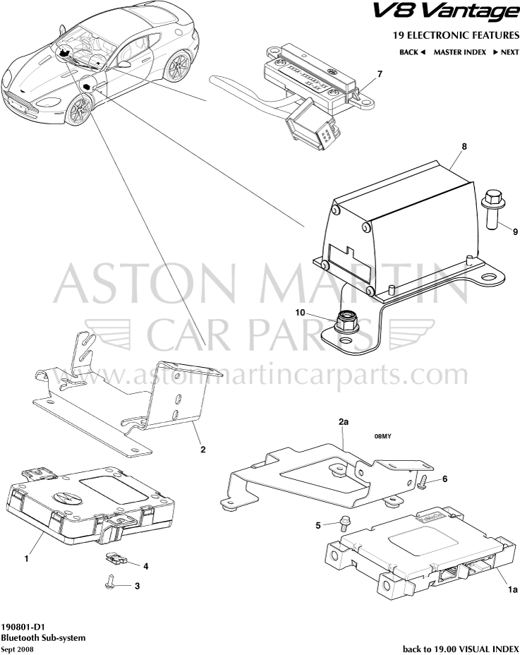

I think I have found the part on Astonmartincarparts.com. It shows a "Bluetooth Switcher Kit" part number 7G43-37-11054. Here's a link that may or may not work, not sure if you have to be logged in:
http://www.astonmartincarparts.com/diagram/astonmartin/v8-vantage/electronic-features/bluetooth-subsystem/156-815-25044.html
Does anyone know if this is the correct part? Here's the diagram, part #8

600 dollars US plus VAT. That a bit rich

The part I referenced is $181.63 US exc VAT according to the website. Is this a reasonable price?

Any part for the Aston for less than $200 dollars is reasonable.

This link pretty much confirms it.
https://www.astonmartintechinfo.com/...uetth_RHLH.asp
It has the right part number.

Can anyone confirm that this is in fact the correct part that needs to be replaced?
It is the right part

Thanks! I priced the part out at my Canadian dealer, $420! I have ordered it from Aston Martin Parts. Even after the shipping and exchange I should still save over $100 from what the local dealer wants.

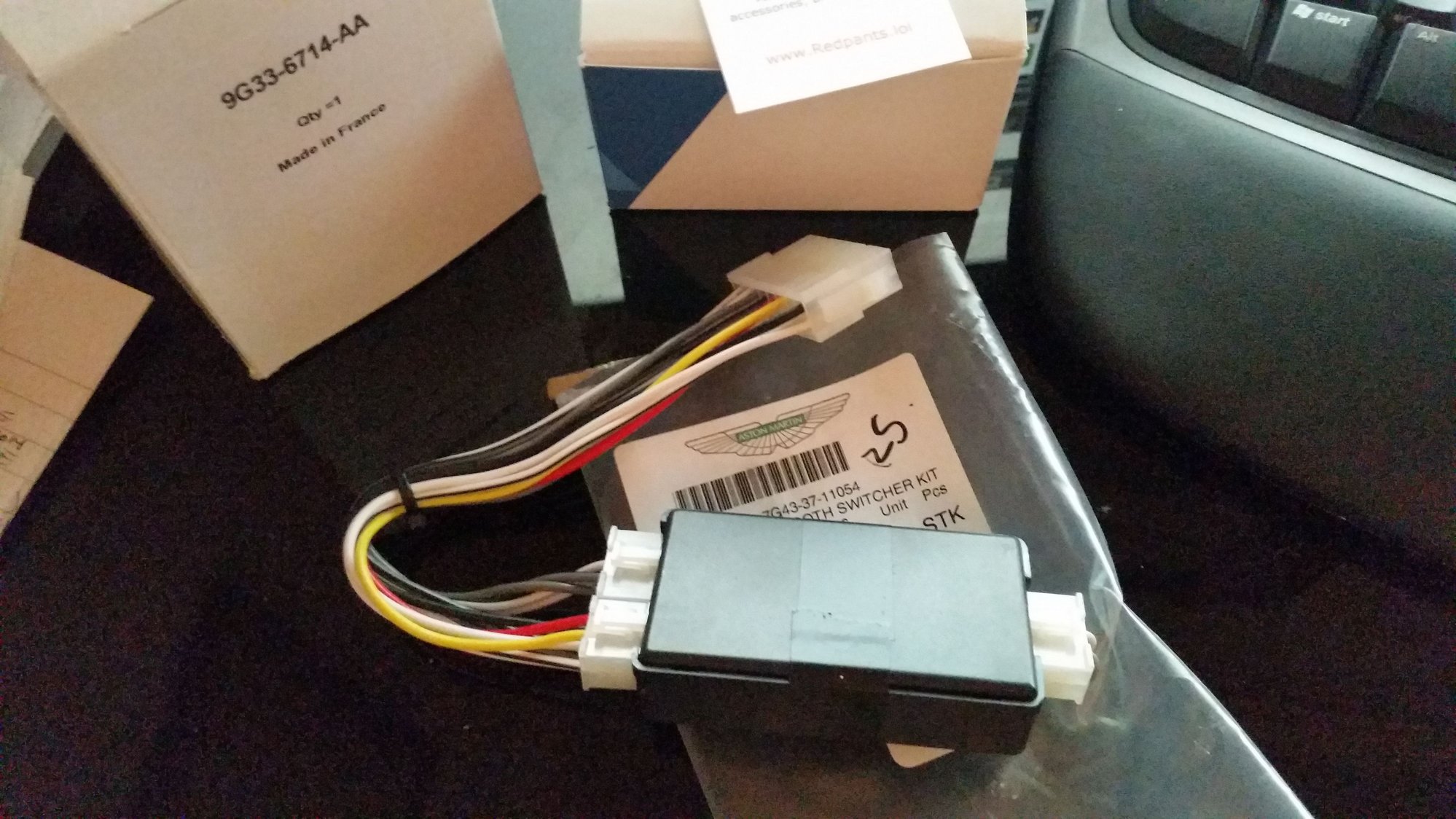

Switch kit arrived today. I'll install it tomorrow and do a write up. Looks completely different than the drawing in the parts diagram.

That's what the one I got looks like. You don't have to remove the old one if you don't want to, just unplug it and plug in the new one. There's plenty of room for both of them in there, and the new one won't mount the same way anyway.

Mine just shipped. I'm relieved to see that it is the revised part so hopefully the problem is permanently resolved.
