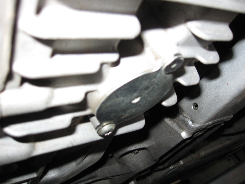

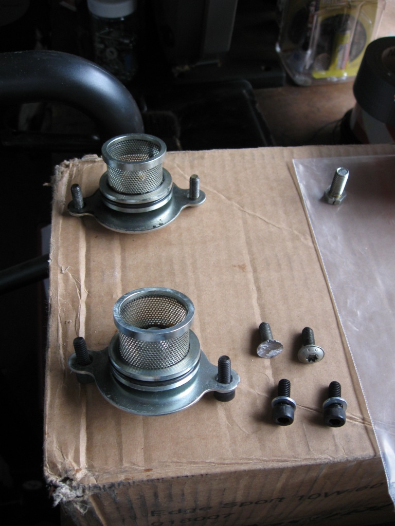

Originally Posted by 911MTB
When you changed the oil did you clean the two oil filter screen things located under the two little covers held on with the two small hex bolts? The one cover is visible at the very top of your first picture.
I had the o rings in hand but I could only break one of the four bolts loose. I put as much pressure on the bolts as I could but was afraid to apply more pressure for fear of damaging the bolt head or breaking off the bolts.
In retrospect I should have applied some heat to the bolts as that may have helped. The next time I have the car on the lift, I may drain the oil into a clean receptacle and then try once again to remove the bolts.

Replacement Screen Fasteners
Nice write up and pictures on your recent Vantage project!
I had a similar problem with the screen fasteners when I did my first oil change some years ago. I had difficulty removing only one-stripped the head; I used my small angle grinder to remove some of the head material and relieve the stress on the fastener; it then came loose easily using a cold chisel to rotate it.
A trip to my local hardware store for replacement metric Allen head cap screws and problem solved!
No more fear of stripping the head when removing-just don't overtighten .
