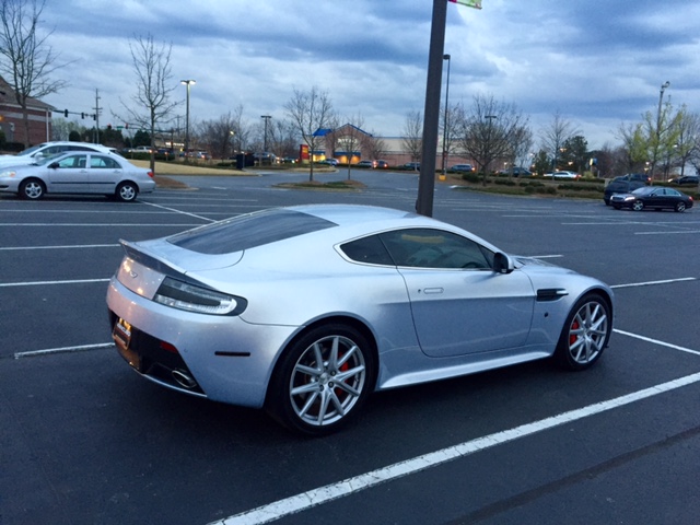

I have been a long-time Porsche guy, but I just bough a 2011 AMV8VS with 15k miles on it, and am loving it so far. There are several little bits to fix/ perfect, but so far I love this car more than my Porsche 997S by a loooong shot! It is equipped with the SportShift II transmission, which I quite enjoy.
Here's a pic, it's lightening silver over obsidian black, with all the options: premium stereo, Nav, Sat Radio, etc.

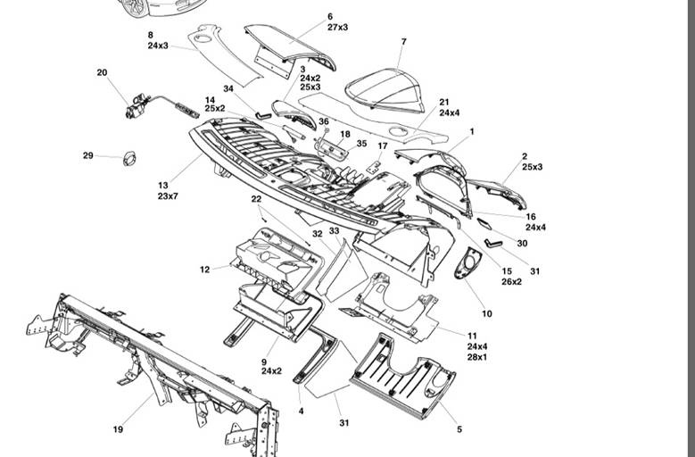

My local dealership quoted $3,500 (parts and labor) to replace these 4 leather dash panels:
1. $410.33, item # 8 in below picture, in stock
2. $990.77, not pictured below, 6-8 weeks lead time
3. $343.08, item # 3 in below picture, 6-8 weeks lead time
4. $410.33, item # 21 in below picture, in stock
The $990.70 part is the stitched leather that surrounds the ski slope, which is peeling off at the front uppermost area on both sides, and it's actually one large unit the wraps around underneath.

Ouch.
I ordered part #8 from HVM Aston in Europe for half that price and installed myself. It took 3-4 weeks, but the leather matched perfectly.
The removal and install took me less than an hour.
