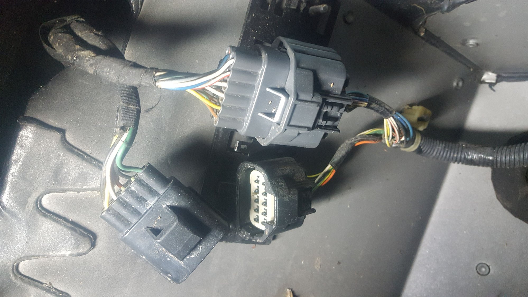

OK Problem is fixed
On passenger side wheel well area there are 2 plugs one of them was not completely pushed in, so once I did both error message went away. Parking sensors are beeping again, I don't hear chirps on locking and unlocking the car but not sure if AM needs to reset that.

Had the exact same problem and the culprit were the 2 plugs in the well, the clip holding them together were missing.

Hi,
Where exactly are these plugs located and what do they look like please?

Originally Posted by Organeer
Hi,
Once you remove passenger wheel and wheel well, just stick your head in there, look at roof say like 11 o'clock position. You will see I vaguely remember that there are 2 reasonable size plugs , with multiple wiring harness, they are black like many other plugs in our car. They go in to each other pretty tight.
Hi,
You need to remove the inner fender, right behind it to you left. You cant miss it. The pic are mine, there is supposed to be a red clip holding the plugs together mine were gone

So what did you do about it?
I would probably use zip tie on both side of that plug so they stay together
