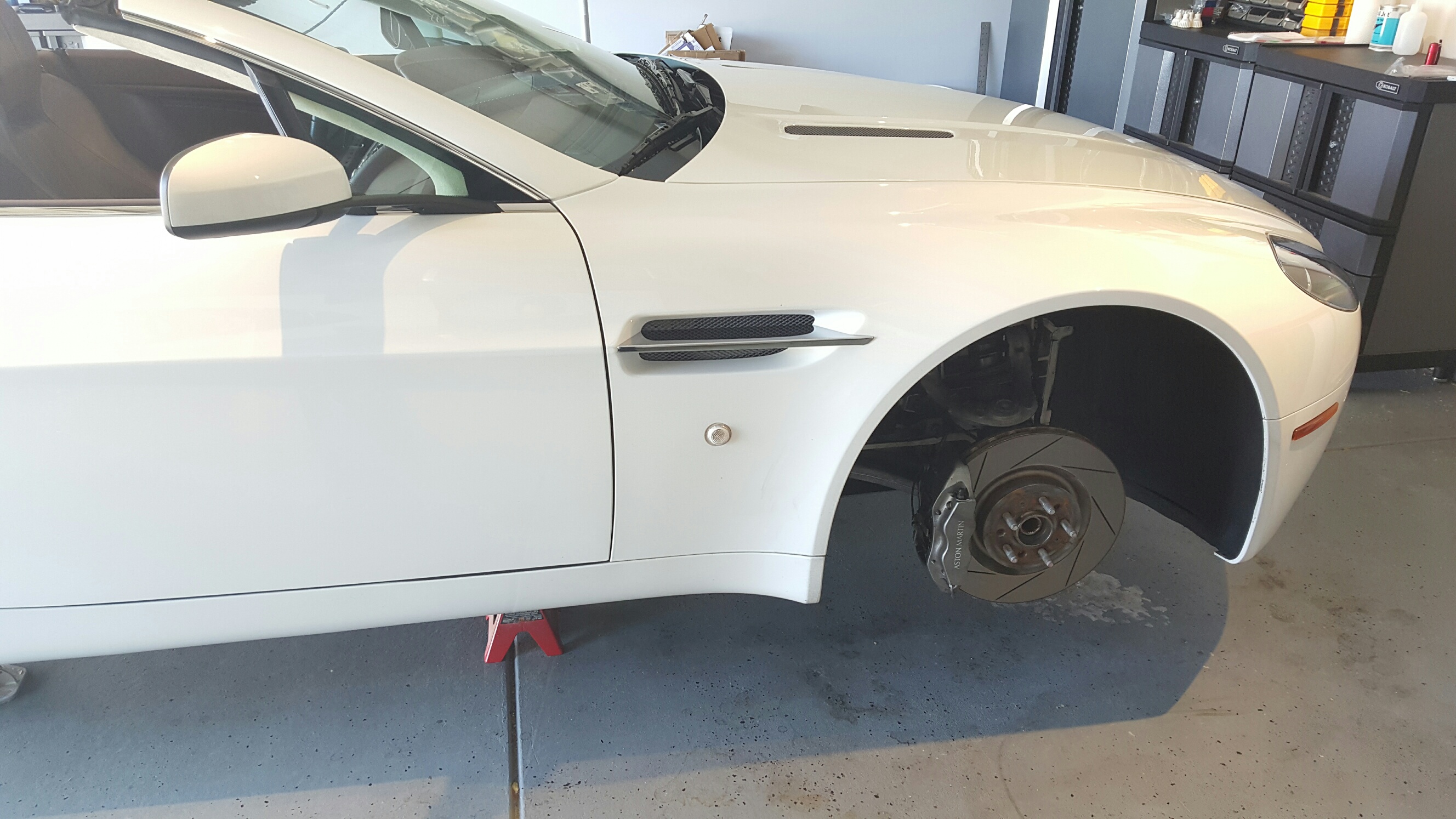

I just swapped all 4 corners two weeks ago with the Porterfields. We cleaned the crud off of the pins with some brake clean, and used the Auto Zone packets of anti-squeak on the back of the pads.
I've had no squeaking or squeal other than the first two or three applications as I was bedding them in.
Other than breaking two of the clips on the wear sensors, one of the easiest brake jobs I've done.
