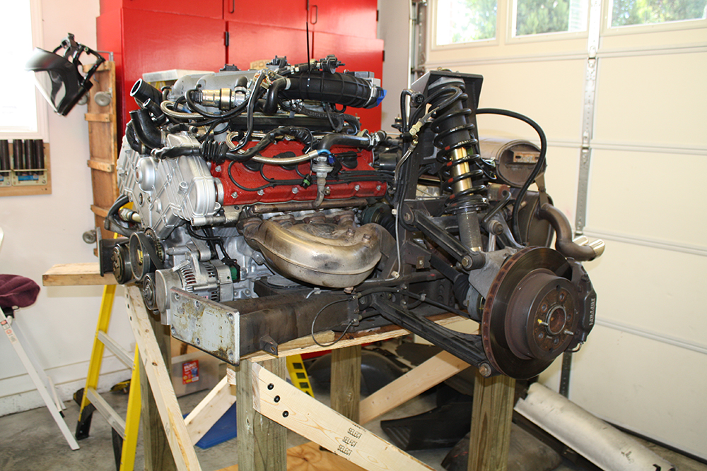

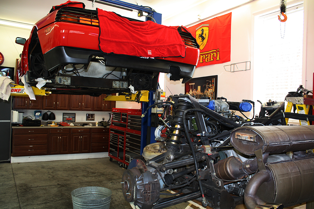

Wow!! I have pulled a Ferrari 348 engine to replace the timing belt but this may be just as difficult a job as that, if not worse. Knowing the engine has to be pulled to do the timing belt, at least a 348 engine was designed to be removed with the suspension intact. Once I had the fluids drained, we had the engine sitting on the table in three hours.

To save all that labor cost, I would still replace the timing cover seal myself with the my son's help. We would have to make the engine support and the bottom cradle could be supported with a tall transmission jack while it was being unbolted. It would be doable but I could see easily exceeding the 20 hours, especially as I would have to clean everything that came apart before it was bolted back on.
