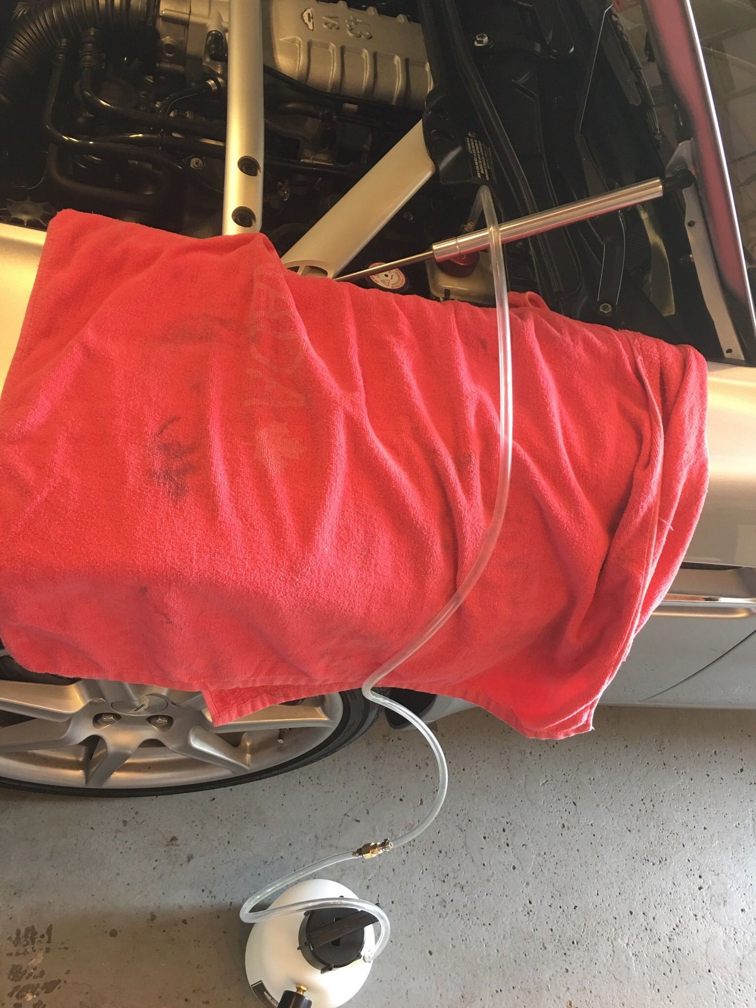

Did this last week. Couple of items of note. I only used 3 bottles (500ml). I was flushing all brake lines and clutch. 9 nipples in total. Just use the motiv to create pressure on the fluid reservoir 10-15lbs. Too messy to pump fluid thru it. Just refill reservoir after each nipple. Also reduces chance of getting fluid on painted. fender or anywhere else.
My old fluid came out clear. Must've been changed but I don't have the paperwork. No diff on clutch operation but the more I drive the car the better it drives. but that might be in my head.
Protecting fender. Pressurizing brake fluid reservoir
10-15lbs
Old fluid
New fluid
Catch jar
Old fluid
