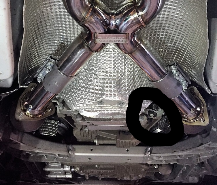

Very simple process basically the same as bleeding the brakes.
I use a Motiv pressure bleeder. which is attached to the master cylinder, though the old pump and bleed 2 person operation or vacuum bleeding would also work
The bleeding screw is a 9mm and can be found on the right hand side of the bell housing as shown
there is a 14 mm base nut , that is on the proximal side of the bracket to the bleeder, that should be used when loosening the bleeder to avoid torqueing the line.
Remove the dust cap
Open the valve with a suitable clear line attached and flush until nice clear fluid comes out.
Tighten bleeder
reapply dust cap
