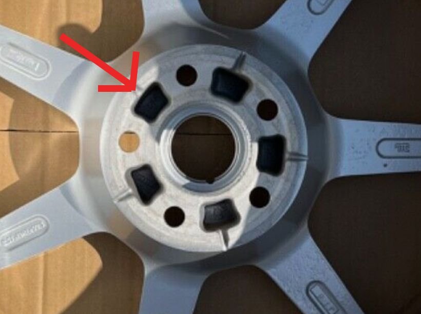

Hey guys,
Just had some custom spacers made to these specs. There are holes in the back of the OEM wheels but they **JUST** don't allow the original hub bolts to slide into them. Did you guys end up shaving down the original bolts (I don't really want to do that)?
I'm thinking of enlarging the existing holes (where the red arrow is in attached pic). Have any of you done this and if so how did you do it??

See https://www.6speedonline.com/forums/...3mm-setup.html
Pretty sure I wouldn't try drilling out my wheels like that though.

I'm down to give it a try. Any ideas on the best way? Dremel?
The guy in that thread drilled it out but he had a proper drill press
