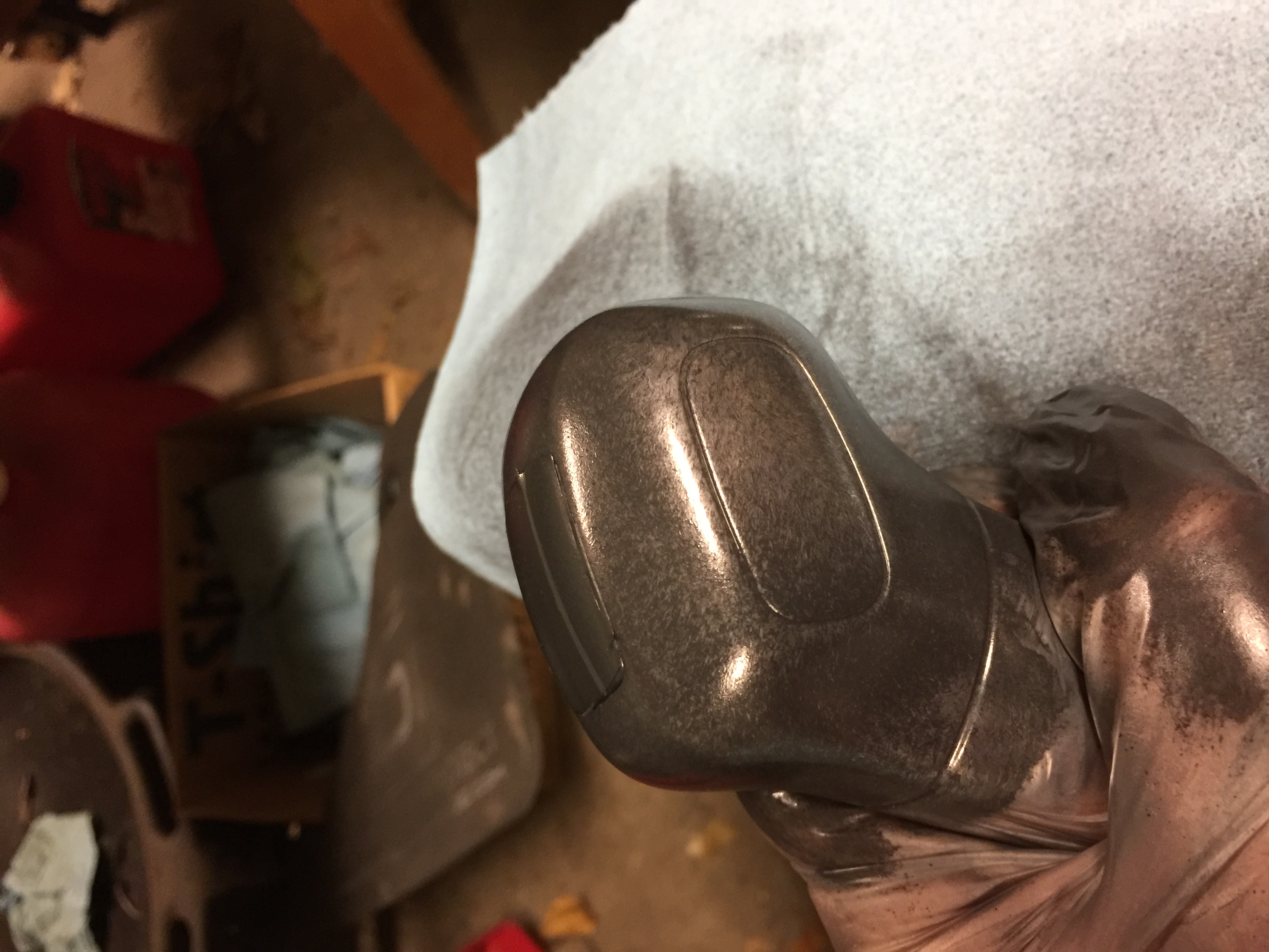

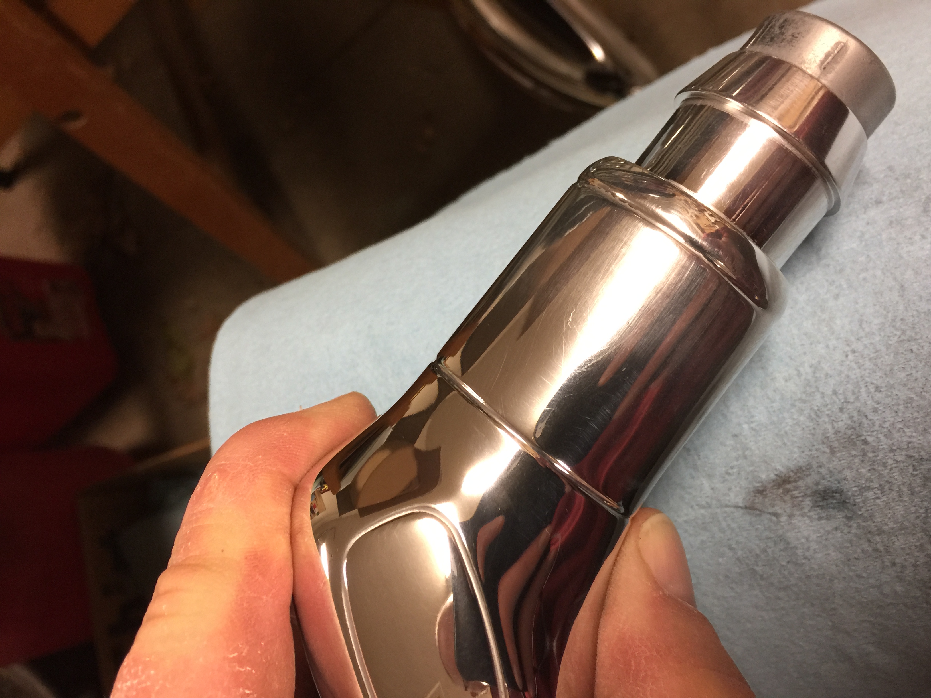

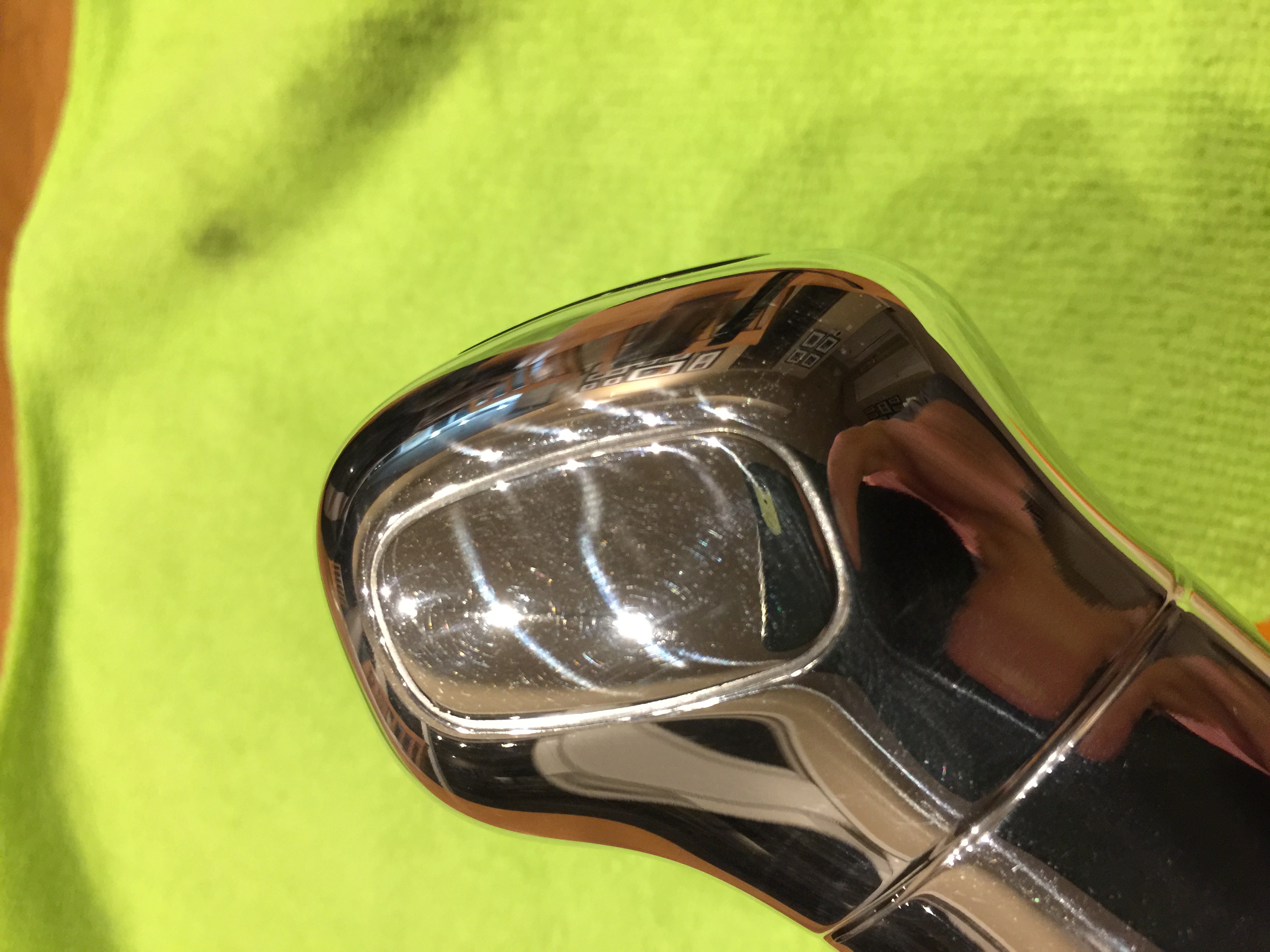

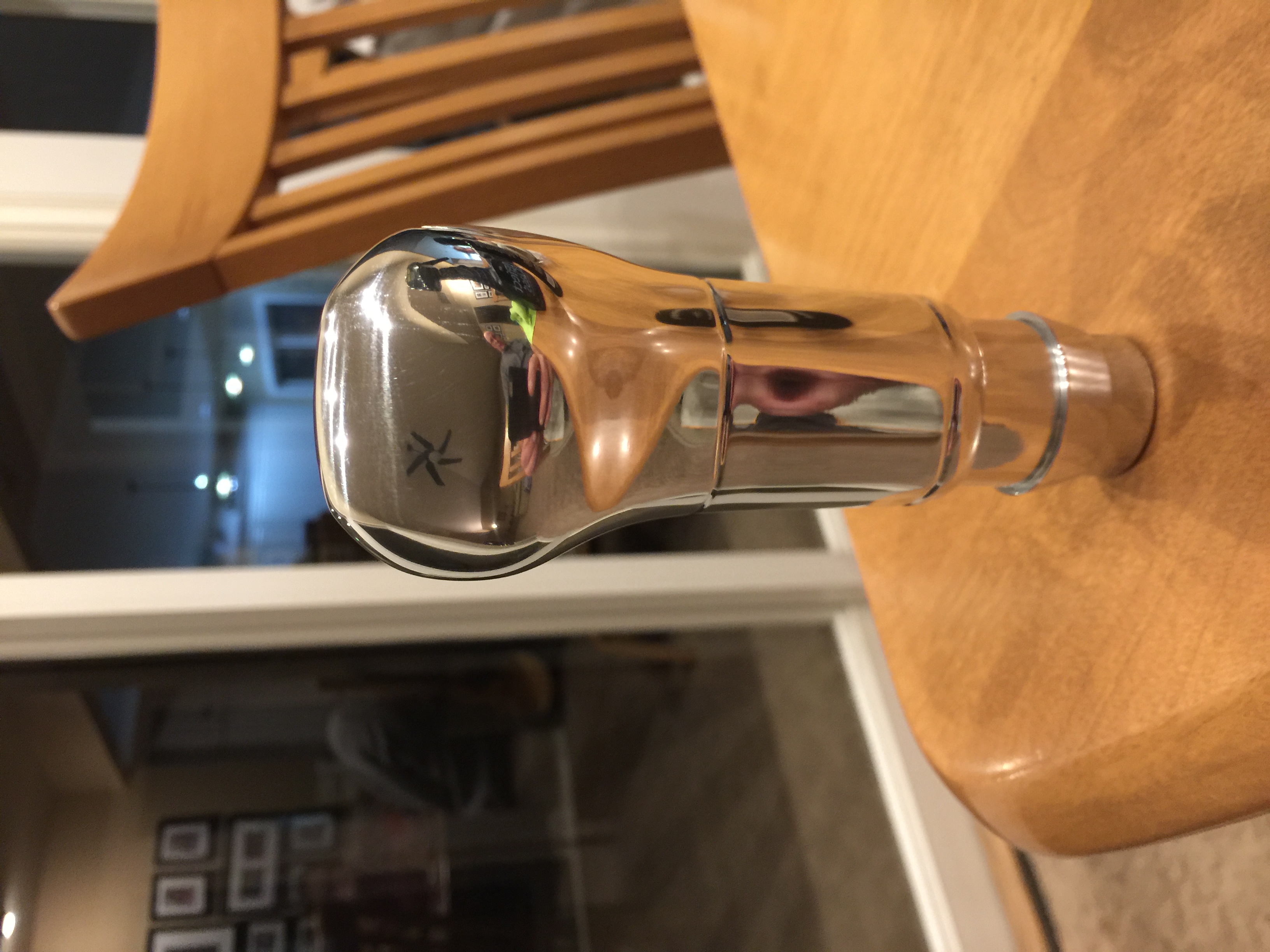

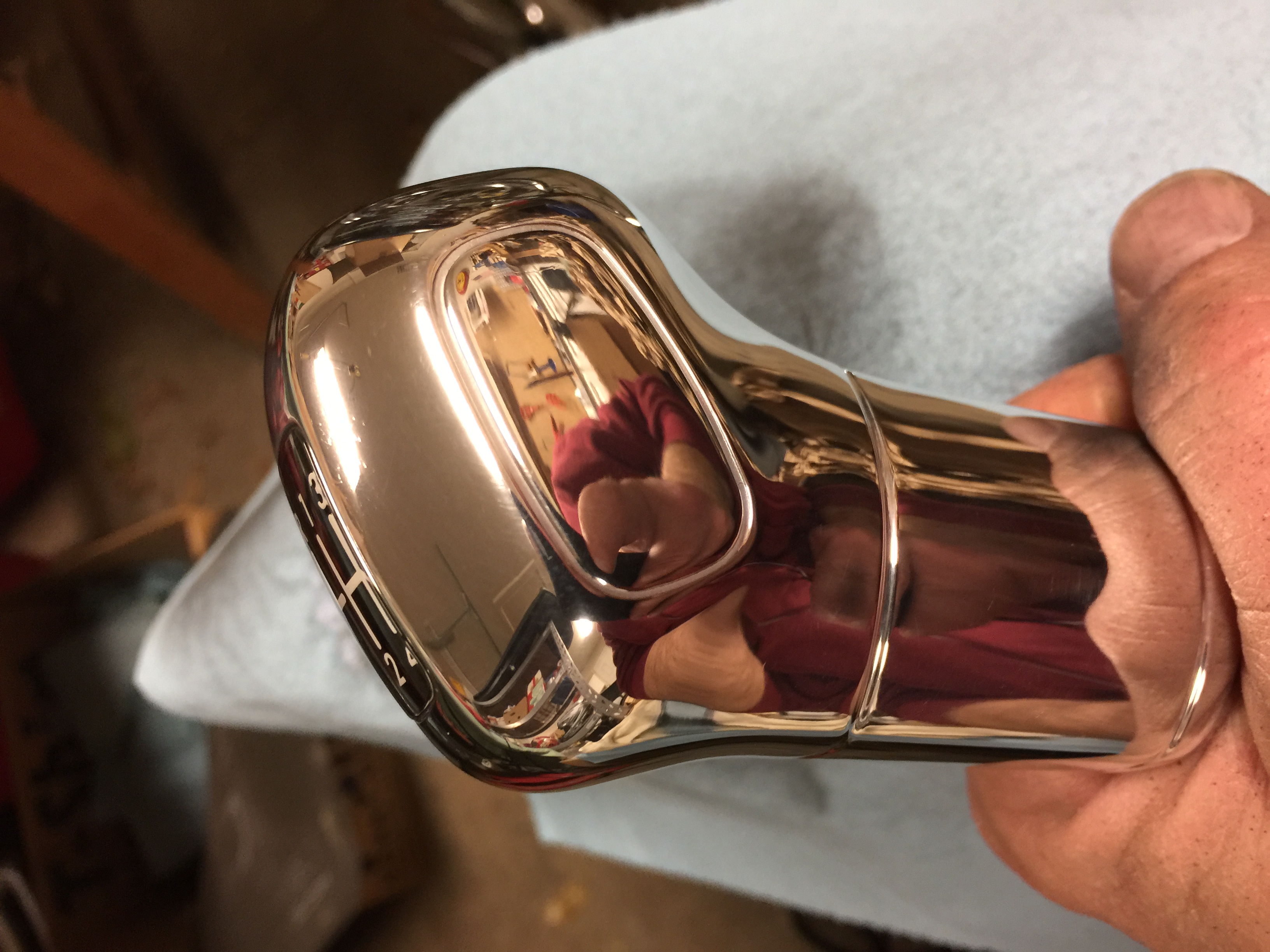

DBS Shifter

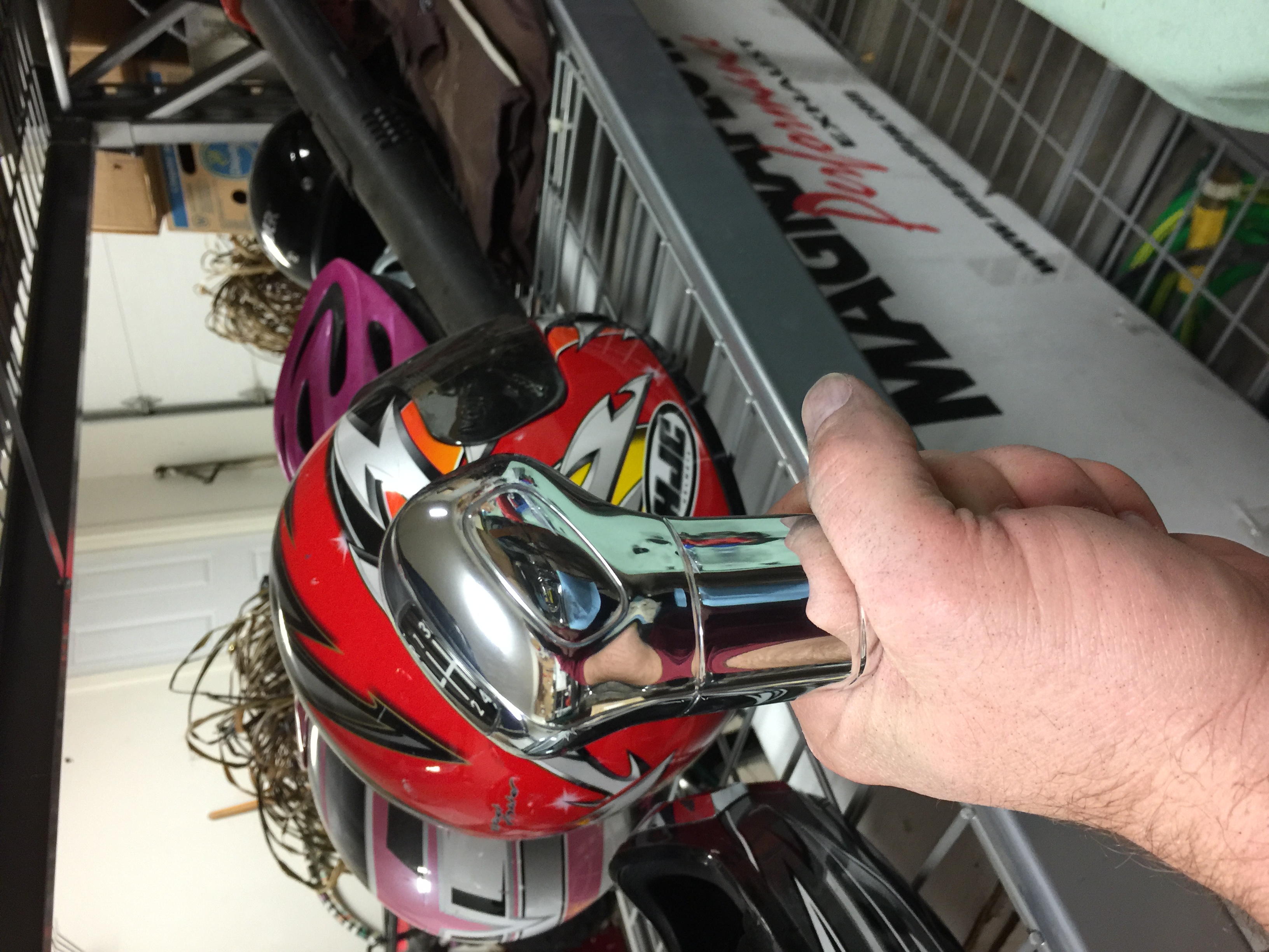

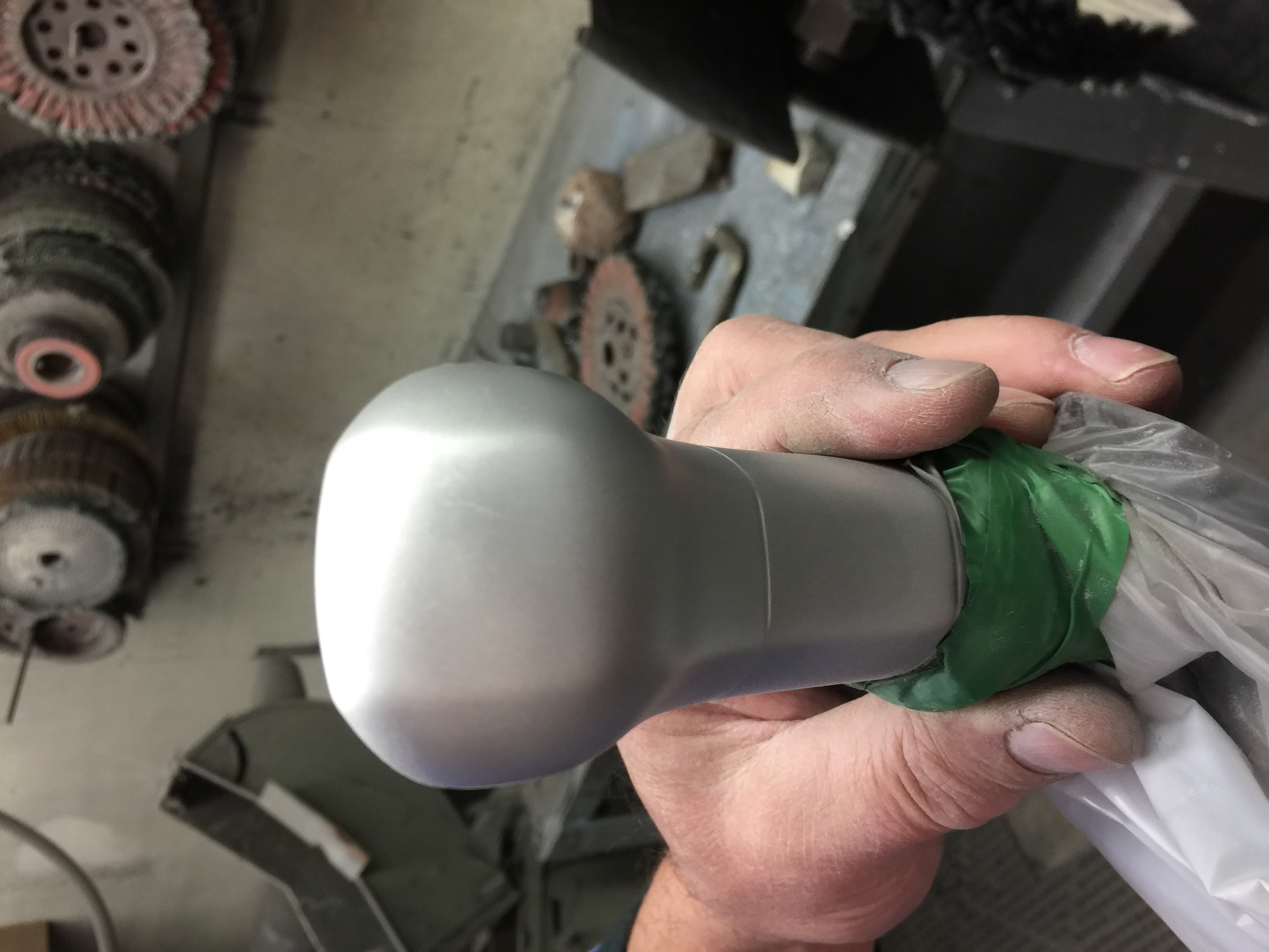

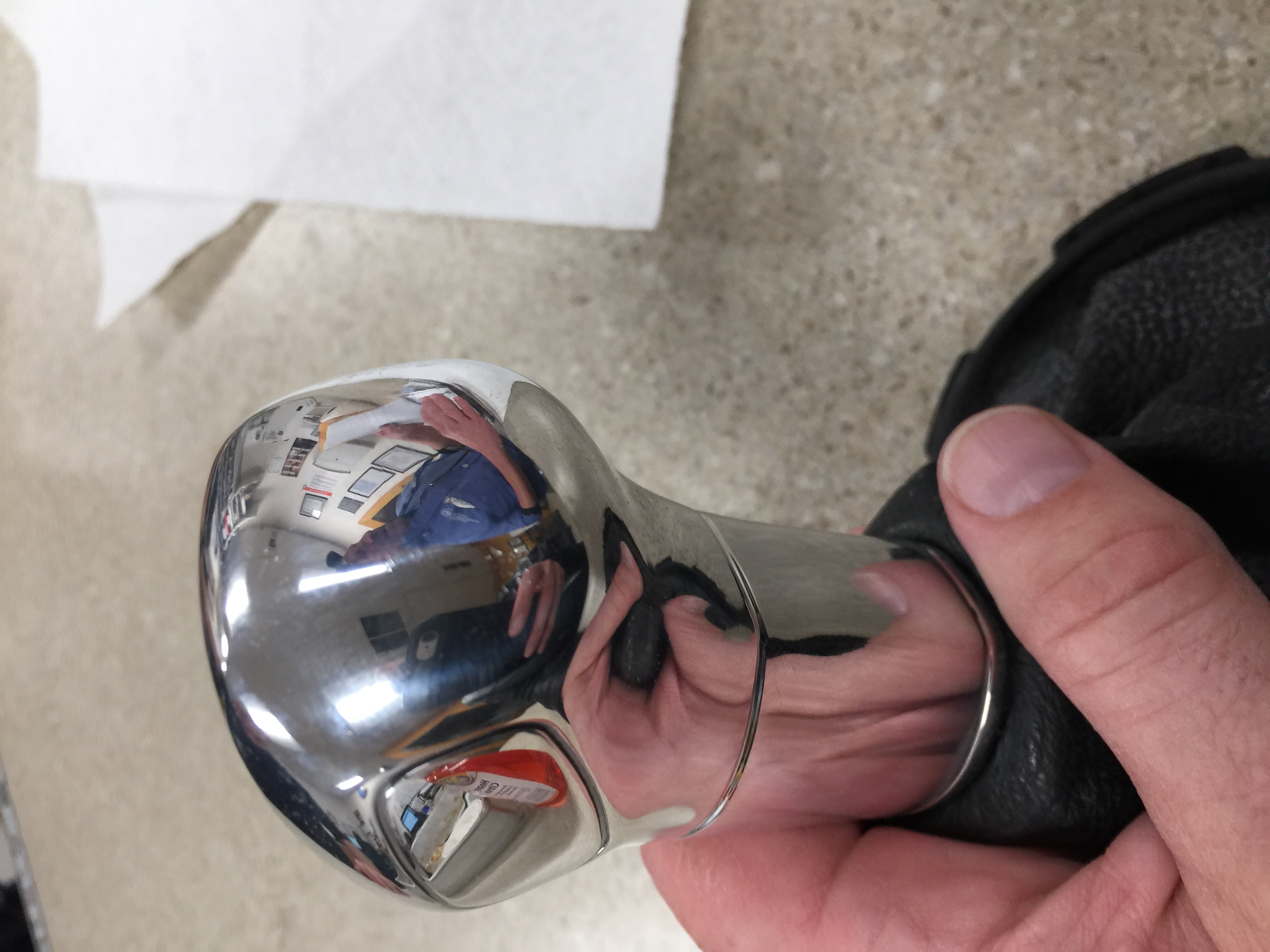

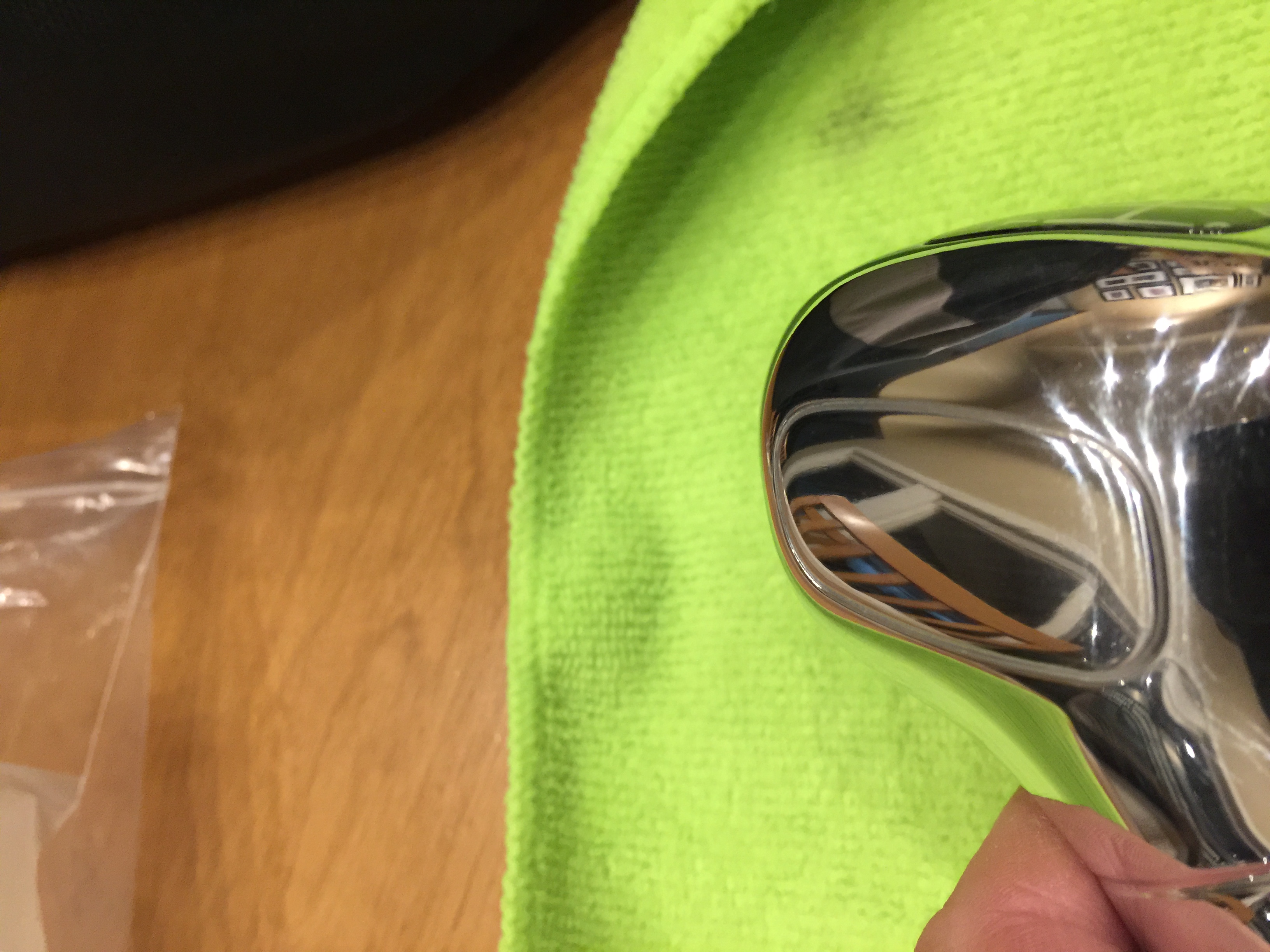

Bought a DBS Shift **** from Speedracer800 when I met him during my 700 mile road trip. He had 1 used shifter that was pretty scuffed up, but being the resourceful DIY'er that I am, I decided to take on the challenge and bought it from him.
Got it home and eventually took it to a friend's shop where we blasted the shift **** to get the lacquered finish off of it. This turned it a matte grey color. From there we began to polish it using several different polishing wheels that he has. (His shop is a plating/polishing shop). I was on a time crunch so I left the shifter and one of his guys dropped it off to my friend who is a renowned Master Detailer. The plan was/is to put several coats of Ceramic Pro 9H on it to protect it and the finish.
Well, that's where the curveball comes in.....sometime between dropping it off and delivering it (a 2hr timespan), the crystal came in contact with the ground and a couple fine scratches were introduced. Needless to say, I was SICK! Thinking it was likely a mineral crystal, I took it to my local jeweler and they worked their magic on it. Good as new!
Got it back yesterday. It took me a while to find it, but I located some Flitz polishing liquid and spent about 90 minutes hand polishing it tonight. One more step to go, but overall very satisfied with the results so far as the shifter was pretty banged up originally probably due to jewelry. The pics should be in order of this story.
Jim

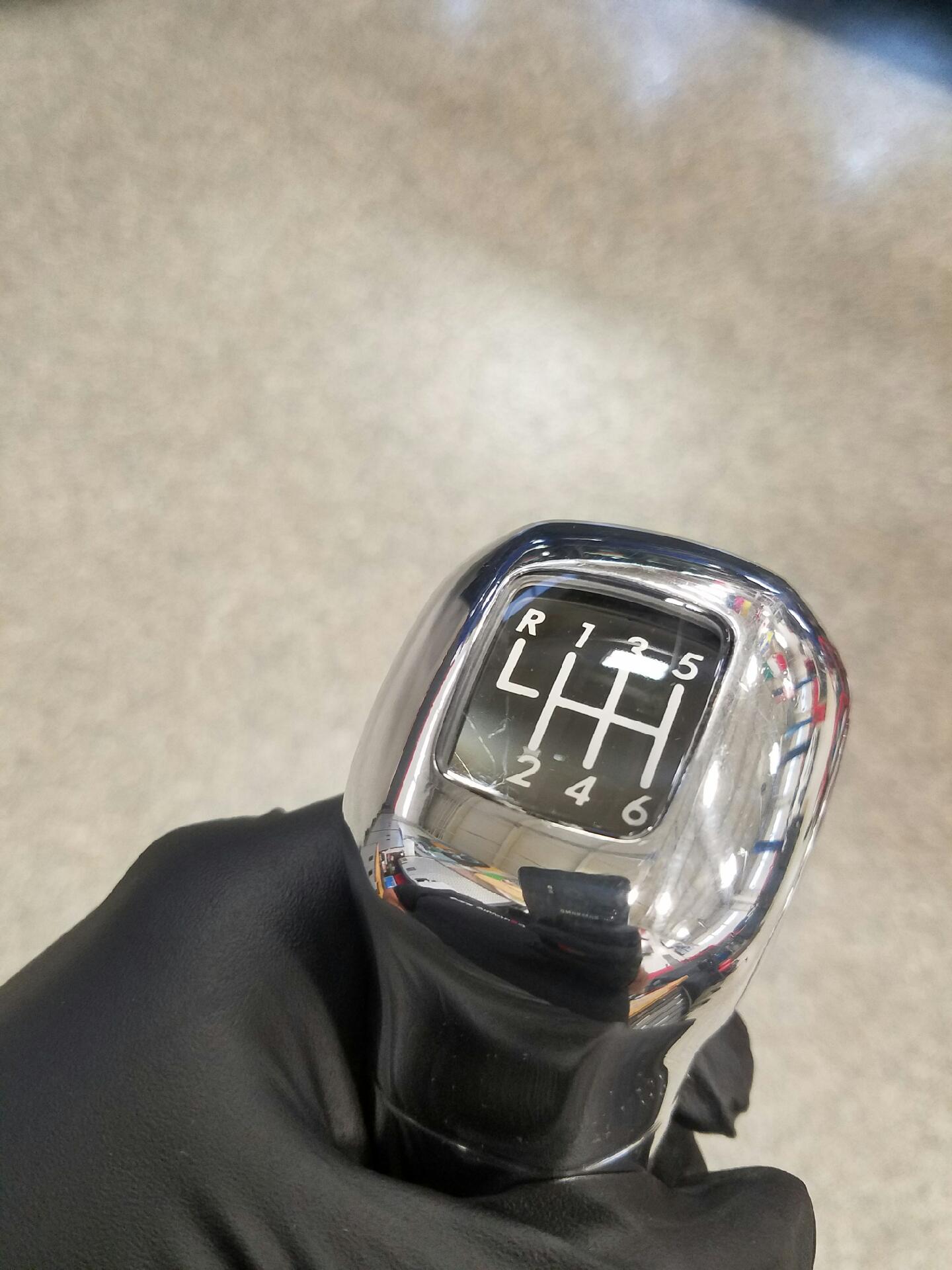

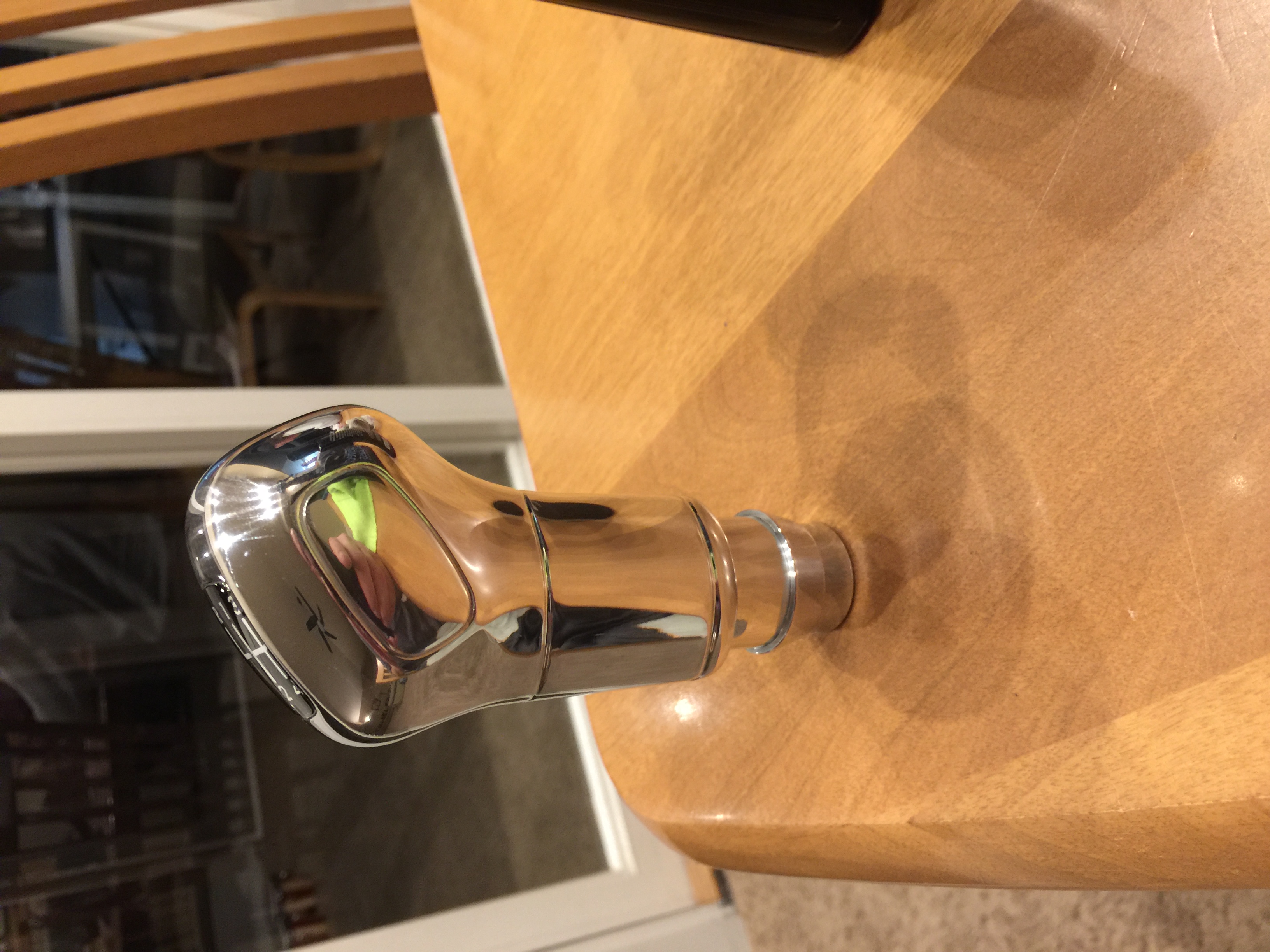

Spent some time on the shifter yesterday. Got out my 3" random orbital with a new microfiber pad and some ultra fine polish. Getting it really close to a mirrored finish now! Going to take another time or two to get it perfect, then I'll coat it and protect that shine!!! The 1st picture shows the top vs. bottom half. 3rd pic shows how messy this job is and the last two pics show the mirrored finish that I'm going for on the opposite side of the shifter.
More to come as I get time to work on it.

I'm using a metal polish called Flitz. I did the first stage by hand and the 2nd using my 3" random orbital set to 2.5. Still have a little bit to go. I'll post more pics and hopefully I can figure out how to get them in the right orientation!
