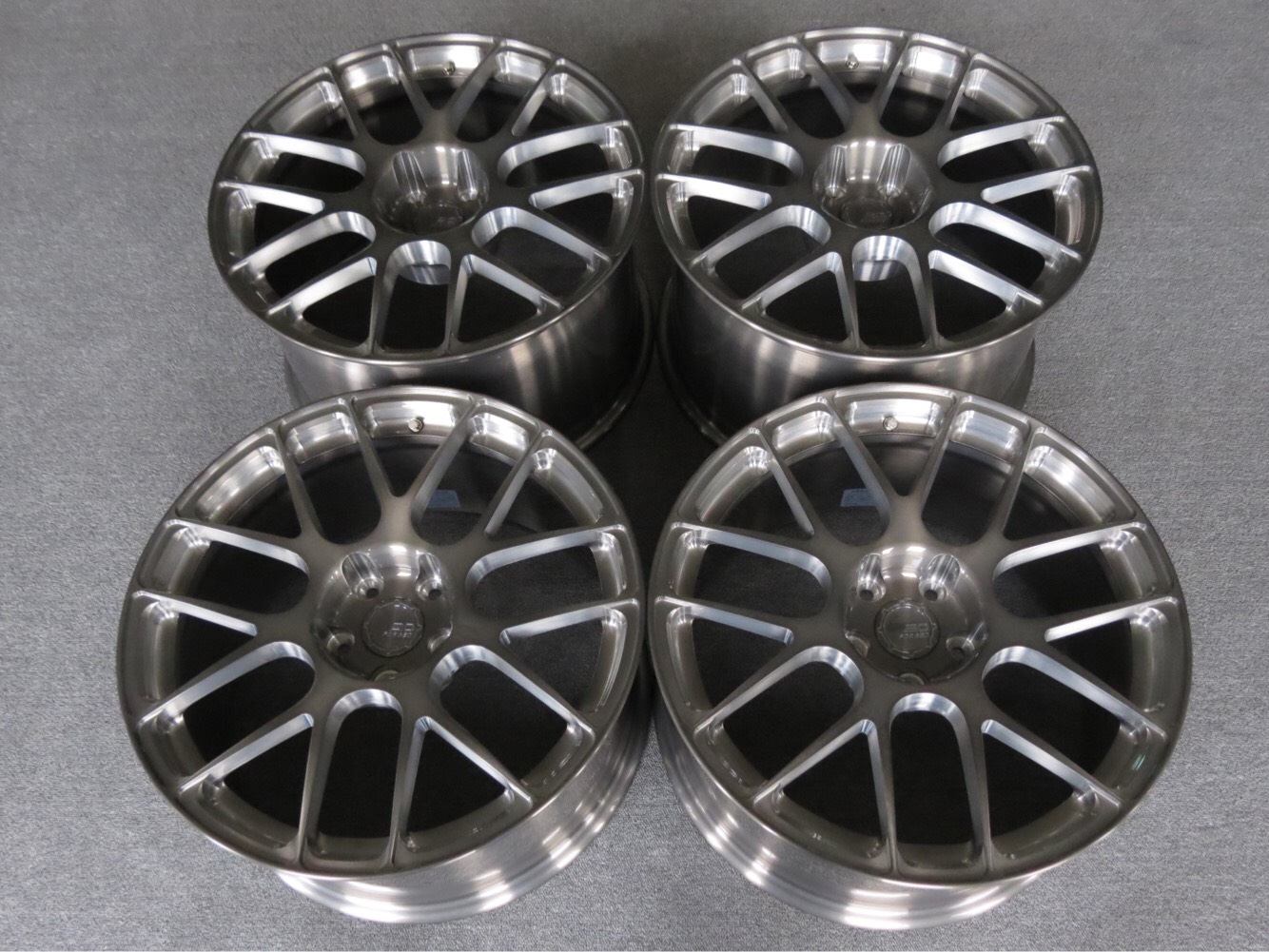

I have purchased a set of wheels from Redpants in a 19x9.5 and 19x11. (Excellent experience working with Richard) Results below - and I fit 265/35 and 305/30 PSC2 on them - I am very happy with the results

Please show pics of these on the car, with some side shots showing how flush they are.
What BC model are these? I got the RZ21's which should be a wider "Y" spoke.

Will do when I return from business travel. They are the RS40s with a flat spoke design - fit is perfect as I pushed them around the track two weekends ago
