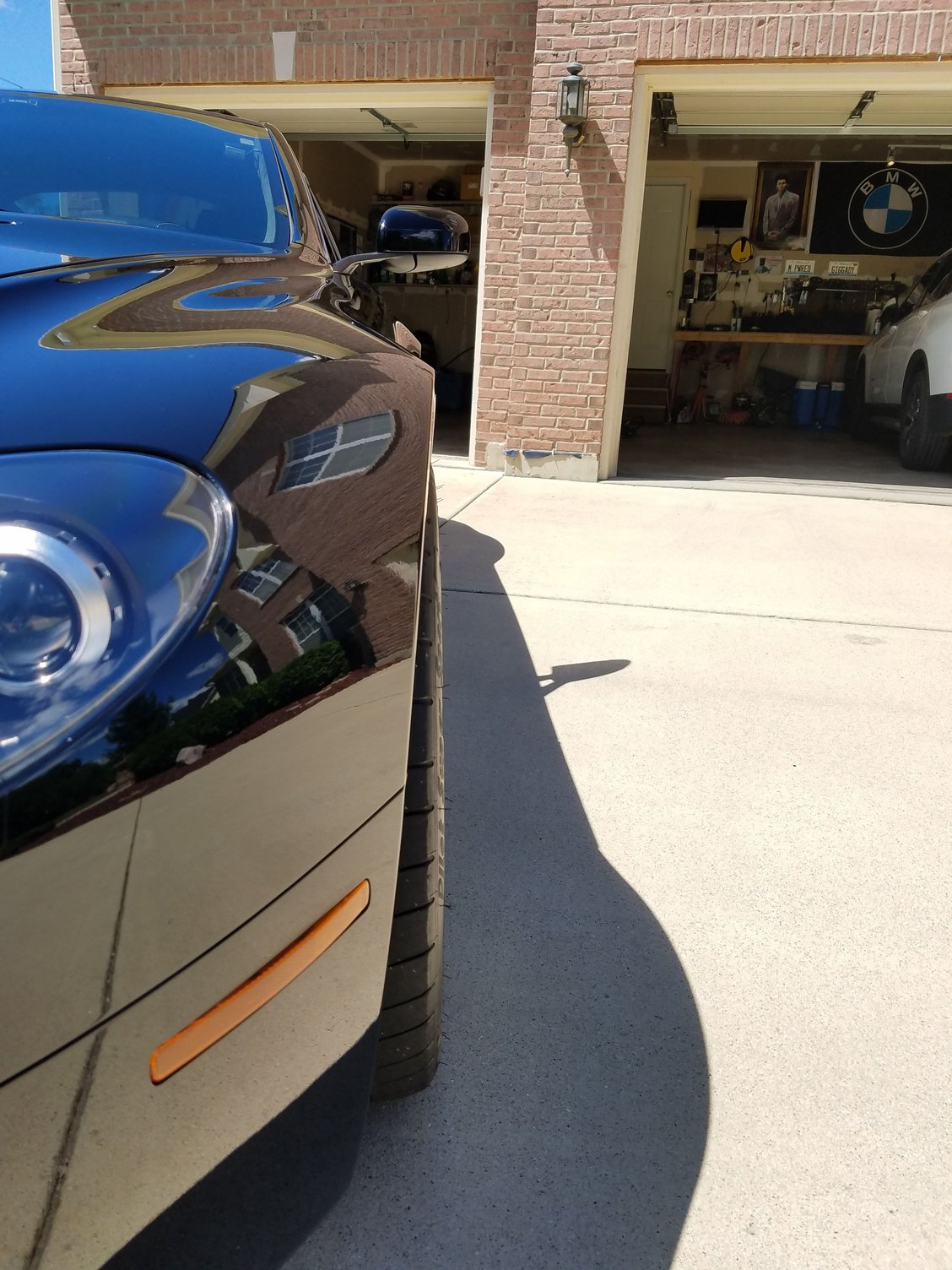

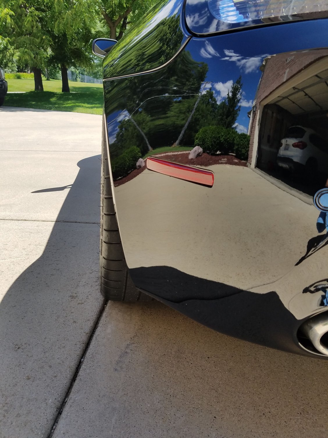

I purchased a 2 sets of 20mm spacers from the OP's ebay vendor as well as the same lugs. I got roughly 7.5 turns on my V8V with Sport Pack wheels on the 4 corners. I think this is very close to OE due to this neat lug nut design...within a few mm. I feel safe about it and love the look. Now I just need coilovers which most likely will result in new wheels. Maybe next year.
Thanks OP.
