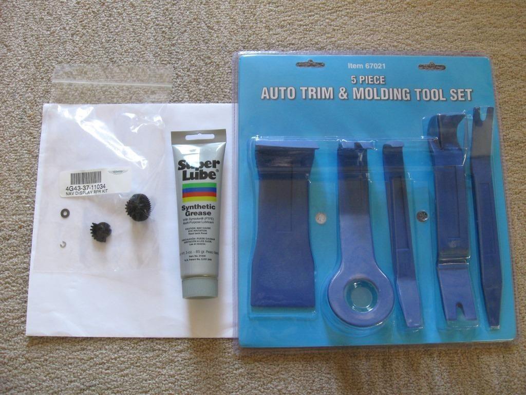

Here's what you need...
Hope you enjoy the Vantage should you chose to purchase...double check that the part kit is applicable to your MY.
Repair on my MY07 Vantage done in 2015
