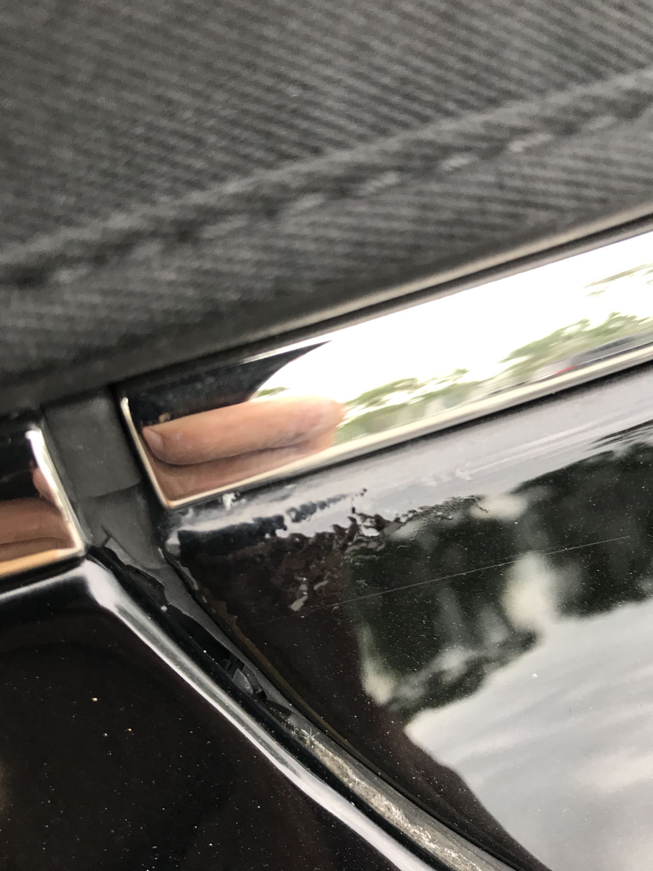

That is good news. Seems like a solid car. I have paint bubbling up in 2 spots on the convertible top stowage cover. Have you had any paint problems on your cars?
If your car is a 2013, I would see a dealer for that. Quite possibly rust occurring I think under that. I forget what paint bubbling means. Likely water or moisture under the layer causing it. You see that on old cars a lot, and usually means rust I believe. Might be wrong so don't panic.
Well was wrong, aluminum panel like posted by others, and paint not adhering due to contamination during the paint process. Unless a warrantied car, Aston likely wont touch it. Deal with it till it gets too bad and then have someone respray it.

I have that on mine too, it is from the panting process. Tonneau covers are aluminum and they attach something (not sure what) to the panel and from what I was told that if they didn't clean that off before primer and paint, that the paint would not adhere properly. Was told that at 2 different dealers, could be just a line or the truth, not sure which.
