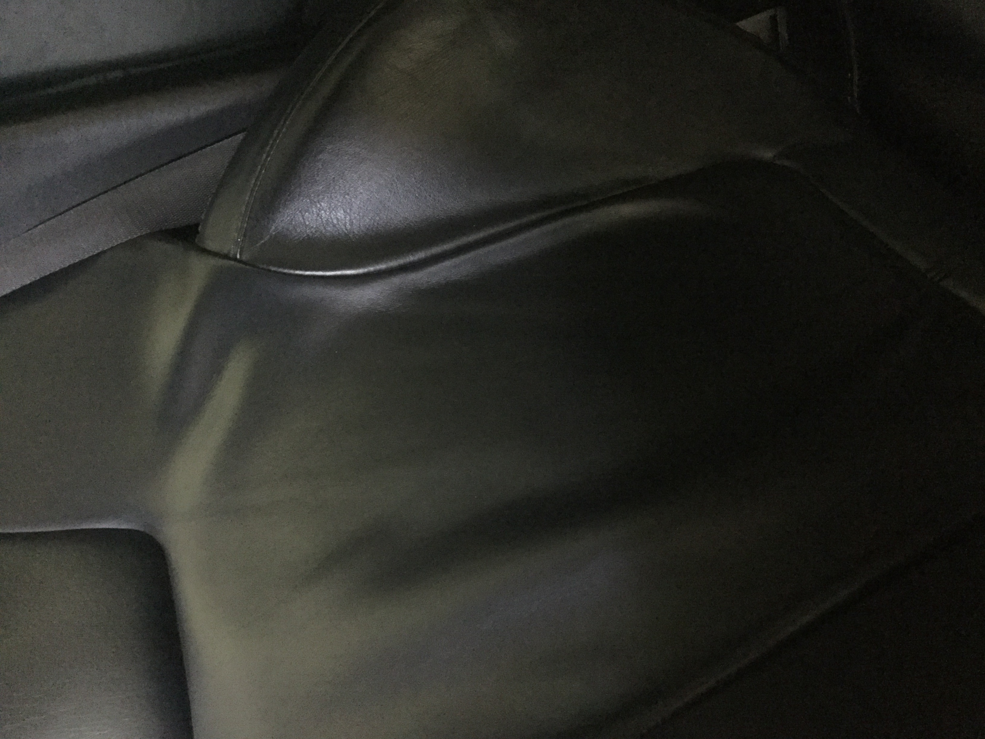

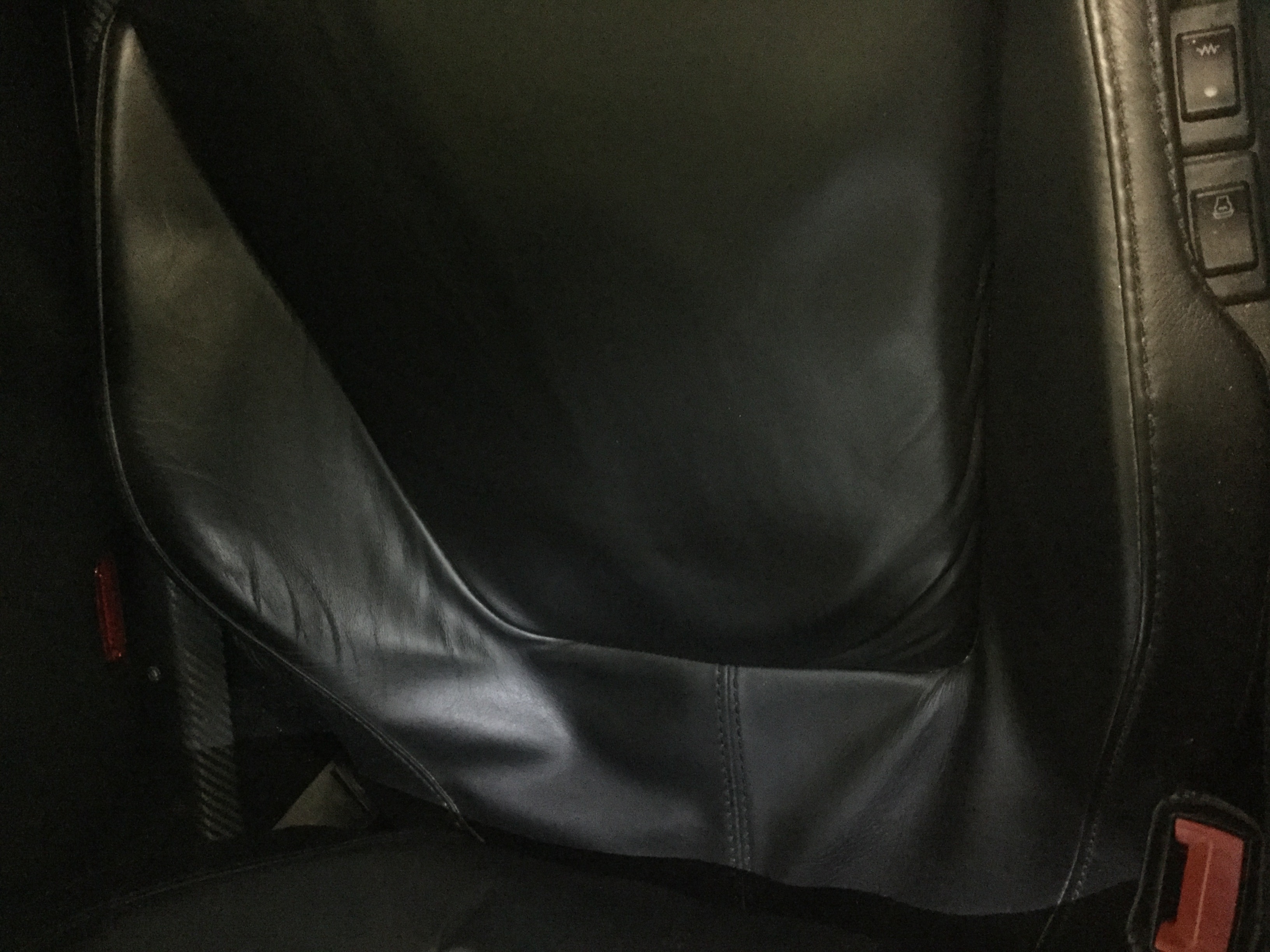

Saggy seats
After a lot of time and effort my old 2006 that I have owned since 2009 literally looks flawless following a detail, ppl and ceramic coating. I now can't help but notice how much the interior is letting the car down.
The car has just over 40k miles and I have been vigilant around using leatherique every 6 months and always putting up the sunshade to protect the interior.
The seats are starting to look like the leather is baggy. It is getting so bad that wrinkles in the leather are forming due to the excess leather. I don't think it's the seat cushion breaking down as the seat back is also baggy. Has anyone experienced or seen this as I would love to fix. Thanks!

saggy leather
The leather looks in great condition
There have been discussions on this before - applying mild heat via hair dryer can help shrink the leather - I'd be wanting to do some practice first por find someone who knows leather to assist you
possibly a you tube search
good luck

Thanks Graeme, I should have mentioned that I did search and found many YouTube videos around using a hair dryer or heat gun.
I tried a hair dryer for a long period of time and saw no results. I might add my seats are saggier than those I saw in the videos and non of the videos were astons, although that last part should not matter.
The other reason I saw that was suggested was overweight people in the seat. I am 6' 3" and 180lbs so that can't be it. Car is garaged always.

As a matter of background, some years ago, I attended a tech session put on by a supplier of Jaguar interiors on how to do an installation of new leather seats. A demonstration was put on of how to use a heat gun- not a hair dryer - to take the wrinkles out of the new leather seats. I put this to use installing a new interior in my Jaguar E-Type. I kept several very wet towels close buy to quickly cool the seats as heat was applied to shrink the leather where it inevitably showed wrinkles after installation. It worked like a charm but it was a careful balance of using enough heat to shrink the leather and avoiding too much heat that will distort the leather, or worse yet, burn or discolor it.
It appears that some of your seat leather has stretched quite a bit. While a heat gun will shrink leather, from my experience, I don't believe it is capable of restoring your seats to their original shape. You may want to look for some other remedy.

Shooting from the hip it looks like your seats are stretched beyond repair.
How much to would it cost recover them? At least you have an easy color to match.

I don't think they need to be recovered, just stretched. The leather looks to be in really good shape. I would run them by a couple of auto upholstery places to get opinions. I bet it would be less than $500. If you were in Denver I could tell you exactly where you want to go.

Thanks for the input gents, good to hear stretching is an option. I'm assuming this route would be substantially less expensive than a new cover.
Leather is in good shape thanks to leatherique....but now I wonder if the application at least 1-2 times per year over last 9 years has actually aided in the stretching?
Does anyone have an older higher mileage vantage like me with great seats? Curious how you maintain

Has the 'sagging' / loosening of the covers occurred primarily since you acquired the car in 2009, or was it already an issue when you bought it?
In what sort of shape is the foam underneath? Is it deformed and is this contributing to the cover issue?
I understand the sagging issue is unlikely to be caused by whatever surface treatment is in use, but the only thing I would want my leather to "absorb" is a small amount of water, and the consistency of Leatherique has never reminded me of water. Their website makes all sorts of mention of "protein" in the product. I'm not sure how saturating urethane coated leather in protein has any benefit.

The leather was slightly lose when I bought her but has become much worse.
Not sure on the shape of the foam underneath. By feel over the cover it feels fine and not deformed. Would need to remove cover to be certain.
I'm not entirely certain if leatherique has any benefit either but I can say the leather itself is in at least as good of shape as when I purchased it with the exception of the sagging. Thinking I will try to find a local shop that will stretch the seats.

Leather conditioner in all likelihood had nothing to do with it. Looks like "normal" wear to me. Leather conditioner doesn't really "penetrate" modern leather as some would suggest. Modern leather is coated and nothing really penetrates it to effect its elasticity etc.
New leather hides are relatively inexpensive. Any competent upholstery shop can easily recover these for you for a couple grand and you'll have brand new seats for all practical purposes. Removing them is super easy.. I pull mine out just to gain easy access to the back seat area for cleaning the leather and windows.
My seats are at an upholstery shop right now having some custom diamond quilted pattern done.. The cost is really very nominal. I have plenty of leather (Obsidian black) around if you need some.. Please feel free to contact me.

Do to an upholstery shop. If you are lucky they know a fix or can facelift it cheaply. They will be the ones who know about leather, how is sags and which chemicals do what.
