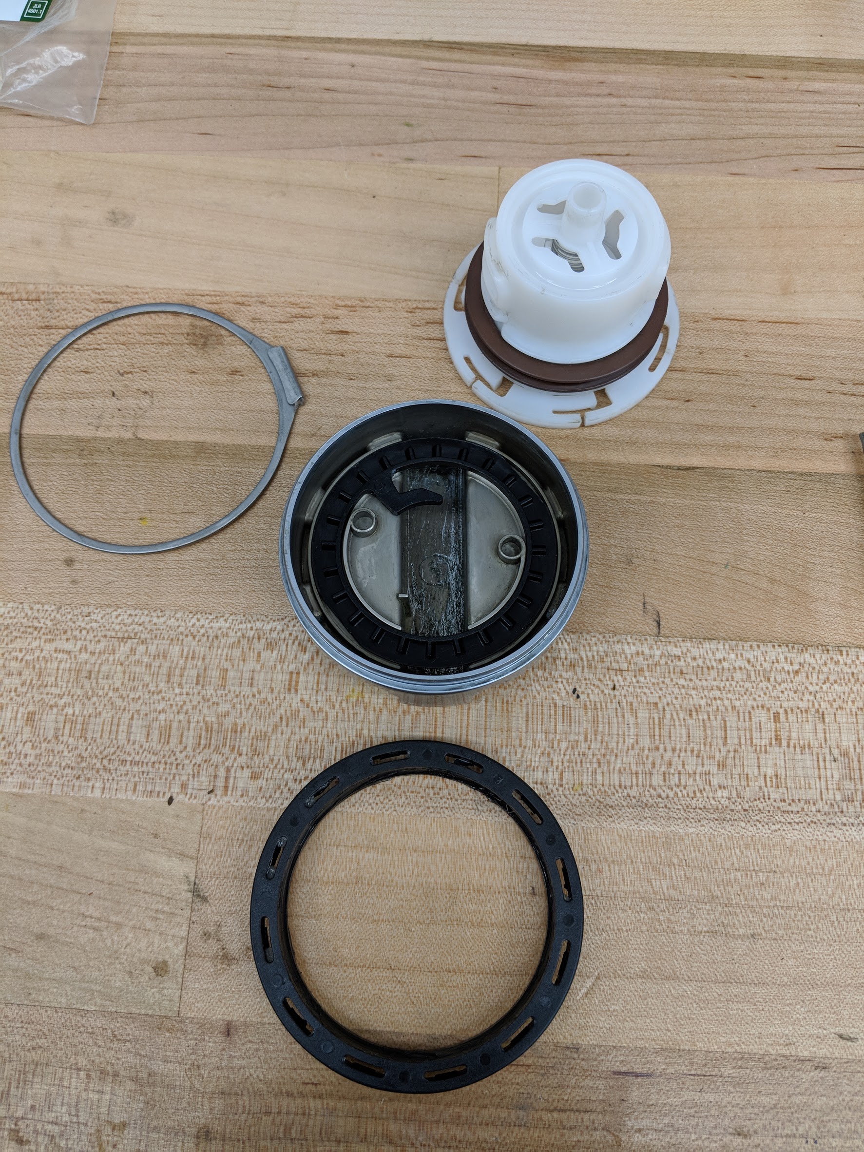

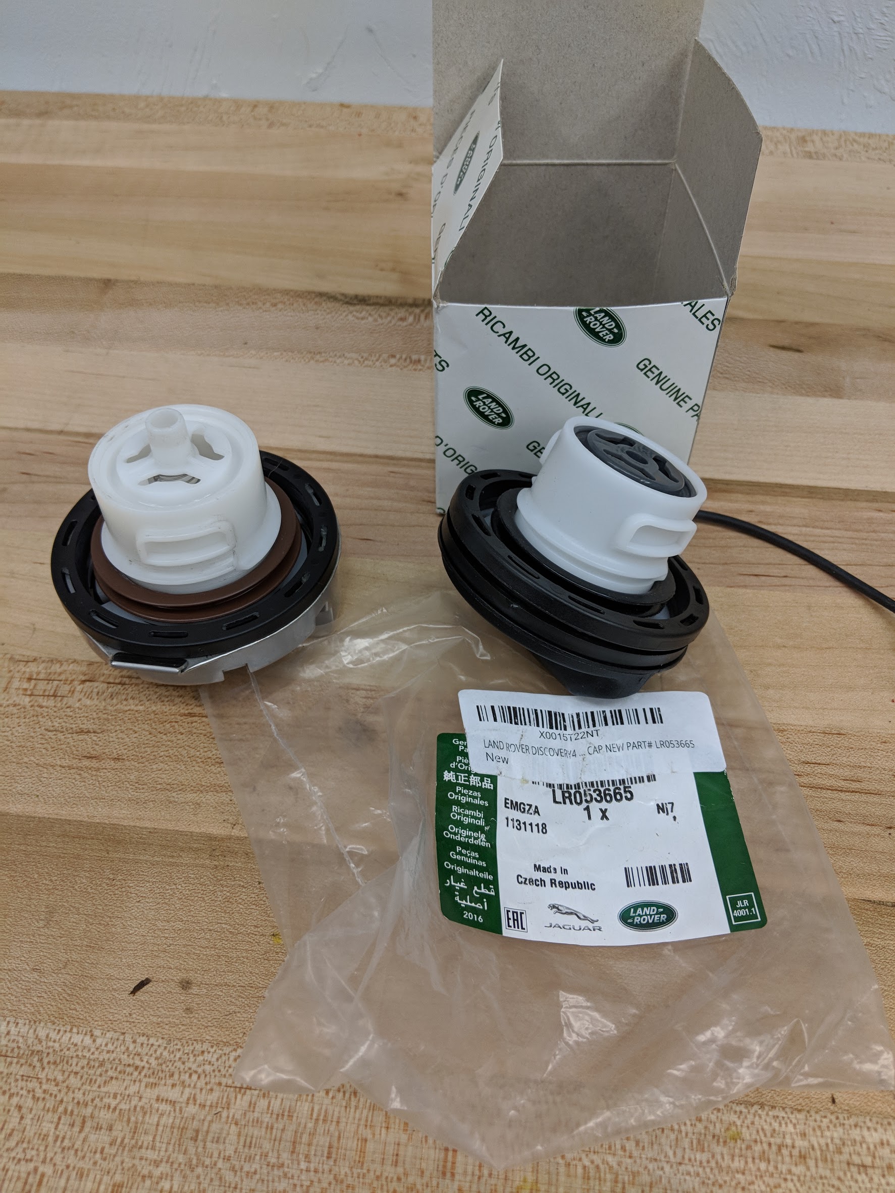

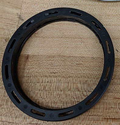

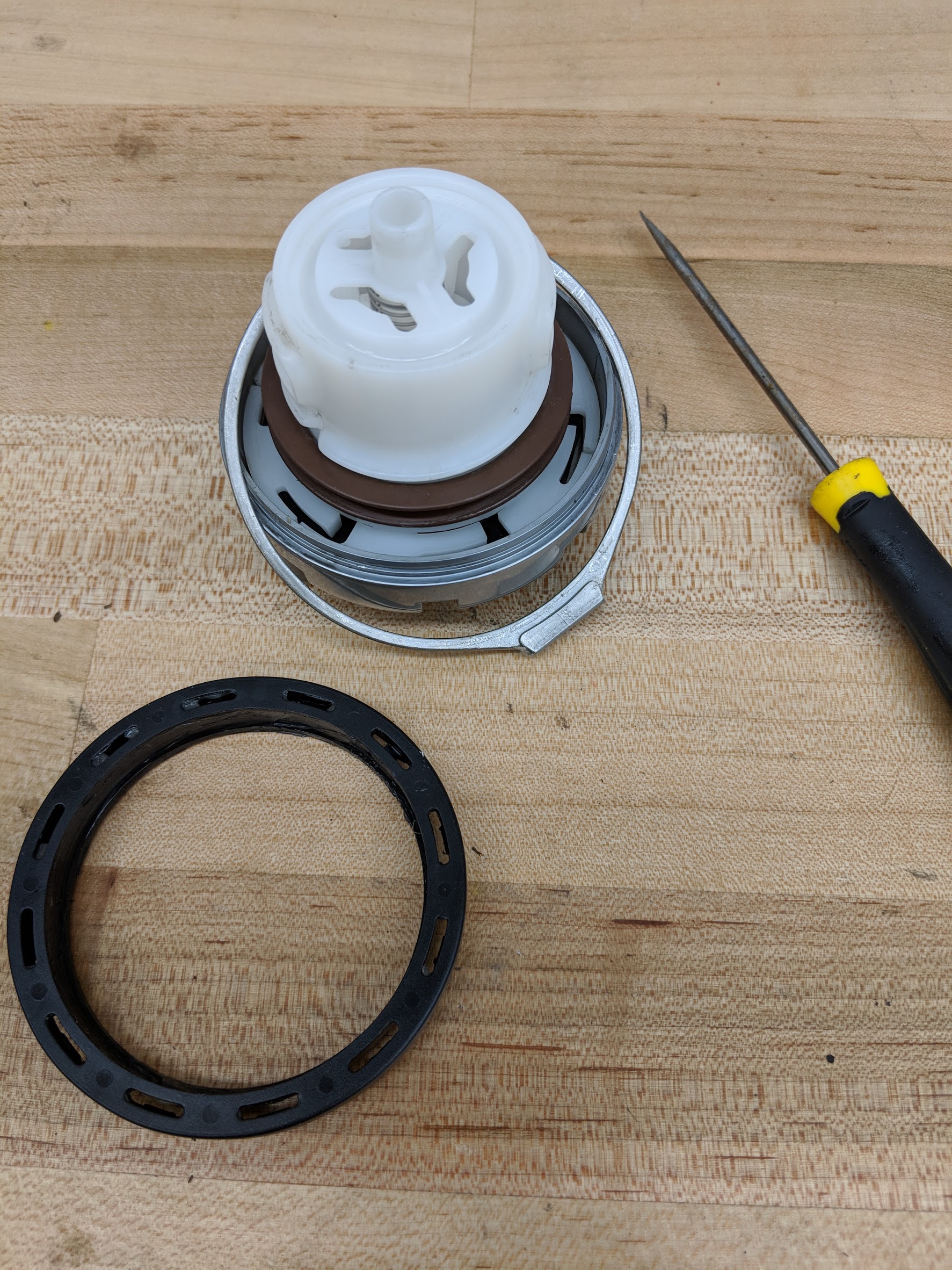

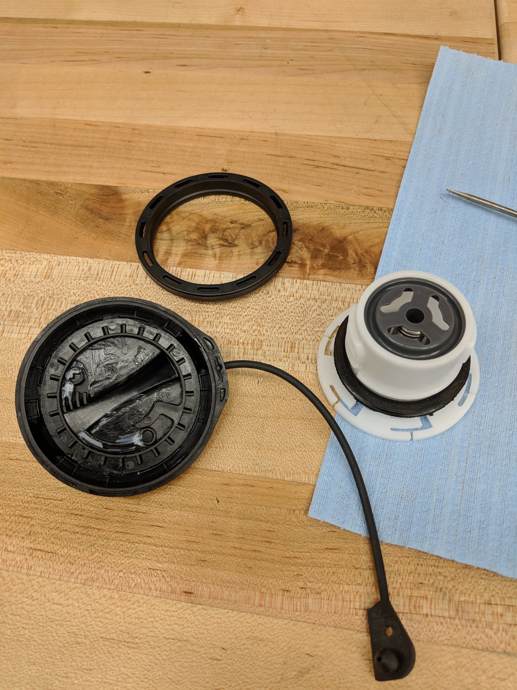

2006 V8 Vantage Gas Cap fix - How to do it for under $30
Hi all,
I found out that the Rover gas cap is a perfect replacement (see pictures for part number) and permanently solved the OBDII error code and warning light on my dashboard. It is very easy to disassemble the original Aston Martin cap and swap out all of the internal bits (see pictures). All you need is a screwdriver to pry out the plastic ring and it is a five minute job. Make sure you take note on the correct placement/alignment of parts on the new cap and replicate on the Aston metal shell.

How did you get the ring of the Aston gas cap????
Could you share your trick please.

The metal ring just slid off the gas cap. You will notice that there was no tether attached to it in my car. Not sure whether the prior owner had tinkered with it but it does not look like it. It was kept in place by the plastic ring on top, nothing else

I mean this piece.
Is it screwed or glued?
