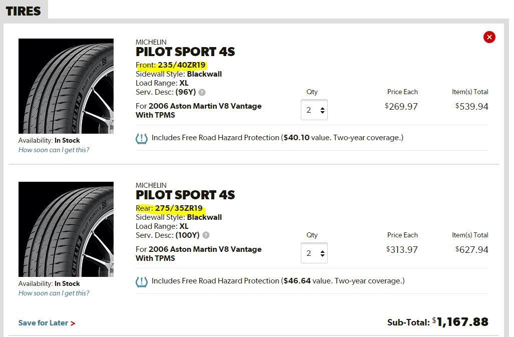

Option 1 – Factory Tire Size, Stock Rims - I have these now
· Front - 235/40-R19
· Rear - 275/35-R19
Option 2 – Minor Up Size – as many of you appear to be running (again I searched)
· Front - 245/40-R19
· Rear - 285/35-R19
· Speedo error is 0.5 to 0.7 MPH at normal speed (irrelevant)
· TireRack Cost is about $18 more for Option 2 (irrelevant)
I used https://tiresize.com/wheel-offset-calculator/ to compare the tires…
Questions:
With Option 2 the tires in front and rear will be slightly wider (good) and slightly taller (why is this good)?
Yes the tire will fill more of the wheel well, but it will also raise ride height – and isn’t that normally a bad thing?
Many of you seem very passionate about NOT going with the factory size and I am trying to get my mind around the benefits of going to Option 2.
Also - to be fair, it is possible in "my application - date car" that I will not notice the difference either way.
Shorter version - I have the original factory tires in my Tire Rack cart and I am looking for a reason I should buy the bigger ones (Option 2).
Input is appreciated.

Yes you can get PS4S in option 2.
It's what I have and I too had the original AM9 tyres (which were designed for the DB9). I went to this for a number of reasons.
Slightly wider
yes more grip and traction. Slightly increased front v rear grip with 4.2% increase front v 3.6% rear, reduces understeer to more neutral balance.
Slightly taller
PROS-better ride on our rubbish roads due to more tire side wall compliance and should in theory provide better grip and traction on poorer road surfaces. Reduces chances of scraps if you don't lower the car. Corrects the inaccuracy in the Speedo. Mine still slightly under reads compared to GPS speed but is now only by 1mph. Slight increase in gearing reduces cruise rpm.
Should last slightly longer with reduced revs per mile.
CONS- Yes they will slightly increase centre of gravity (but I always planned to offset this with the AP lowering springs.)
They will weigh slightly more and this is unsprung weight, but still significantly lighter than the AM9s.
Looks better, yes fills the wheel arches better, no rubbing. The reduced space between tyre and arch had quite a visual effect, more than I expected.

Thanks to all for the feedback!
Based on your various endorsements, I have ordered Option 2 (larger tires) from TireRack.
I have an appointment with my local independent mechanic for the installation late next week.
Looking forward to an incredible summer in the new car!
