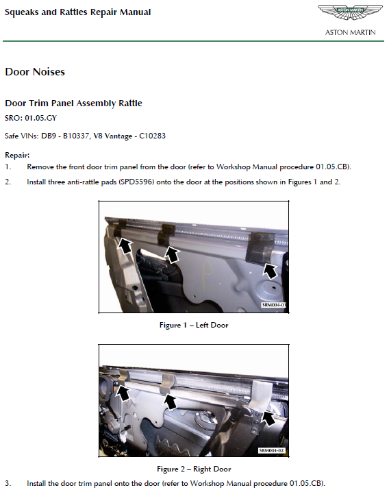

Hi again Scott - When you have the door panel off - take a peek and see if you have these 3 rubber pads (see pic) that they say to use in the Aston Martin Rattles & Squeaks Manual (My God they have a manual for that) to prevent the door panel rattle. Gotta think it was a widespread issue if it's in a manual

No, those anti-rattle pads are in place- they're more like closed-cell packing foam than rubber. Everything inside the door seems to be well secured, and I think it would be possible for that bolt that worked loose on mine to fall out, and have the window stay in its track thru friction for a period of time. I used Loctite on mine, as I was afraid to torque it down as much as I would have liked for fear of breaking the glass.
