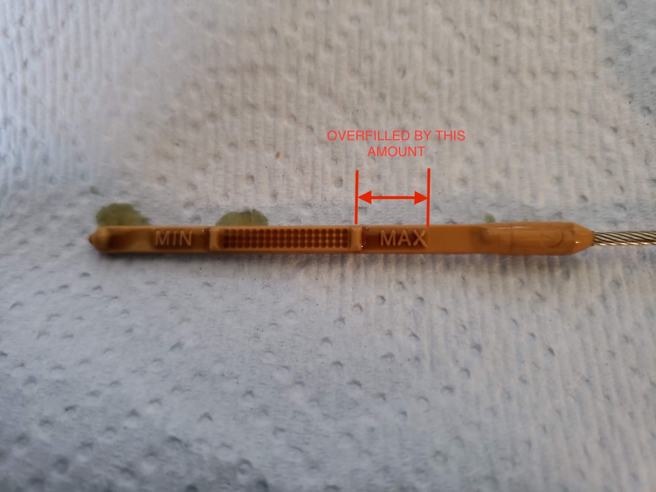

Well guess what...it hurt a bit more a few weeks after the service too. I hadn't been driving much after the service because of spring rains, but eventually I finished a tank of gas and went to refill my tank -- at which point I checked my fluids.
Oil dipstick showed the oil level was a good bit beyond the maximum mark!!! I stood there fuming a bit knowing I've been driving with my oil overfilled and paid a lot for it too. Drove home, let car sit till cold on level surface, checked again, and it was clearly overfilled (see photo).
So I used a fluid syringe and plastic tubing to drain ~3/4 quart oil out via the dipstick tube to bring the oil level down below the maximum mark. So it was only overfilled by 1/2 to 3/4 quart. I know 3/4 quart over isn't going to destroy my engine - it wasn't frothy or burnt - but it makes me upset the dealer did this and that I trusted them and didn't check earlier.

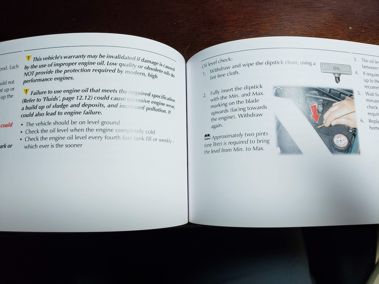

Thanks J doubleU.
I was following the oil check procedure in my owner's manual -- did they issue an updated bulletin? Any way I checked it...hot, warm, cold...showed that it was overfilled.
