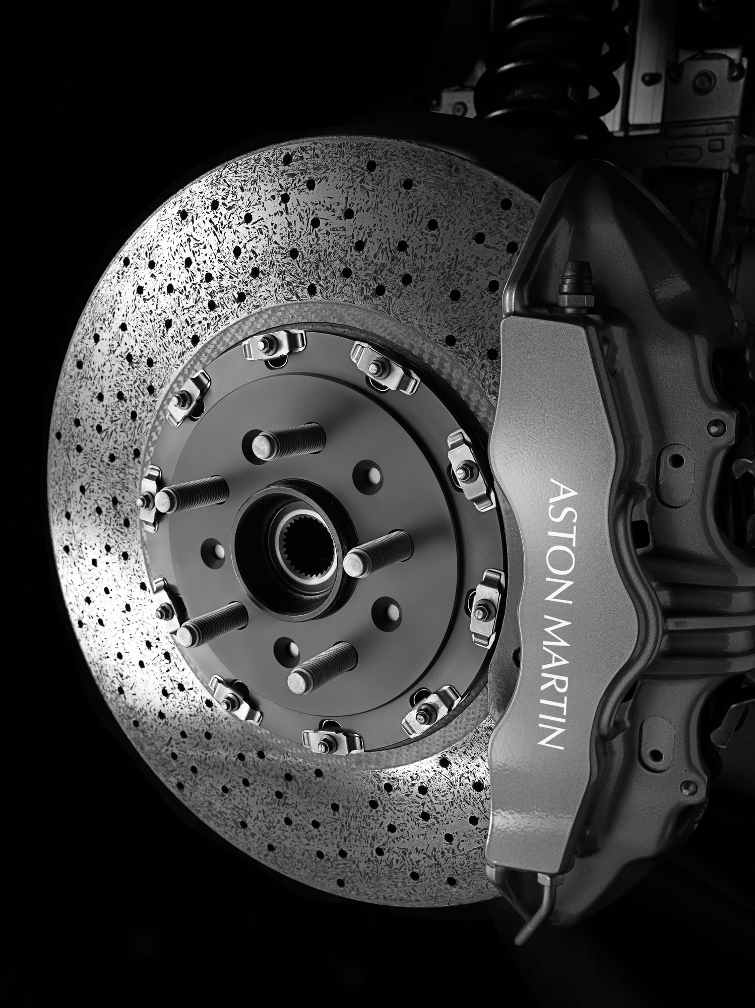

Nothing of value to add here but I wish those rotors had the hardware with the clips where the two pieces attach.
Similar to these:
Old Aug 19, 2020 | 11:52 AM
MichaelD's Avatar
Joined: Nov 2010
Posts: 350
From: NW England
Rep Power: 30
MichaelD is infamous around these parts
Similar to these:
Brembo, makers of our OEM brakes, also do lightweight 2-piece rotors that have those clips, or some very similar.
The front ones are #102.8013A (or E for track day discs with different vanes). Rear are #202.6001A.
In UK they are around £1600 front & rear, but I can't find the weight of them, have written to Brembo to ask, but they are closed down for most of this month.
