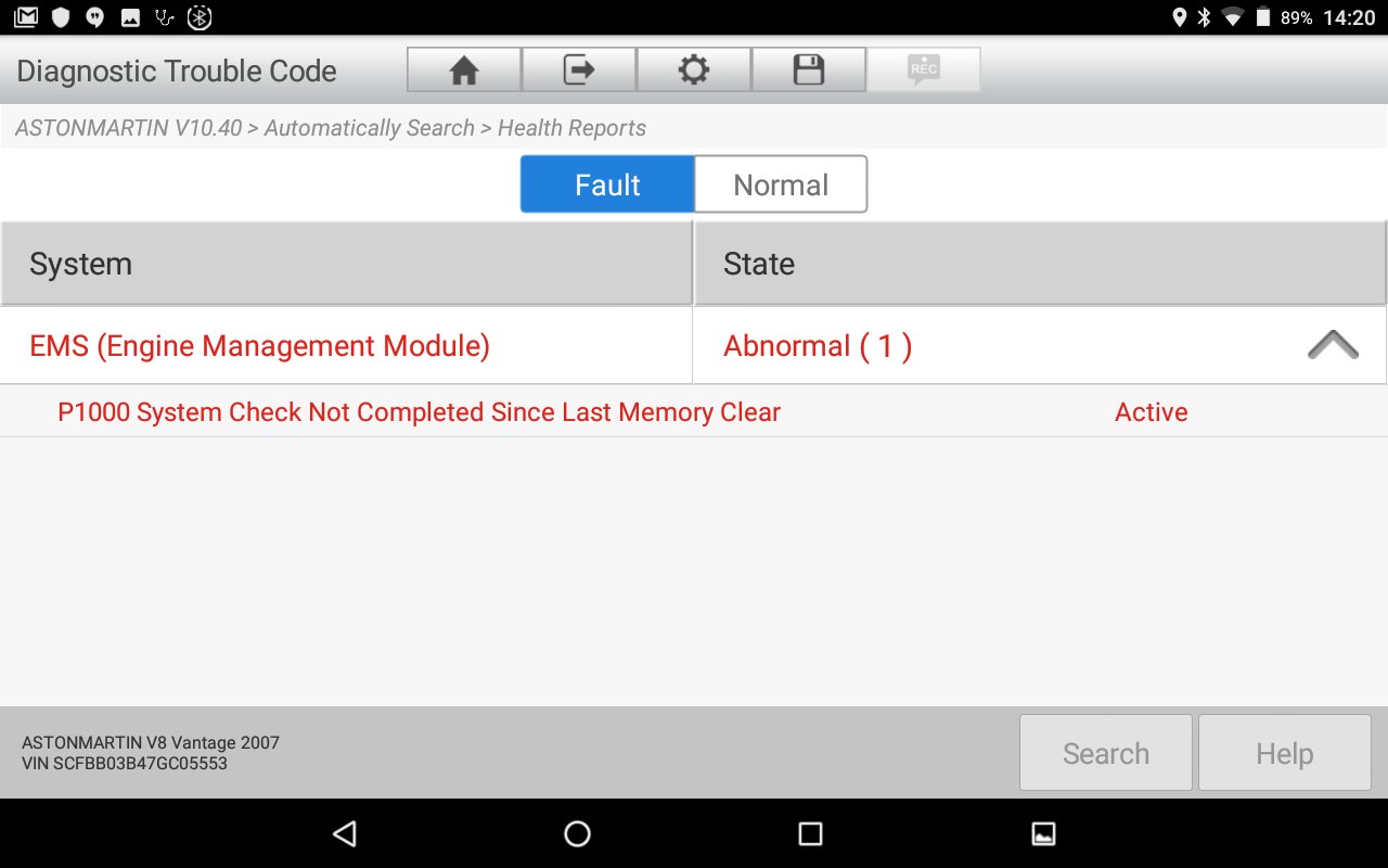

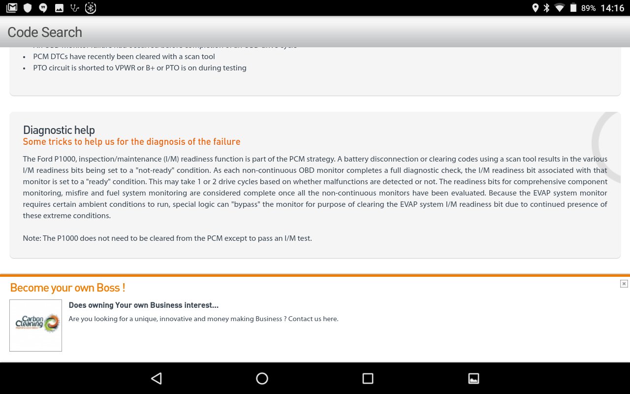

Okay, so I checked to see what was working and what was not. As far as I can tell, the only thing that is not working would be the tach and the dash communication screen (see pics).
I keep getting that P1000 code, (see pics)
The tach is stuck here, I have never seen it move yet.
This is the code I get from the ECM OBD. It will not allow me to clear it.
