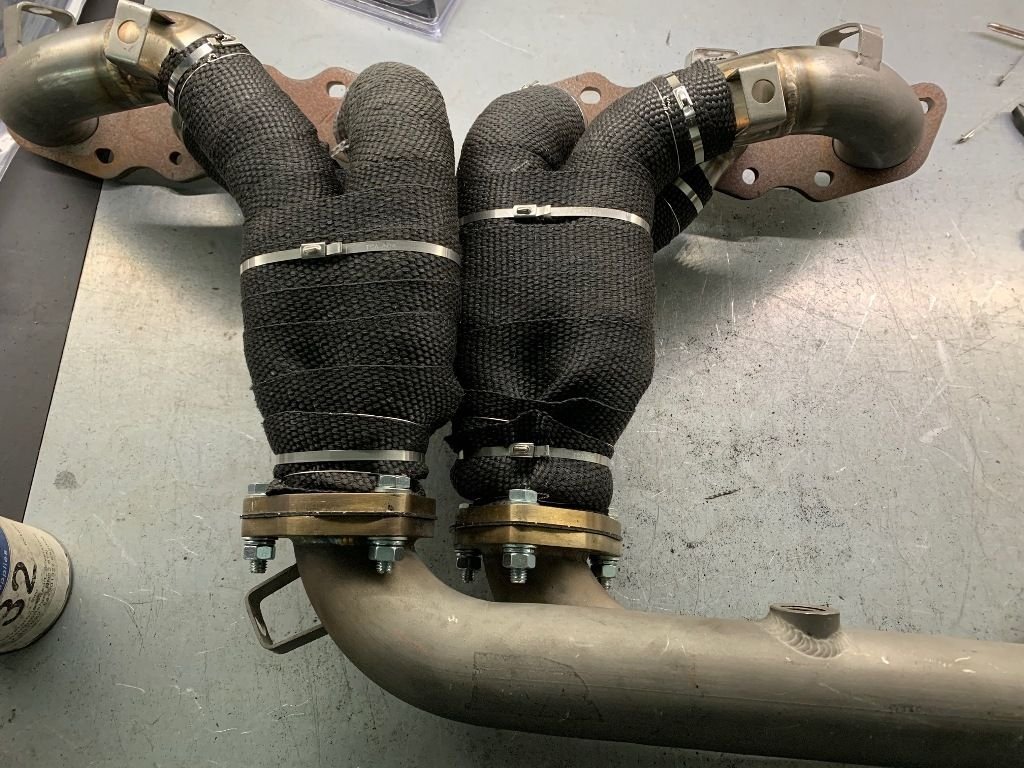

Absolutely true, if a misfire allows unburnt fuel to enter the close coupled cats in the exhaust manifold, they overheat and break up, throwing their insides back up the xhaust port during scavanging, past the exhaust valve and destroy the motor. Hot tip is to gut, or remove those cats and move the O2 sensors to prevent emissions warning lights.Here are a set where my stock headers have had the cats cut out and replaced with tube.Installed with exhaust wrap to retain heat in exhaust, reduce underhood temperatures and protect adjacent components.

Looks very neat.
