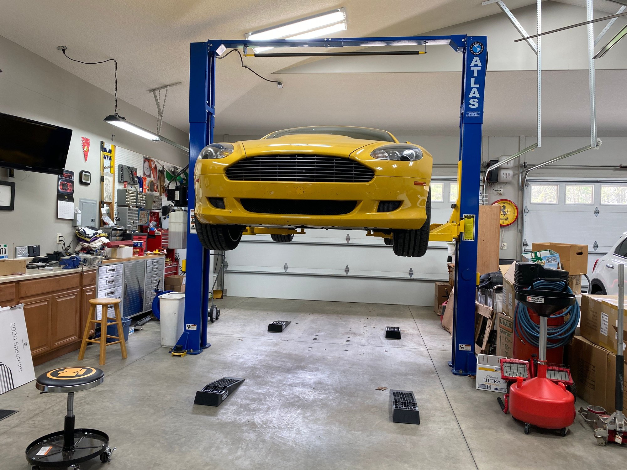

Just did all the fluids in my DB9. I will tell you that a lift helps!!!!

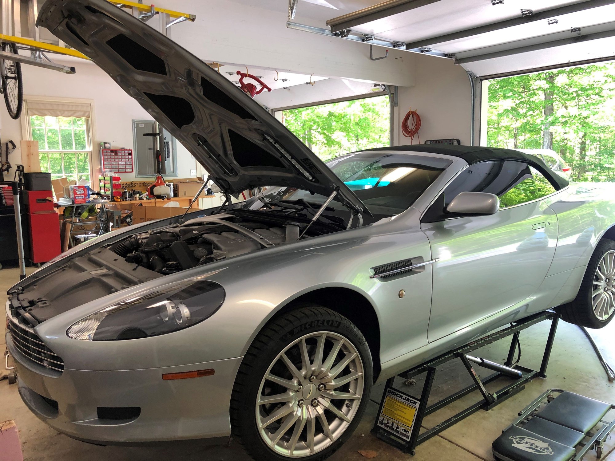

Highly jealous of that lift!
I have the next best thing...
