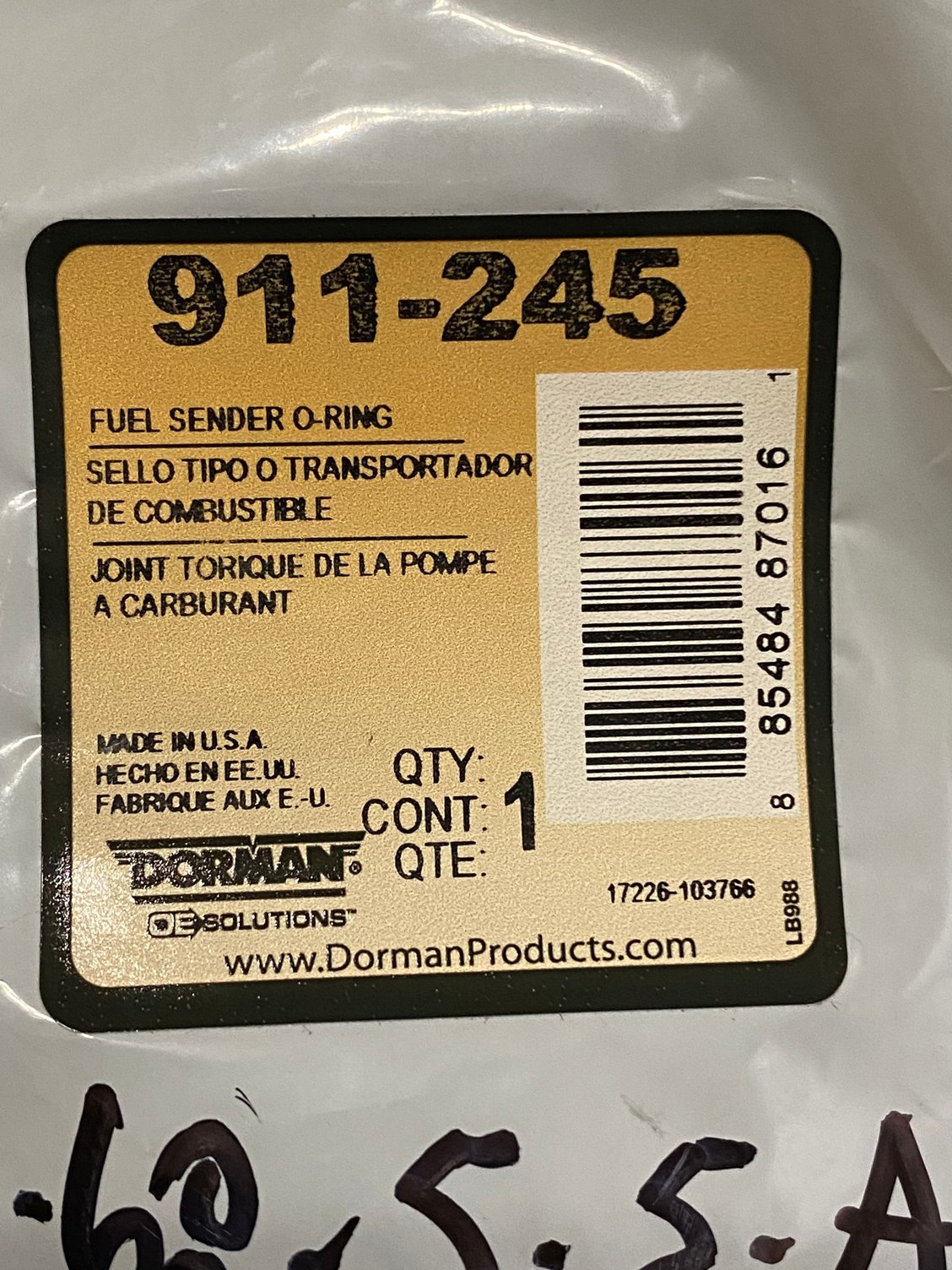

after I replaced fuel pumps , my fuel tank seal is leaking too and I have smell of gas in the car.
official procedure says anytime one opens the fuel tank access panel AM Recommends replacing fuel tank seal.
I plan to get fuel driver and fuel seal order together once I get update from you .
