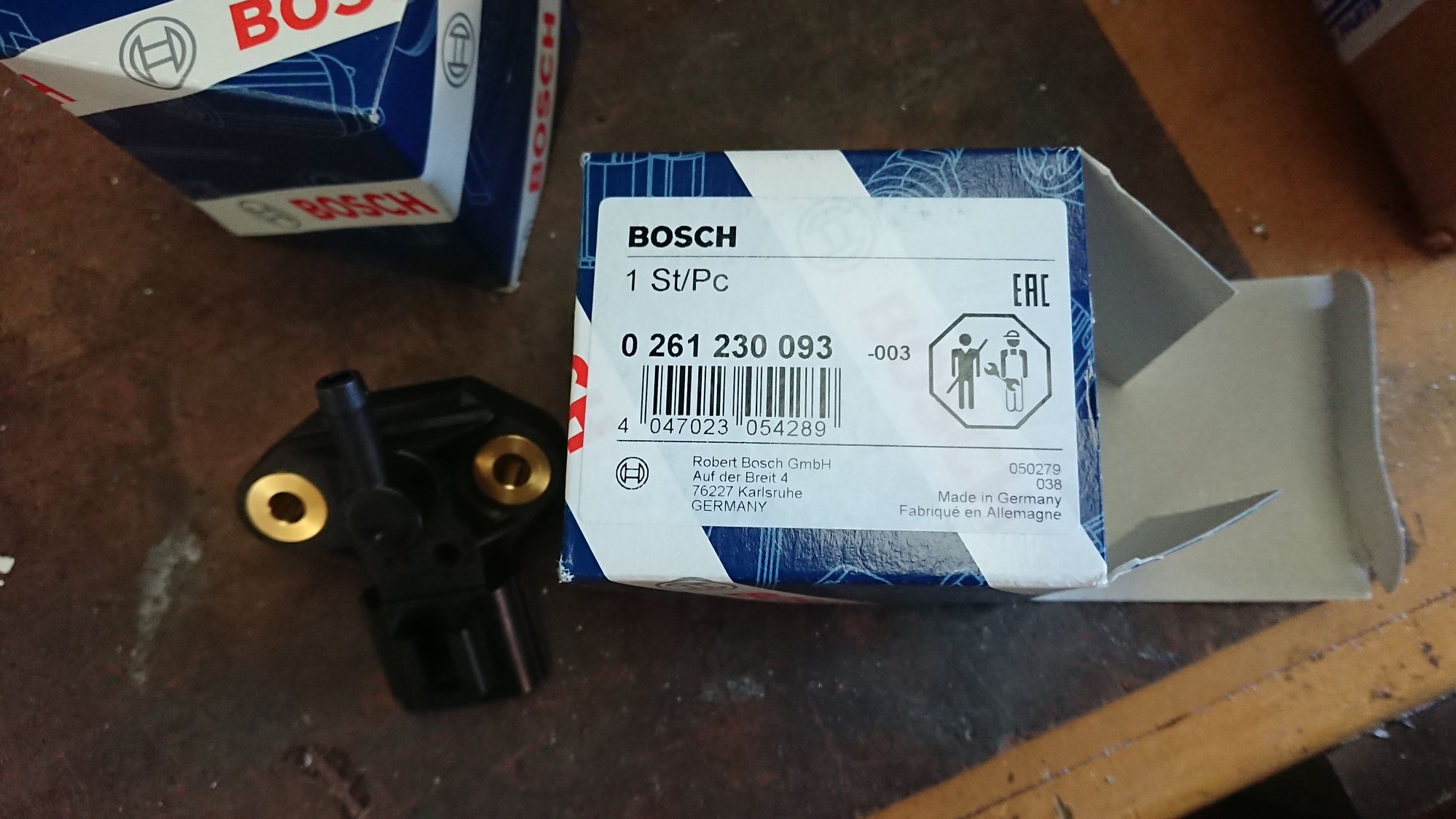

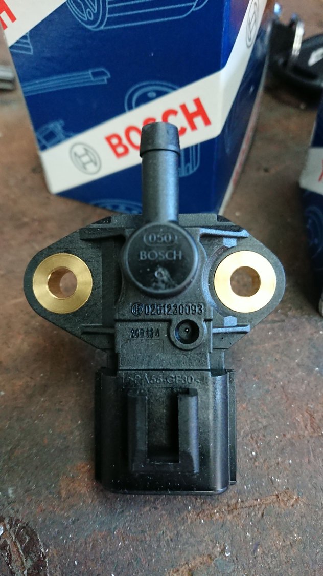

Hi all, I'm touching wood as I type this but the issue seems to have gone away, this is definitely the longest stretch without a fault since I've owned the car. So the previous owner replace both fuel pumps to no avail. I had the inside of the fuel tank inspected and new seals fitted to the tank cover, no go. Then we replaced the fuel pump driver on the faulty side, still no joy. Then we replaced the fuel pressure sensor on the faulty side and that may have fixed it. Murphy's law that the cheapest and easiest thing was the culprit. As mentioned earlier, the pressure sensor is a standard bosch part, don't get ripped off by AM (or anybody sourcing parts from AM)

Good news then, did you have the part number for that Bosch sensor to hand. I am going out to get two.
It's a few posts above

Just to add to this thread. My 06 DB9 was getting harder to start. Not severe but different. Decided to replace the fuel rail sensors.
On the 06, it's a different style. Still Ford Motor Co, but it's a 3r3z-9f972-aa, which I bought as a FPS7 fuel pressure sensor from Jeff Bezso. Fixed my issue! Well worth $145 for the pair....
