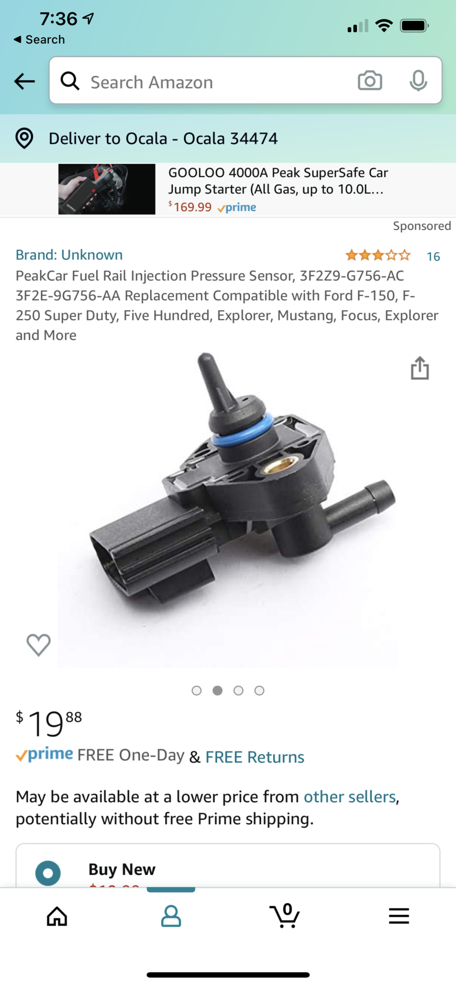

Originally Posted by Deanoroger
Awesome!! It wasn't the fuel pump driver, another 500 bites the dust. Emailed Mike at Bamford Rose and from what he said we have decided to go to the next easiest and cheapest thing, the fuel rail pressure sensor. Watch this space.....
fuel pressure sensor have cheaper generic version
if you have not already bought them. Just look at the part number on them and google it , even Home Depot had it here in USA and yes Amazon has it too
Thanks Wildcat but have already purchased from Scuderia (AUD 240 from memory)
Have you checked resistance on your driver modules you took it out? I had my friend checked them and they were different so we are thinking one of them is bad.
Well here it is for others who may need it
