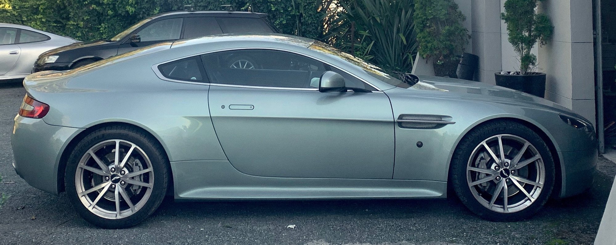

Originally Posted by drac
I've owned a MY2010 V8V non sport pack car for just over 5 years. I always thought it rode a little high and the set up was a little soft.
This is my car just after I bought it 5 years ago.
I put the Vel AP springs on my car about 3 years ago. They were just too low, especially at the front and made my car unusable. I don't believe these springs were ever really designed for the Bilstein equipped cars. I imagine they were initially produced for the early car's Multimatic damper. The 2009 V8V has completely different specced springs and shocks resulting in a spring length that is differrent.
My car straight after VAP spring install.

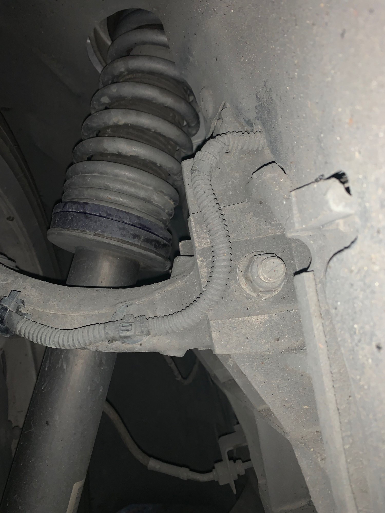

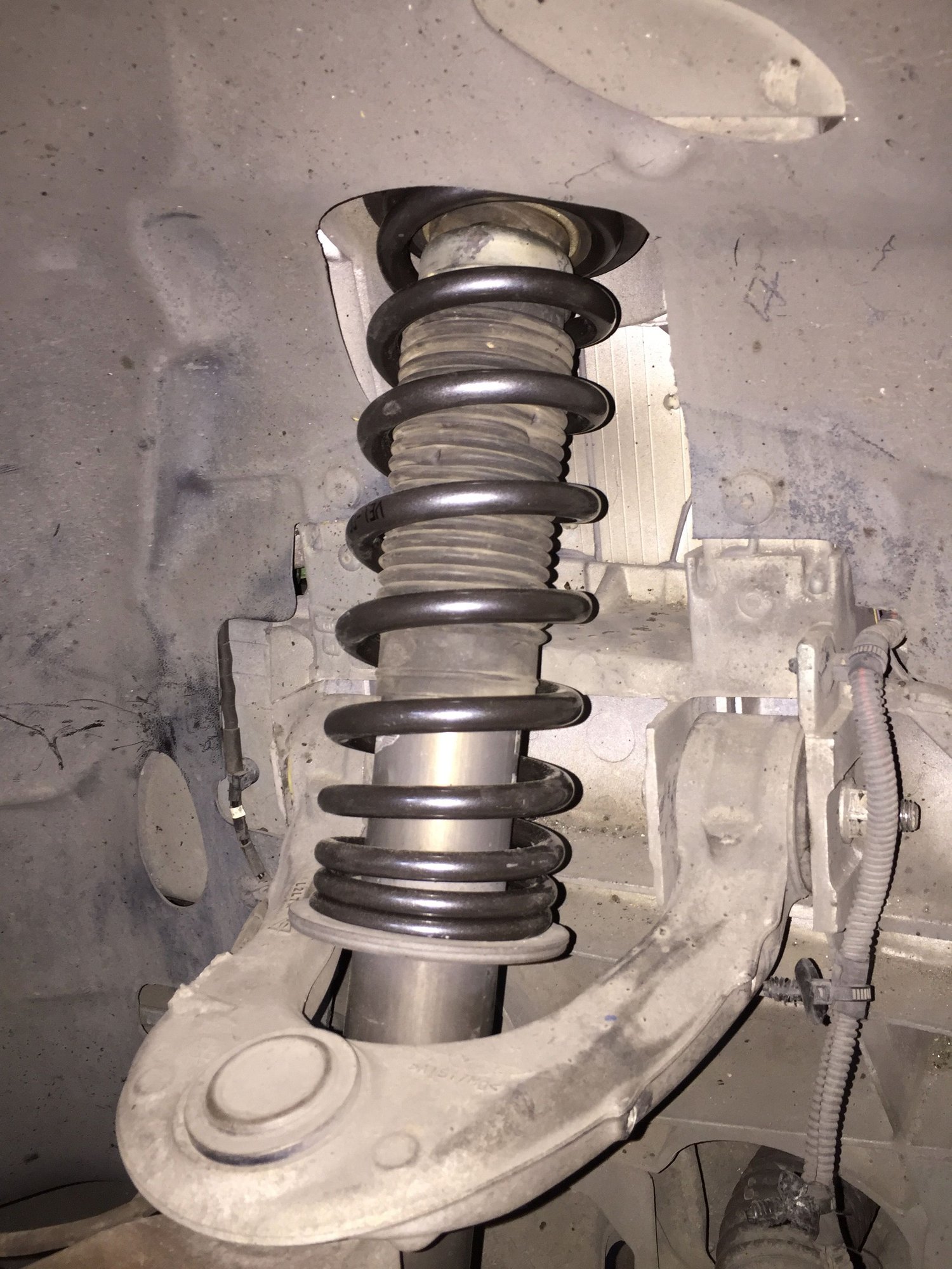

Front spring with car on the ground.
I'm happy now with the car. I think I used a 13mm and a 7mm on the front and ? a 7mm on the rear. Its about 15mm lower than stock.

Additional notes,
The very low ride height also makes the car quite jiggly and has quite a harsh ride. Rasing the height improves this with less being transferred into the cabin. I'm not sure if this is because of the geometry changes or the shocks being in a better working range.
If you have a non sport pack car the AP springs do effect the chassis balance(understeer). The car becomes effectively much stiffer over the front axle than the rear. (The non sport pack cars had a softer springs and a stiffer roll bar, the AP springs give you stiffer springs too.) The Vantage S roll bars can address this, softer front, stiffer rear or both.

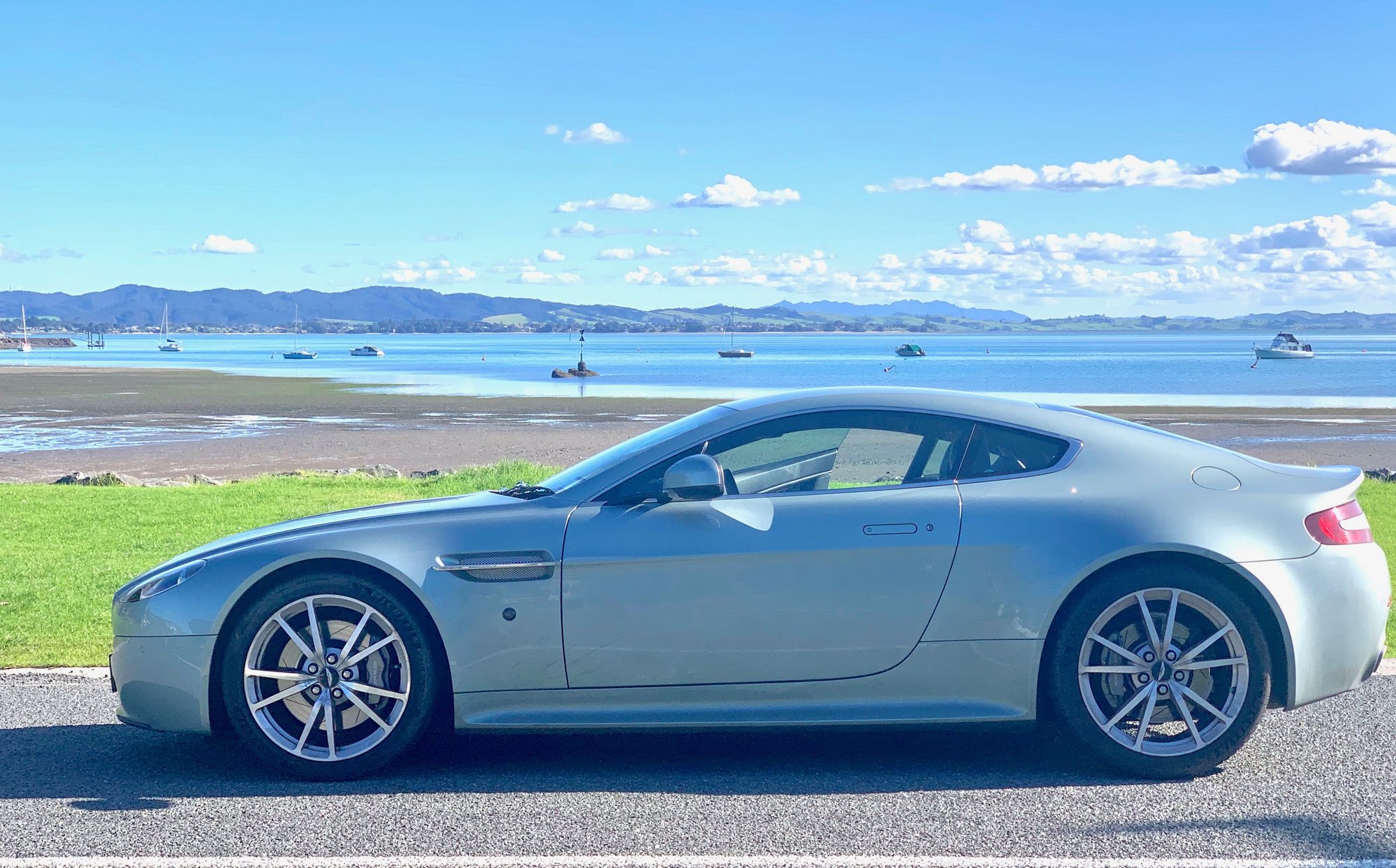

Sorry, it turns out that taking a pic in bright sunlight to show wheel gap isn't as easy as it looks.

I called the shop that ordered these for me and they looked up the part number.
https://superpro.com.au/tradeview/in...tnr=SPF0851-5K they are 12mm. There is also the 7mm that is SPF0851
https://www.ebay.com/itm/232577027251 this place is in the UK, but posts to the US and postage is reasonable.

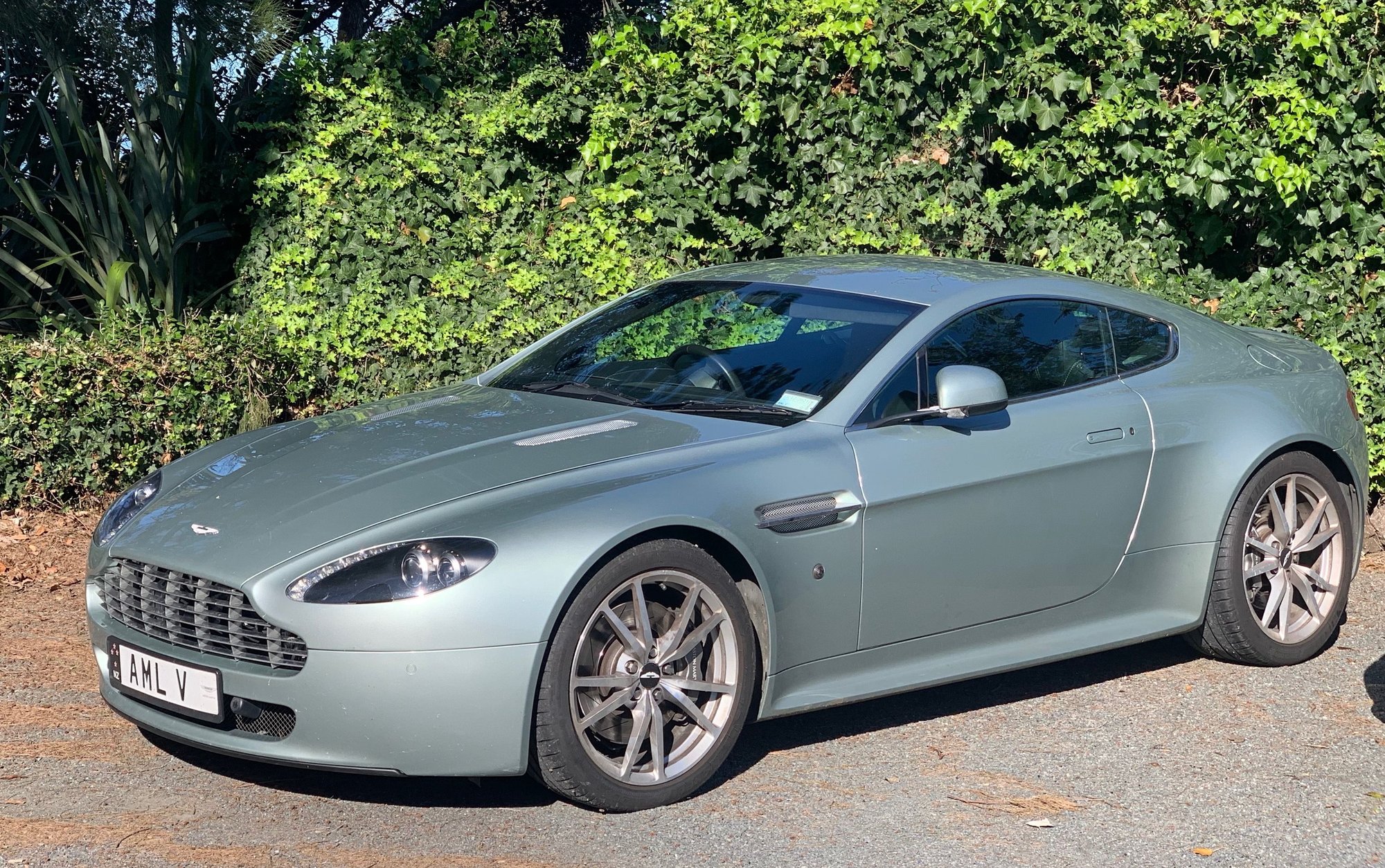

One more attempt to post pics to show the results(OEM, Too Low, With Spacers.). I don't have many pics of the orginal set up.
I'm happy with it, I think it's a good compromise, it no longer looks lofty but is easily usable. I had to go into town today, pull into driveways across some broken up ground. No scrapes, no issues.

I confess I should have been more scientific about this. I did measure from the fender edge to the floor and make some notes but did not take into account properly fuel level, tire wear and pressure etc. I now appreciate that there could have been better measurements to take.
Anyway this is what I have.
Front. OEM(2010) 708mm, VAP springs(immediately after install probably would have settled more) 670mm, current with coil spacers 695mm(well settled)
Rear. OEM(2010) 716mm, VAP springs(immediately after install probably would have settled more) 694mm, current with coil spacers 703mm(well settled)

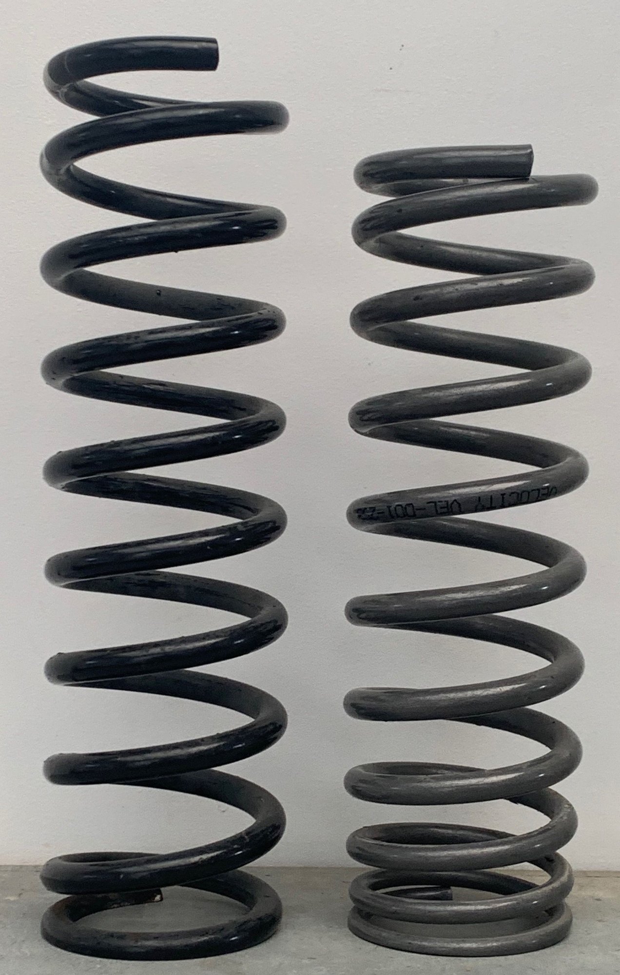

Here is pic of the spring from the 9G33 damper 09+ and a VAP spring. They do have different spring rates and are meant to lower the car but thats quite a difference.
When installed the preload is quite minimal. I suspect this is the reason it is lowering the front much more than expected.
