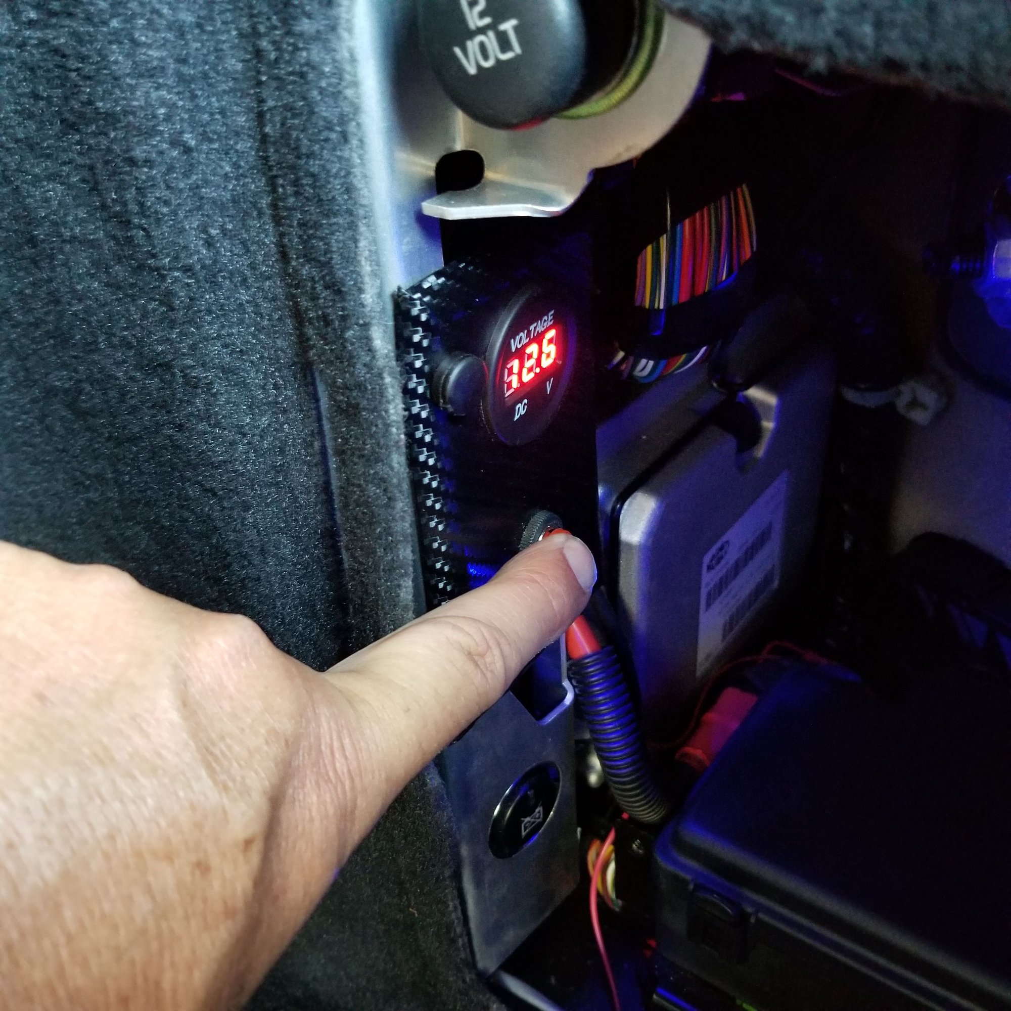

just a heads up... have the Ctek Battery conditioner... using the cigarette lighter adapter... found that the plug often doesn't seat properly into the rear outlet... had been plugged in for a week ana voltage was still just 12 volts...
fiddled around with it and plugged in in and out a few times until I'd finally made contact...
i installed a voltage meter in the rear compartment to check voltage easily... glad I did...

I’m not too thrilled with charging through there either and am contemplating running two charging lines directly from the battery to the trunk and behind the grill.
Please share more information on your small voltmeter and where you tapped into the electrical system.

I bought a cheap volt meter on amazon and tapped a large 12v wire going to the rear fuse compartment.
I also have a socket under the front grill, just for emergency... In case I cant get into the car. The one in the rear is convenient and works well. I can press a button any time to check the voltage and it doesnt modify the car in any way.
