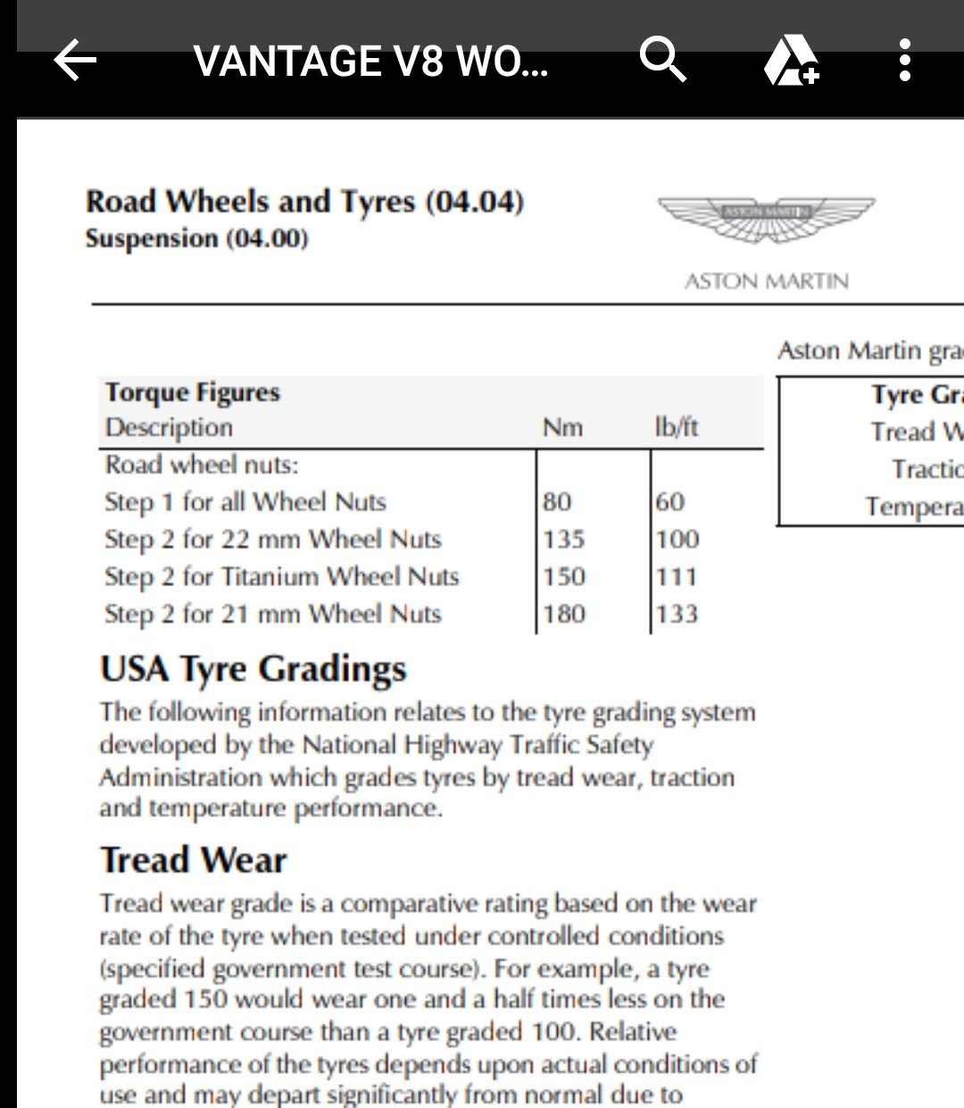

Quick question, though: I noticed in one of the posts you mentioned torquing the wheels to 80 ft-lbs. Are you under-torquing them because of the spacers?

Originally Posted by Kalepsis
Great play-by-play here, I'm hoping you post some photos when you get it all done.
For a 2010 I was under the impression that 80 ft-lbs was the spec.

80 ft-lbs seems very low, I usually put them at 130 ft-lbs and in most car I do 100-110 ft-lbs
​​​​​​https://www.sparkyexpress.ca/blogs/a...t-torque-chart
The Aston shop manual specifies a run-in torque of 60 ft-lbs, then a final torque of:
100 ft-lbs for 22mm lug nuts
111 ft-lbs for titanium nuts
133 ft-lbs for 21mm nuts
I was surprised they are so high (I have the 21mm ones), but the 2-piece design of the stock wheel nuts allows them to be gorilla-tightened while still easily removable when you need to do maintenance.

Is this doc year specific? I know the 2006-2007 ones were to be torqued to 135 but everything else I see on line states 80 for 2010.

2009 Owner Manual
Wheel Nut Torque
Tighten every second nut until all
five nuts are tightened.
Tighten all wheel nuts in two
stages.
1. To 60 lb. / ft. (80 Nm.) in one
continuous movement.
2. To 133 lb. / ft. (180 Nm.) in
one continuous movement.

It's also in the 2010 owners manual available for free download on the aston martin owners site. Right next to tire pressures...

Thanks guys looks like I got some tightening to do!
