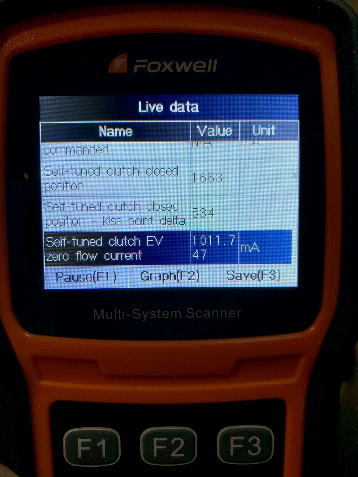

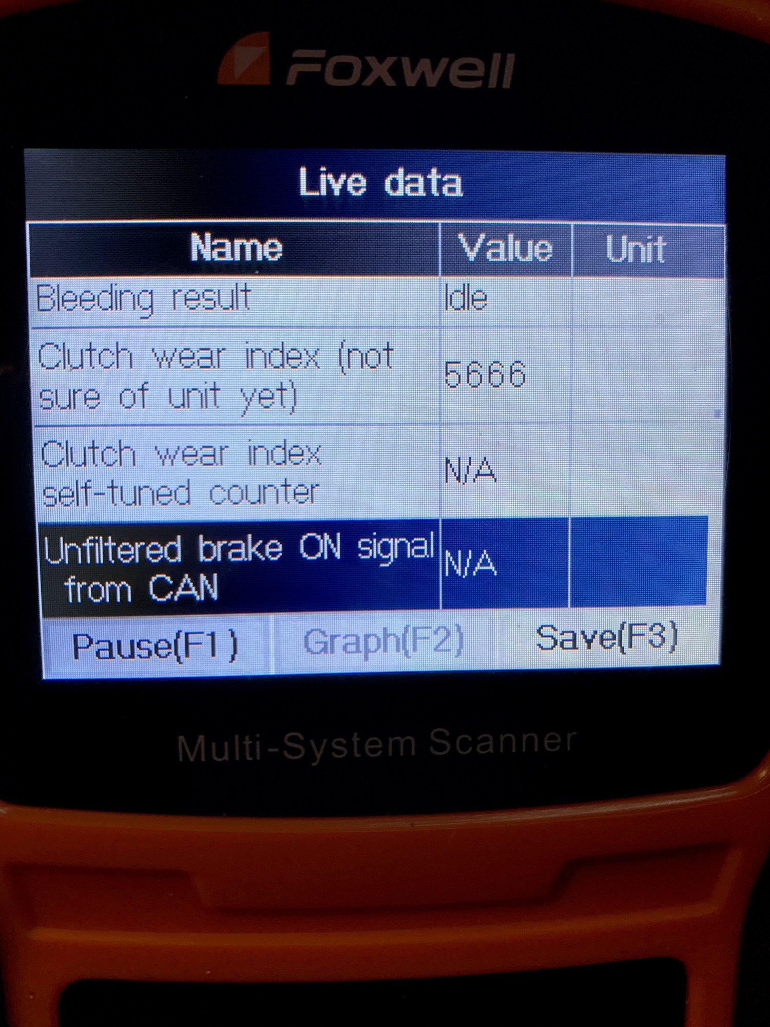

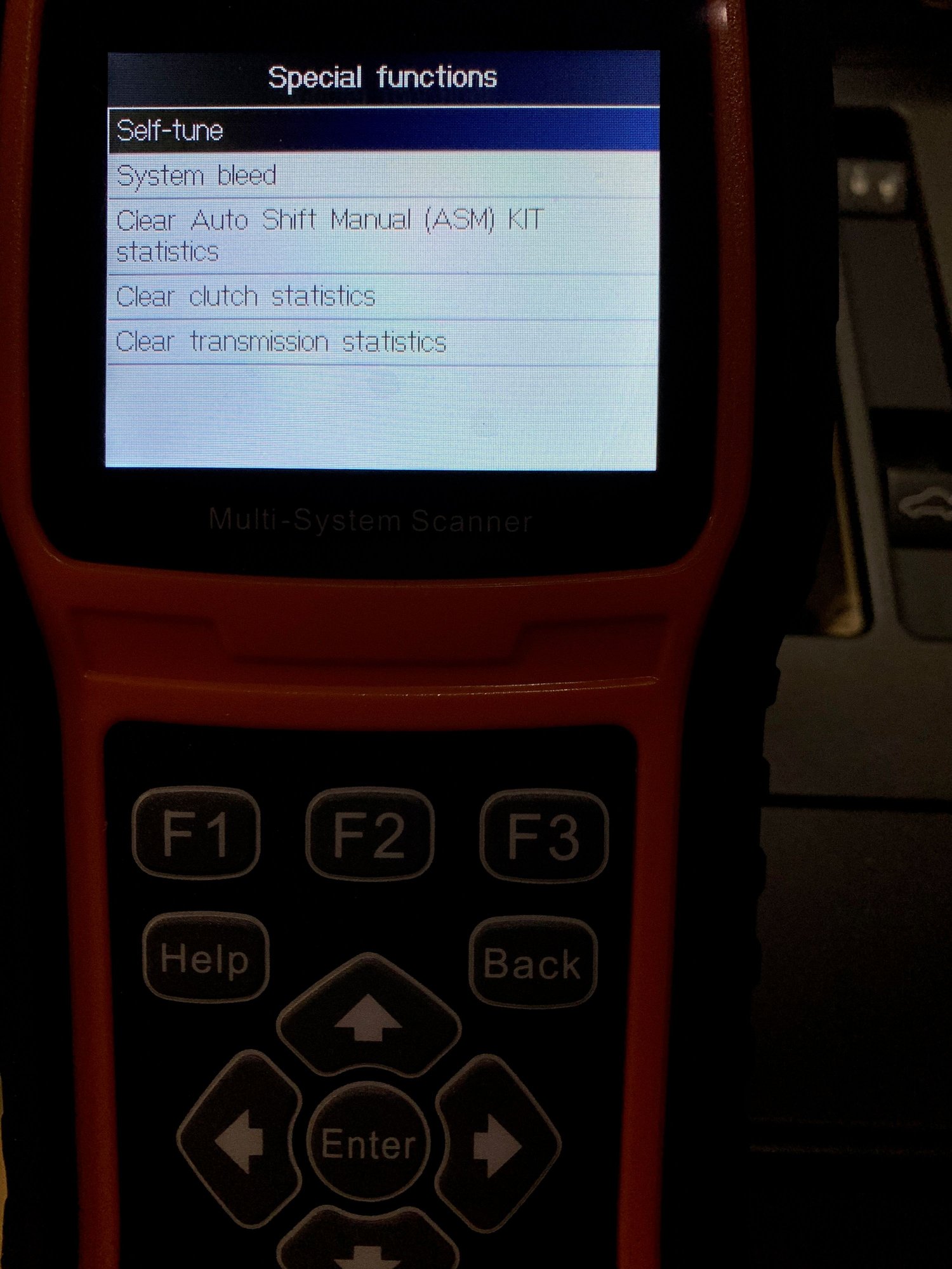

Ok... Looks like the NT530 does have a functions for "Self Tune", "System Bleed", "Clear ASM KIT Statistics", "Clear Clutch Statistics" and "Clear Transmission Statistics" in the Marelli Transmission Control Module --> Special Functions menu.
I have not tried any of these functions, but perhaps someone else has.
I did not see any function for erasing misfire correction factors.
There is also a set of recorded statistics that would be very interesting if I knew how to interpret them. Things like clutch kiss points and clutch wear indexes. No idea what the numbers mean though.
The functions in the Marelli Transmission Special Functions menu.
Numbers about the clutch kiss points. No idea how to interpret these.
"Clutch wear index" numbers. Again, no idea how to interpret these.

My 530 shows clear clutch statistics but will not actually do it. Will bleed but will not activate clutch either. This is on a 2009. Fox well has been unable to fix it
