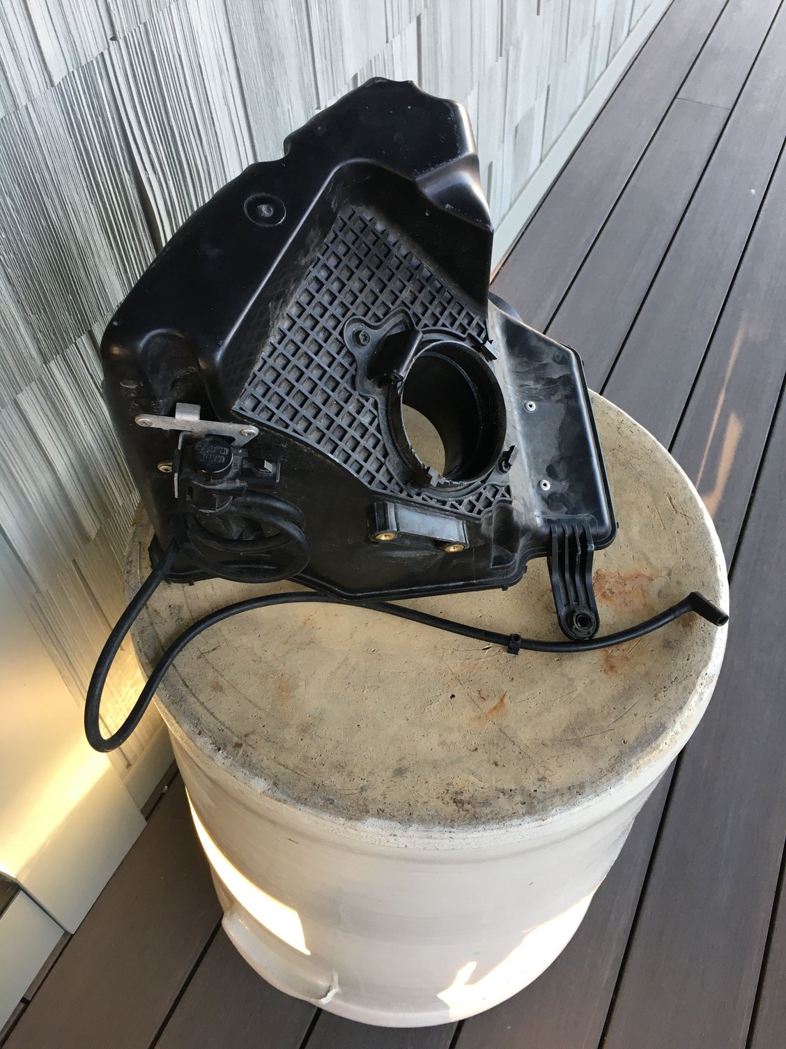

But when I watch the videos none of the say anything about all those 1/4 rubber air hoses going in to the box. Do you just close the off ? or leave them open? thanks

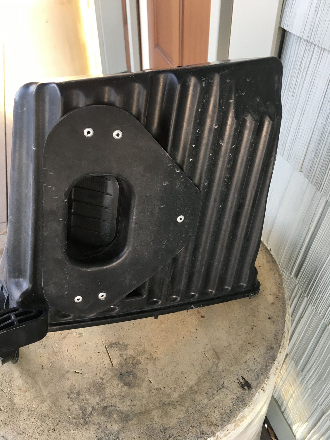

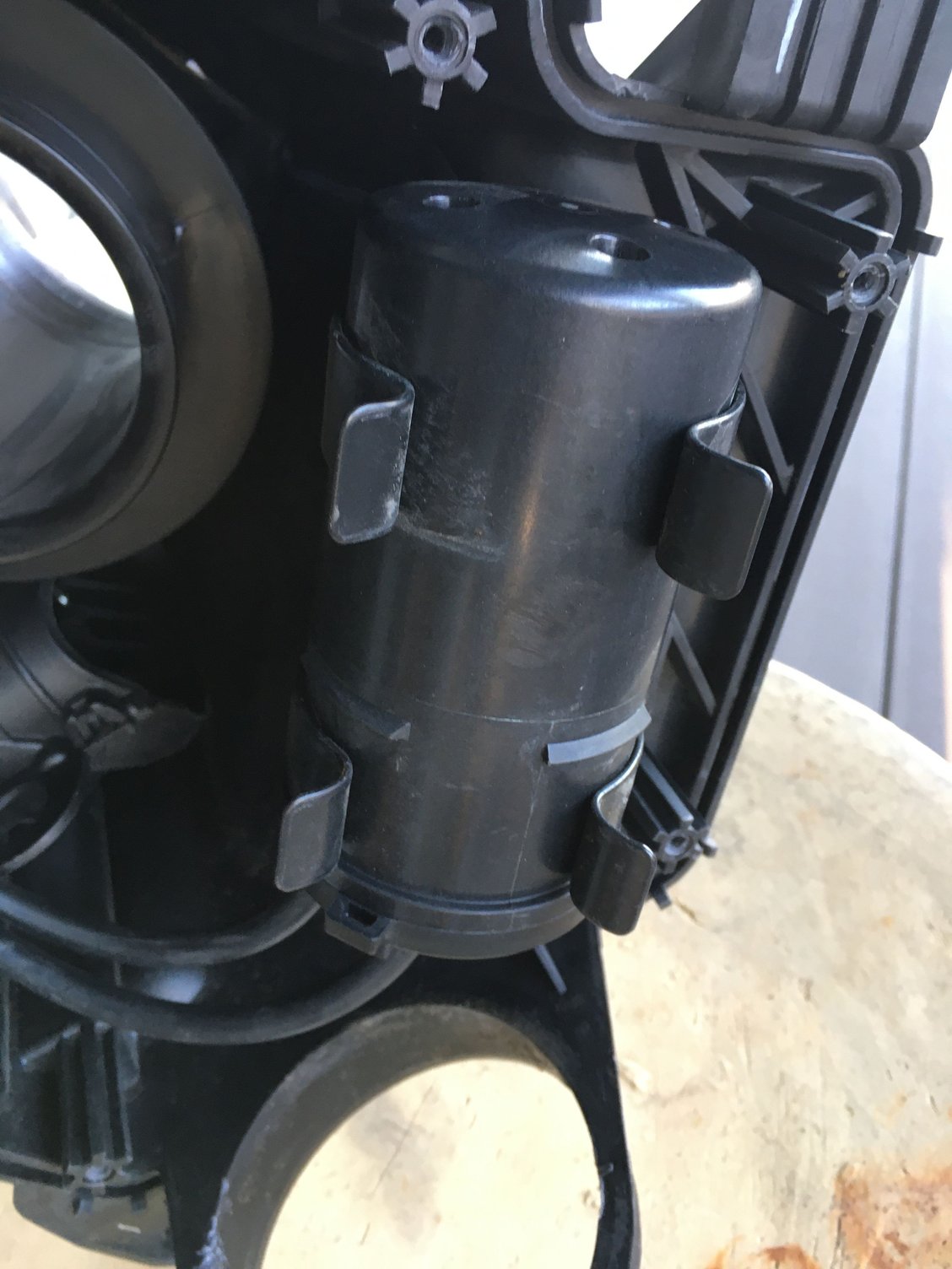

OK I HAVE TAKEN THE AIR BOX OUT , SO THE AIR HOSE STARTS AT A NIPPLE ON THE INTAKE JUST B4 THE THROTTLE BODY, THAN GOES TO A PLASTIC CYLINDER, 1 3/4" ROUND 4" LONG IN SIDE THE AIR BOX, THAN OUT THE CYLINDER UP TO ELECTRICAL SWITCH, THE HOSE THAN GOES TO A VACUME ACTUATOR THE OPENS A SMALL FLAP ON THE SIDE OF THE AIR BOX TO LET IN MORE AIR, WILL TRY TOM LAD PICS

From an air flow direction point of view you must mean after the throttle body.
If you are removing the air box then you will need to cap the ports where the hoses were previously attached else there will be a vacuum leak and you’ll have problems.

That's what i did , i blocked the port after the throttle body where a hose from the air was attached, thanks.
