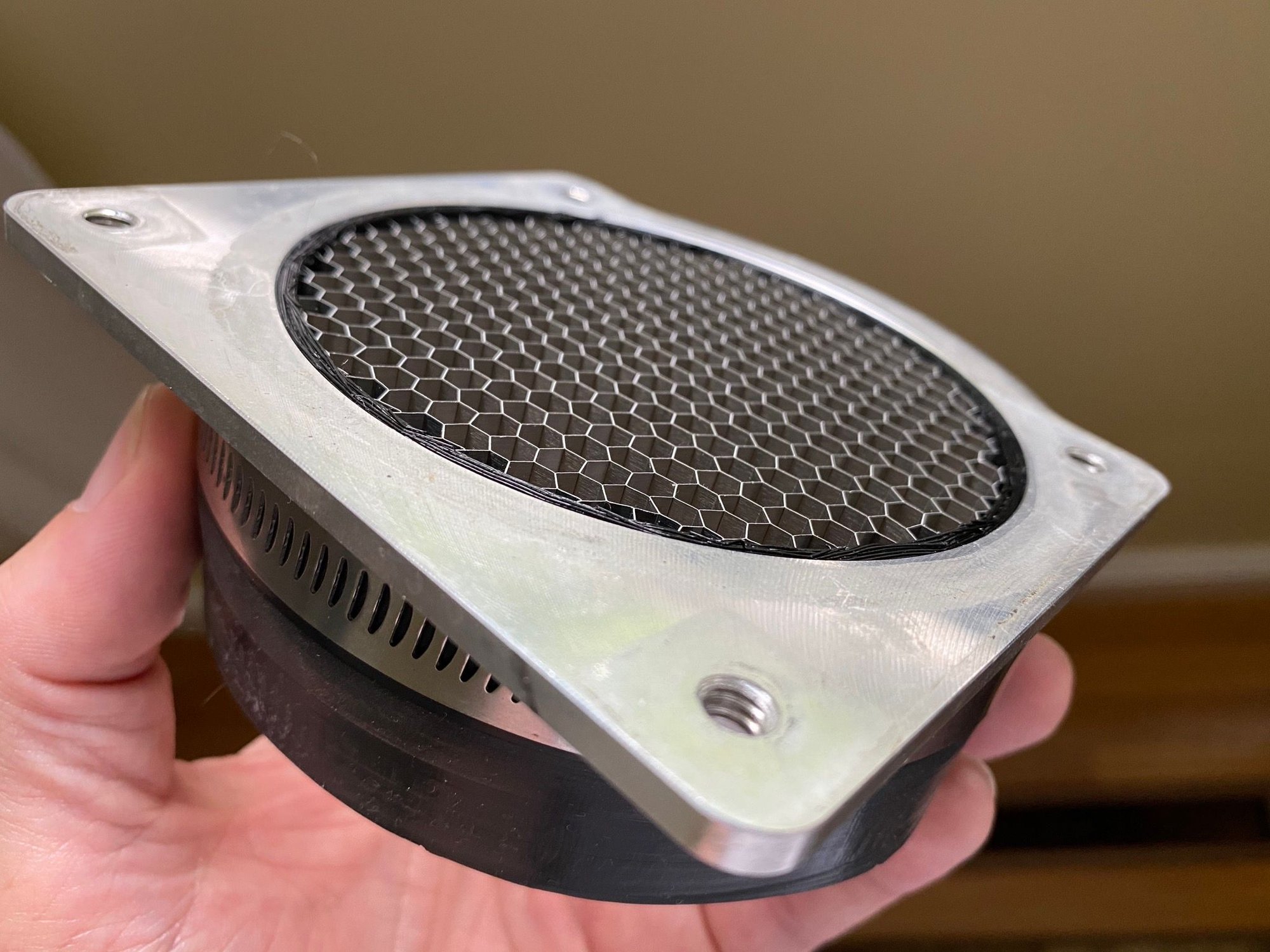

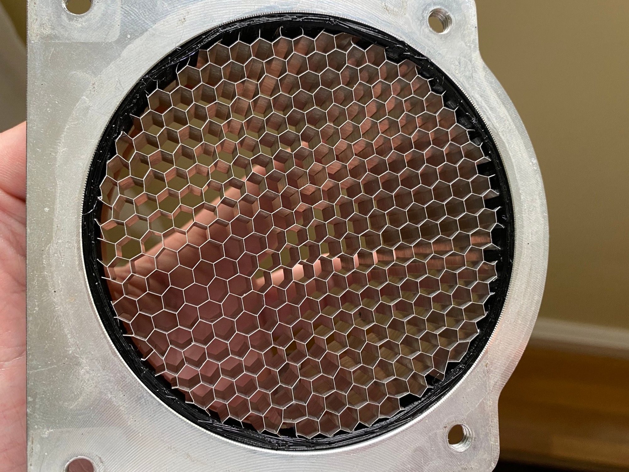

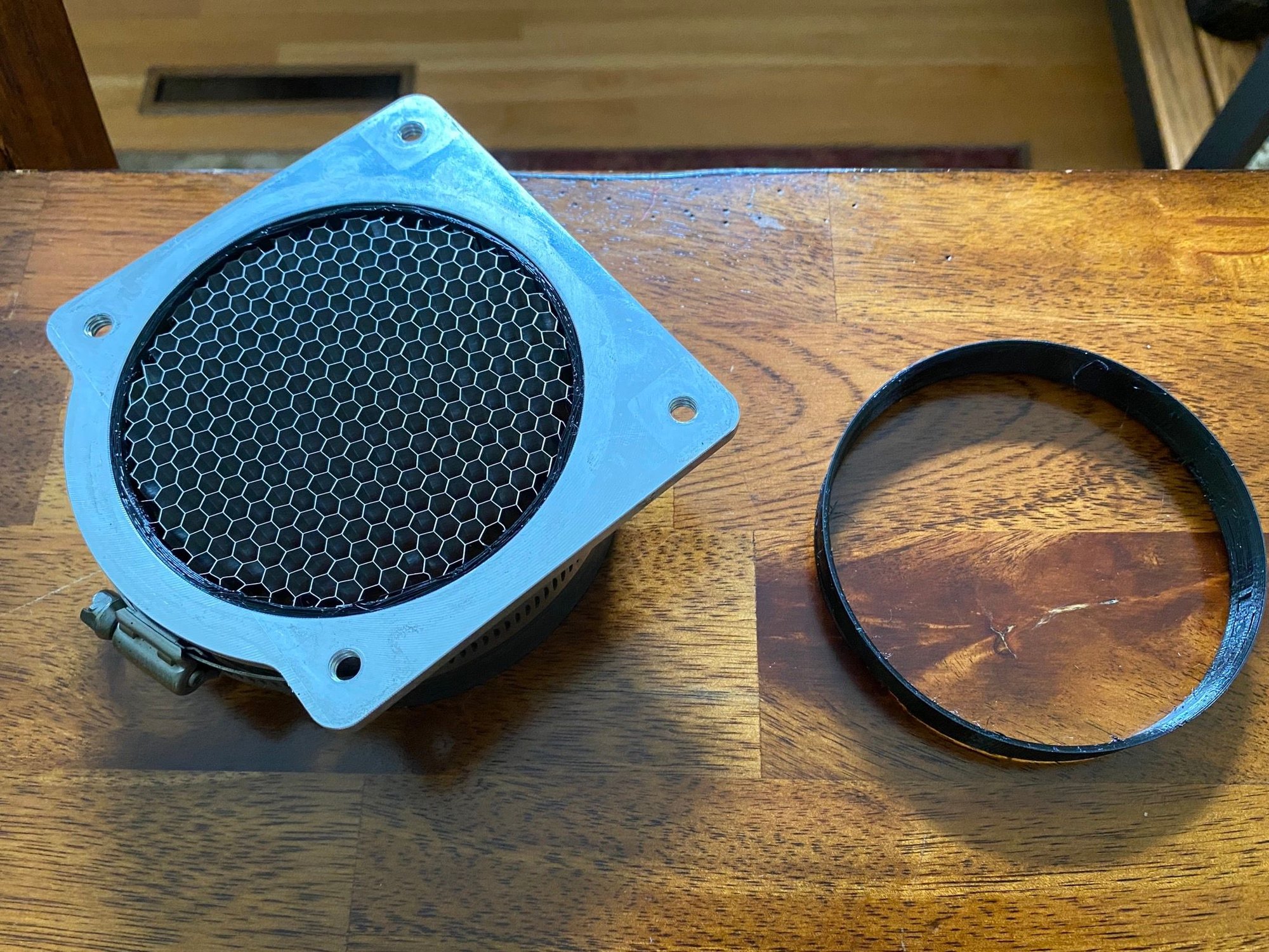

Btw, I forgot to take pictures of this setup on my V12V while I was doing the install. But, I decided to use the same air straightener on my supercharged Factory5 Cobra—and took a couple pics to give you an idea of how I installed it—pretty much exactly the same as on my V12V.
I 3D printed an “install ring”—dimensions are such that it’s a tight tolerance fit for the honeycomb AND the intake housing. Just press fit with no other securing needed.
Here you can see a spare ring i printed in the picture below:

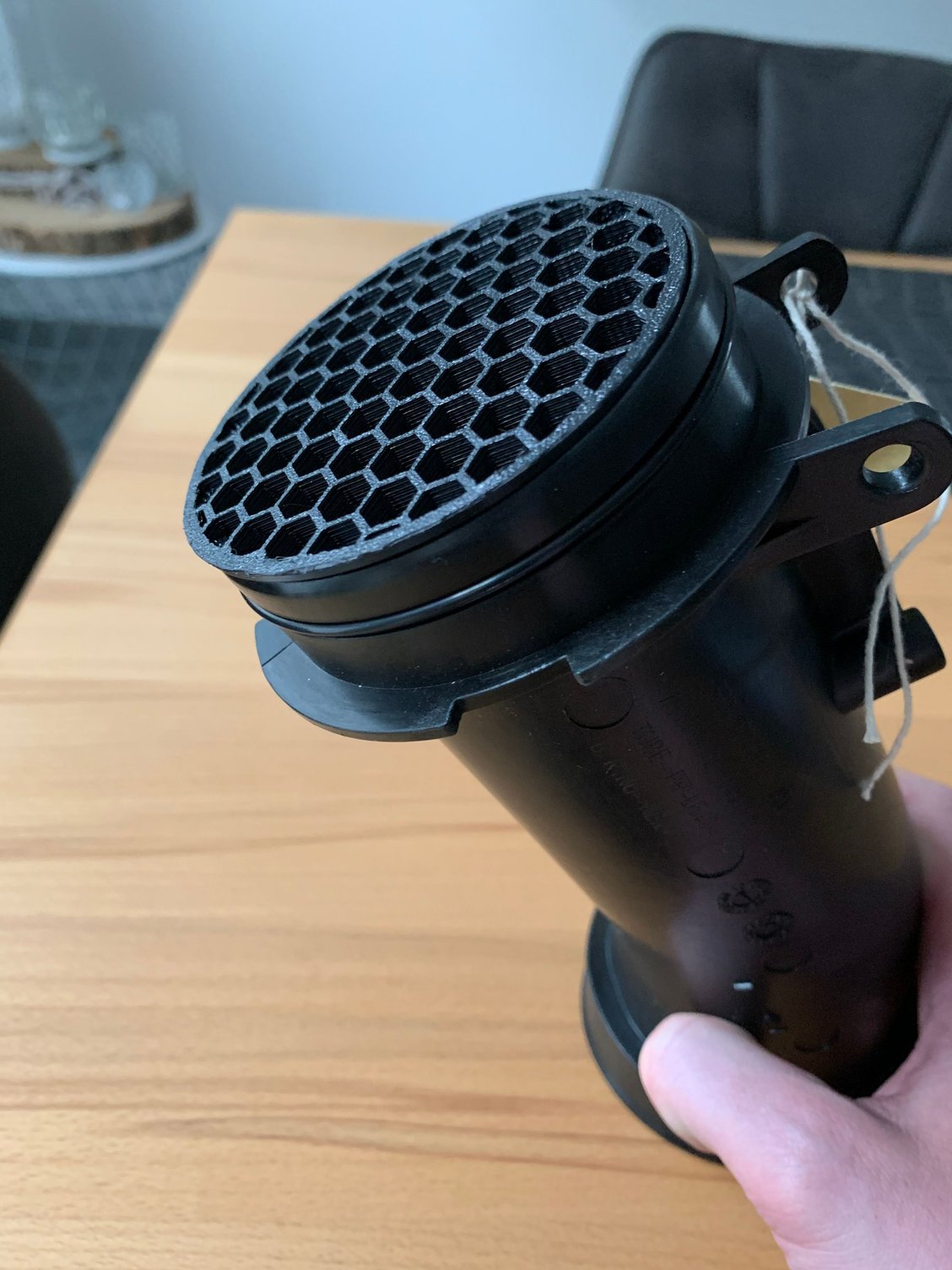

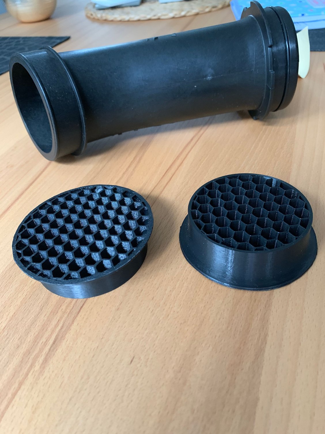

After I read your report, I went with a fully 3D printed air straightener made from Polycarbonate. Mesh Diameter is 7.5 mm. LTFT normalized after an evening ride on the highway and: no check Engine light! This seems to be the solution for P0171/P0174 faults on cars with Airbox Delete. Let’s see what happens during the next drives.
Pictures attached.
