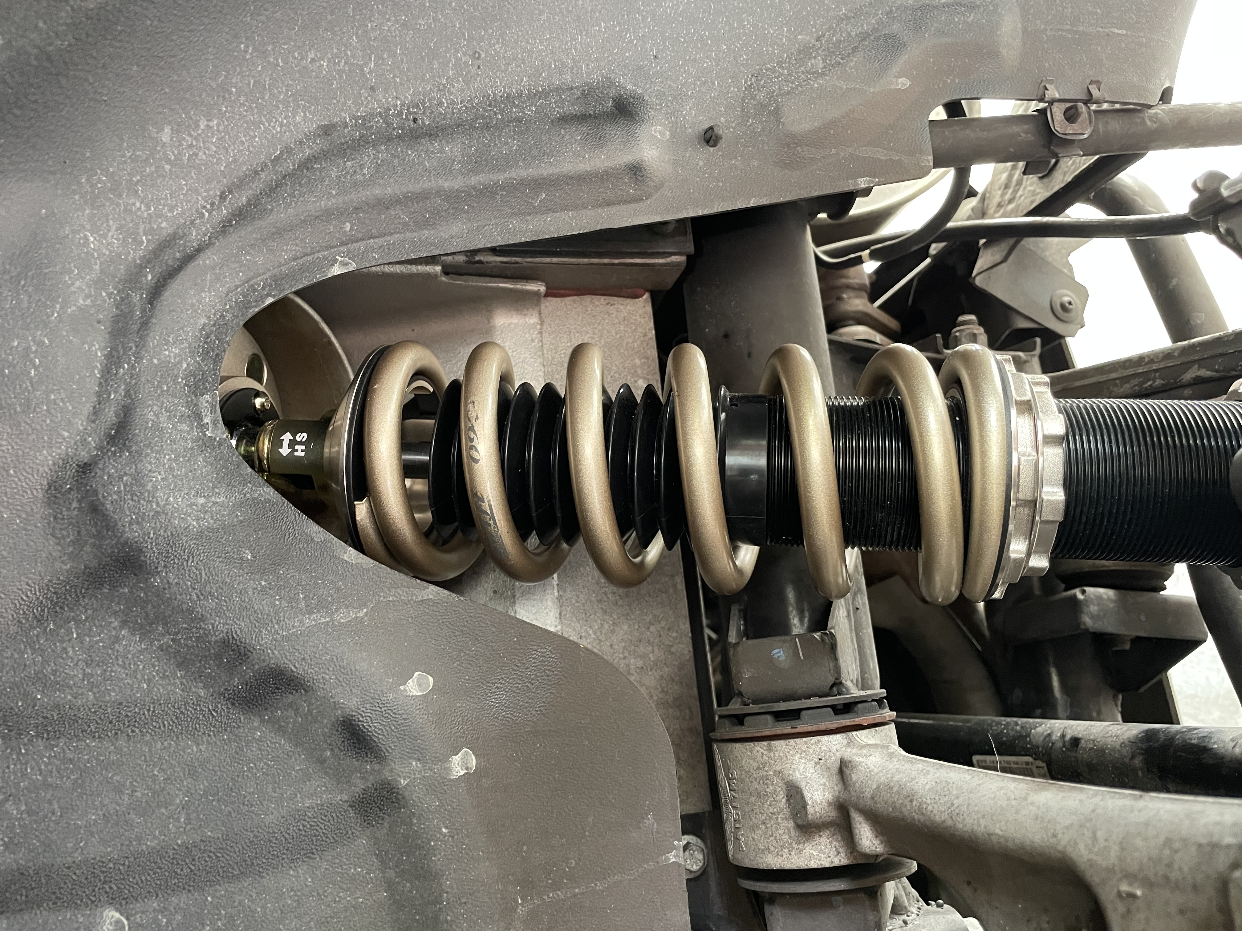

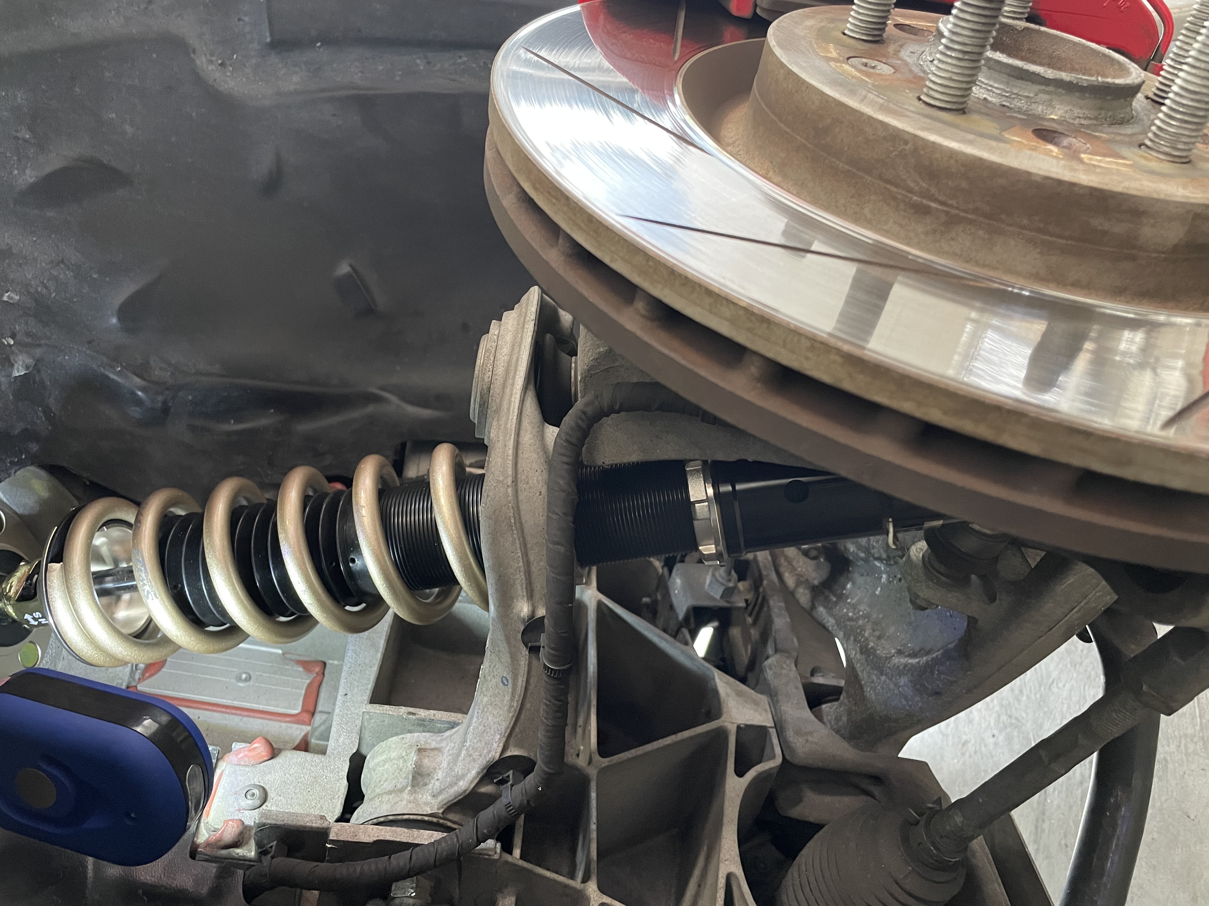

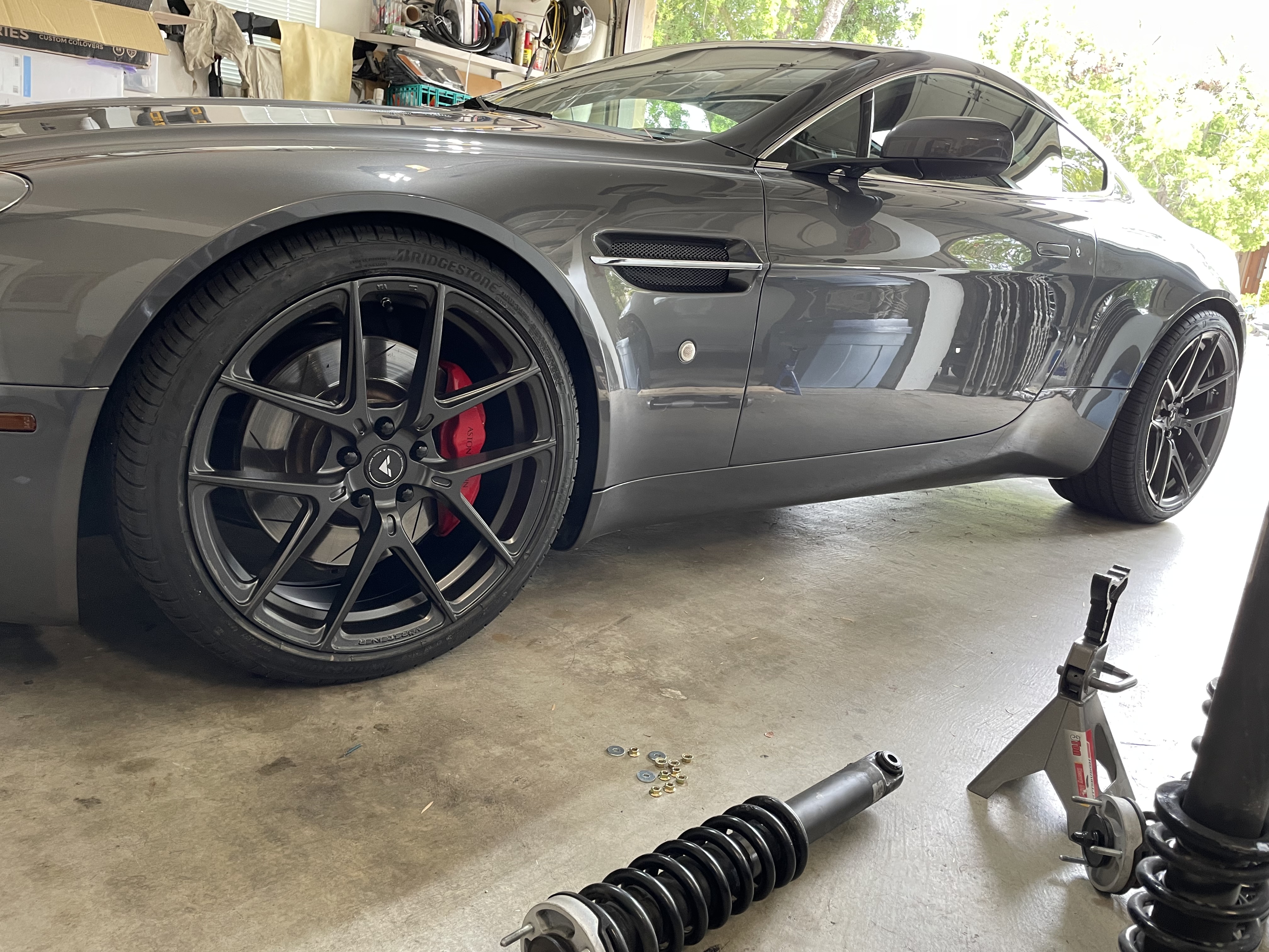

I just fitted BC Racing Coilovers with Swift springs to my 06 V8V and they are available for 05-17 Vantage here. https://shop.bcracing-na.com/product...19636165771352
Unless the design of the V12 is significantly different, you may want to give them a call. (I am a newbie to the AM world, so excuse the ignorance if they are different).

The spring rates have to be different. I have asked BC before.
I could be wrong but was ADS available on 2015 to 2017 V8 Vantages? That's the system I am worried about. Even Nitron doesn't have an answer how to "delete" the system with their kit. Driving around with a warning light can be annoying.

Got it, BC has a plethora of spring rates, that could work, but ADS is a whole nother story.
