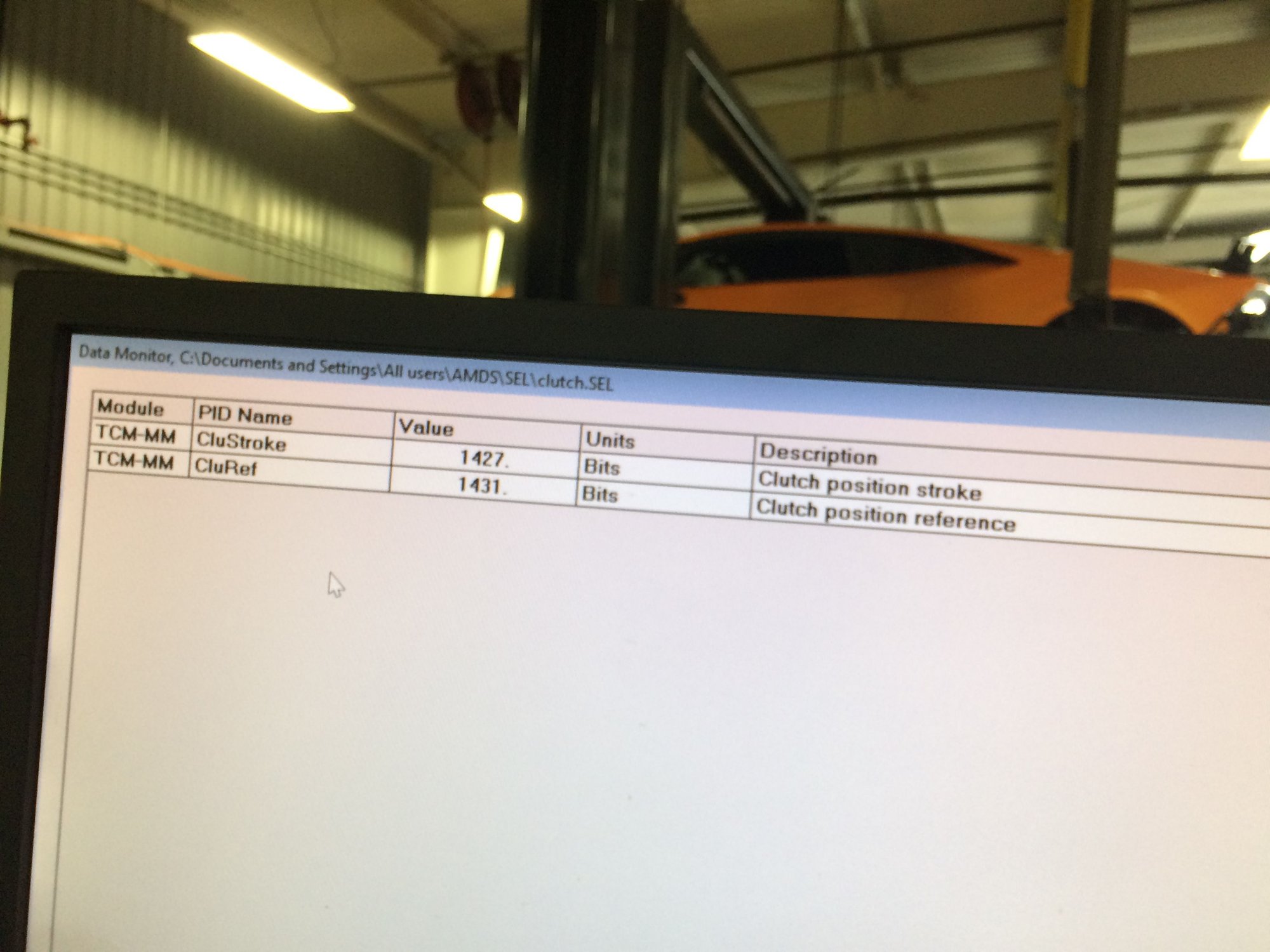

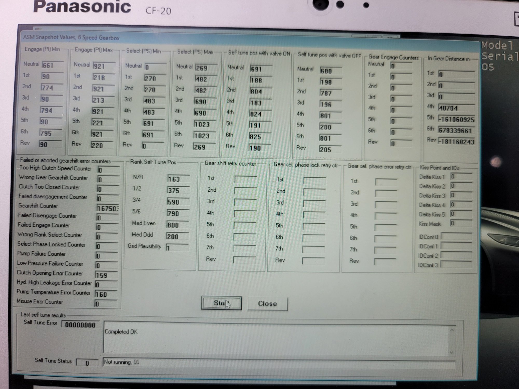

I purchased a 2009 V8 Vantage Sportshift from Aston Martin San Diego - below is the clutch readings - anyone know if these reading are good, bad, or ugly?

There is no clutch measurement on any of those 2 screens. 2nd screen is hyd. Pressure. First screen is shift counts. Looks like they are trying to baffle you with bull$41T. Ask them for the BIT count reading should be a number between 1300-1900. If they didn't look beforehand and have shipped the car someone else is going to have to read the value.

get something like this..
this is my understating as well. I had a similar reading when I replace my clutch...I think mine was 1350 to 1325... after clutch replacement the spread was almost 600 points
