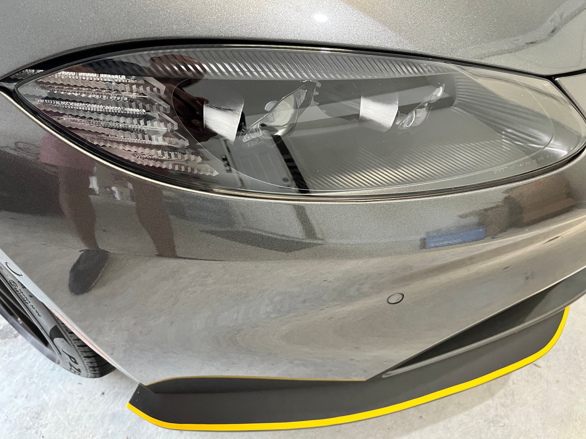

Are headlights manually adjusted or is software required. Instructions appear to require headlight removal before bumper. Directions say to reverse instructions to install bumper. Did you in fact install and adjust headlights prior to placing new bumper cover in position?

No software required. When you hang your new bumper, you have to align the fwd/aft and high/low of the headlamps and how they sit even and flush when you close the hood. If you tighten the bumper down and then hang your lights, if the headlamp isnt centered like OEM, it will either stick too far out or you will see those gaps around the headlamp. The headlamps have these double stud adjuster that if you're not paying attention, you will srew them out too far tilting the headlamp downward.
you want to make sure your lamps have even gaps all the way around and doesn't stick out too far. Flush with the hood and bumper.

MY kit arrived today. Using your photo to check out parts shipment then the work begins. Thanks for being so helpful. I printed your instructions, any special knowlege on removing headlights. Don't want to miss or malign anything.

Hope this helps! Make sure when you move the parking sensors over they click in place.
