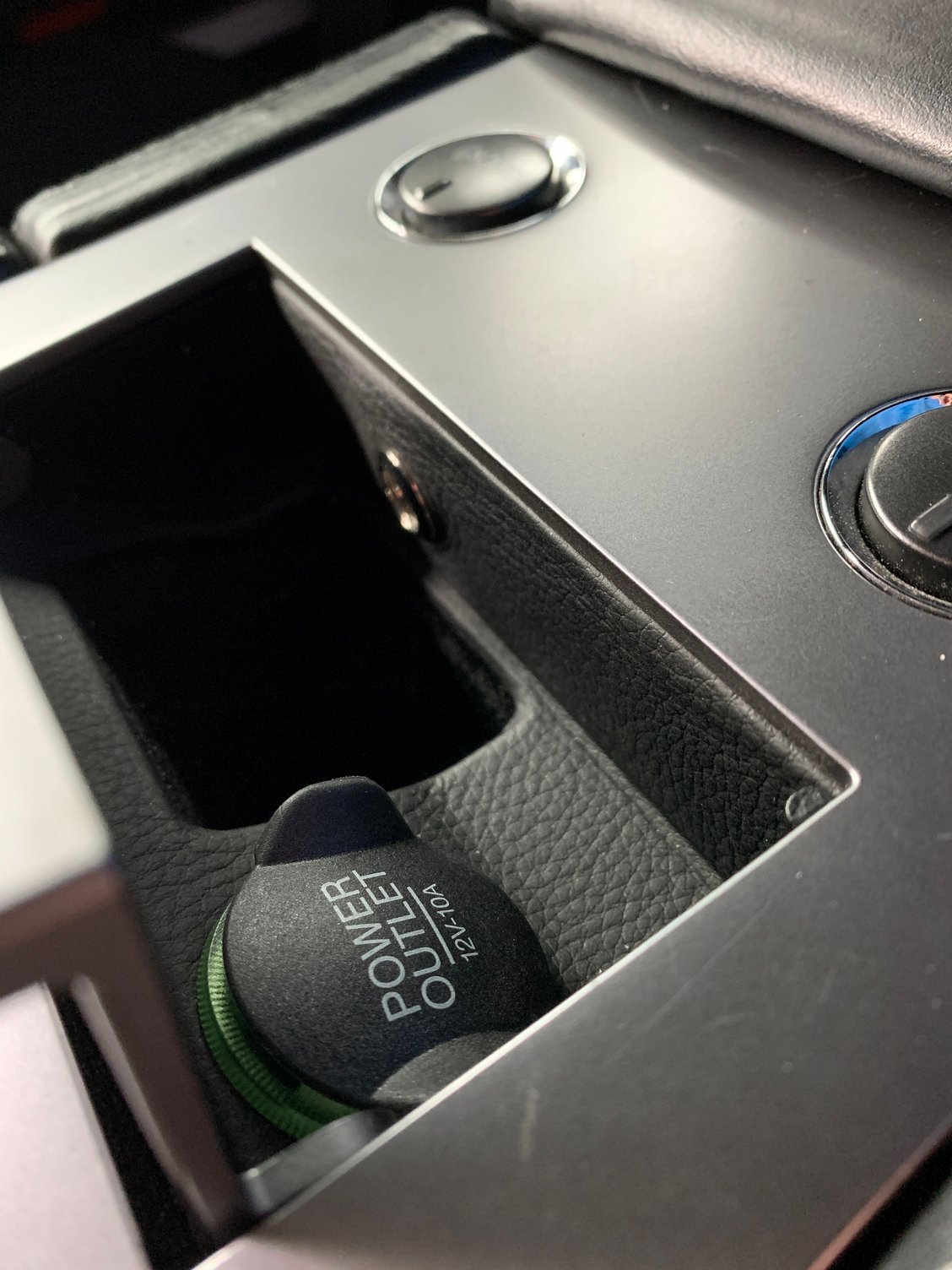

I have Mr. 12volt installed in my early production (no. 1799) 2005 DB-9 with the 950 watt Linn system. I use it for Bluetooth audio streaming and, via the analog aux input, to hook an old aftermarket Sirius XM receiver into the Linn. The sound quality is quite good and it’s definitely an upgrade over the stock system. However, it’s operation includes some irritating idiosyncrasies, the most prevalent being its refusal to stay connected with the Volvo-sourced MOST fiber optic infotainment network.
  1. The installation instructions say it is “critical” to connect to an unswitched (continuous) power source. It’s not critical. In fact it’s useless as it neither causes nor solves the MOST disconnection problem. Within a few minutes of switching the ignition off, pretty much the entire CEM fuse panel (passenger footwell) powers down. Only the primary input fuses (40-60 amp) are permanently powered. I tapped into one of those to power the Mr. 12v and it’s made no difference.
  2. The “erratic” nature of the connection is actually quite predictable. Once the MOST network powers down, the connection is lost until the Mr. 12v is reset, which is done by switching the power to the Mr. 12v off and then back on. The MOST doesn’t switch on and off with the stereo. On my DB-9 it powers down after a couple of minutes, at the same time as the courtesy lights. So if I turn the car off and then back on again, the MOST and Mr. 12v stay connected. Wait too long, and the connection disappears.
  3. To reliably restore communication, the Mr. 12v has to be reset AFTER the MOST has powered back up. If Mr.12v is just left on, the display appears to show a connection but there is no sound. With my car the sequence is start the car, turn on the stereo (if not on already), and then reset Mr. 12v. After a few seconds the music starts playing.
  4. To conveniently reset Mr. 12v I installed a small button switch inside the power port cubby in the center console (see pic).
This is exactly my experience with the Mr12v bluetooth unit and why it is no longer installed.
