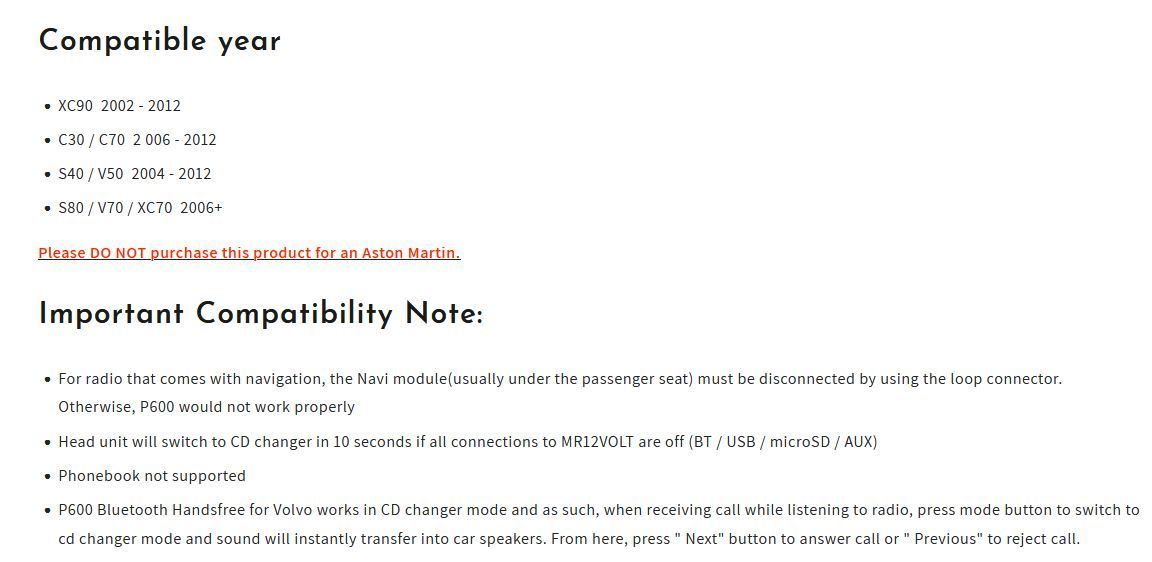

Not to revive this, but I was looking for the DIP switch combination for the 07 Vantage when I install this Bluetooth adapter. I have it, I just haven't installed it. I went to the Mr12volt site and noticed this. Any ideas?

I asked their customer service department about the compatibility note on their website and received the following reply:
"I'm afraid we have stopped advertising this product as it would work on Aston Martin.
Although the radio is identical with the one on Volvo but somehow the coding used were different, and it is very unstable to be used on an Aston Martin."

Weird. I guess the worst case is I remove it if it doesn't work. Does anyone know the correct DIP switches to engage for it function? I can't seem to find it.
