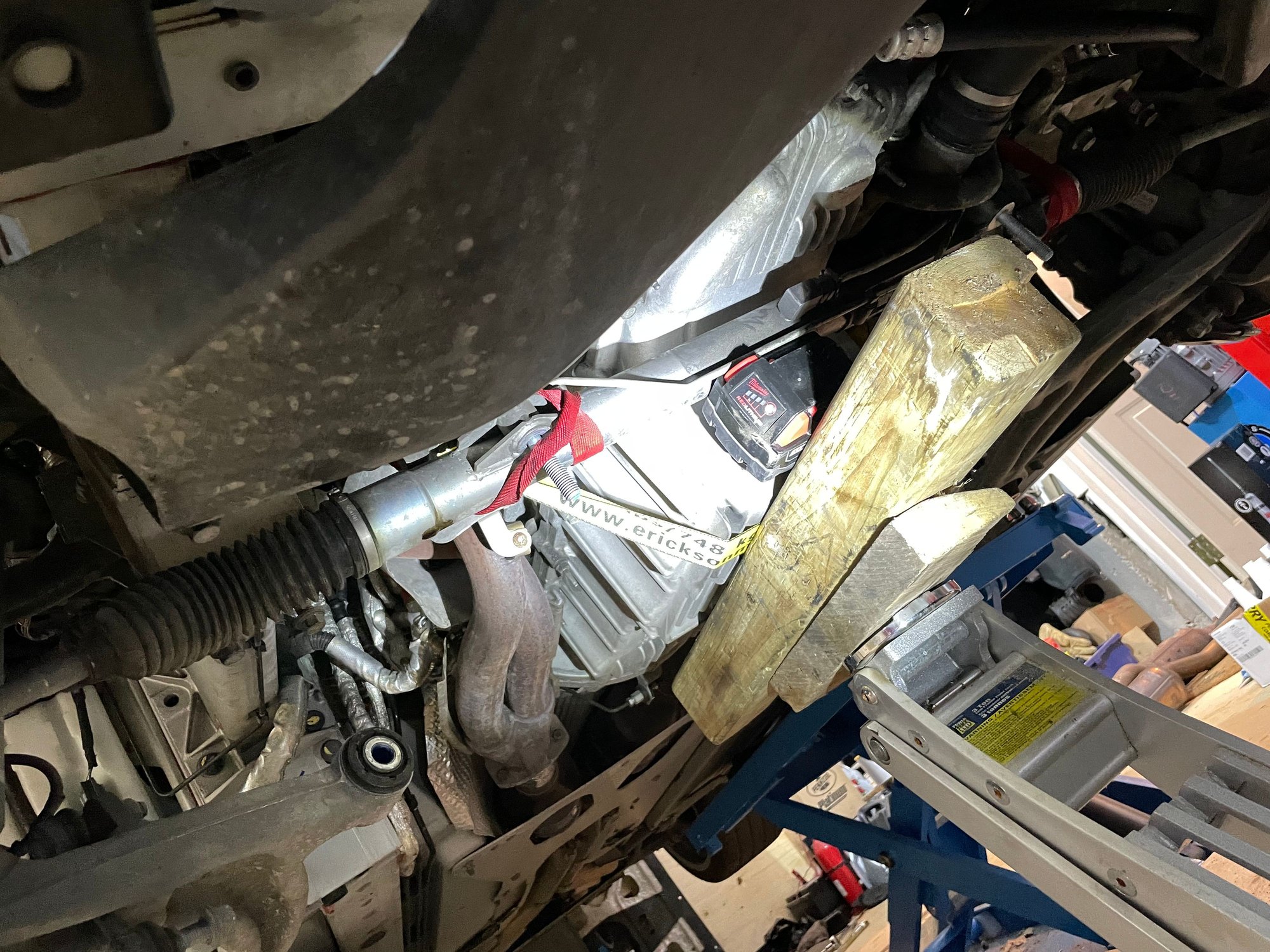

I’ve been at it slowly most of the winter but now with snow melting away the V12 fever is very much here. I’ll try to share pictures as it goes but feel free to ask questions and for specific pictures. If you see I’m doing something wrong please let me know. This is 100% DIY and in a small garage. These 1st pics are with subframe removed.

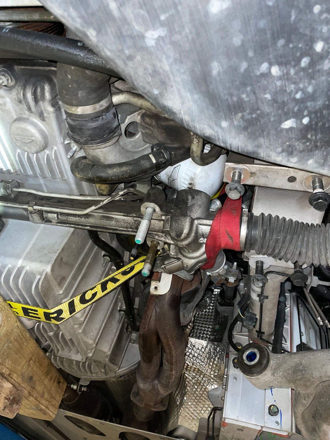

M18 new application, hold the steering rack in place, temporarily.

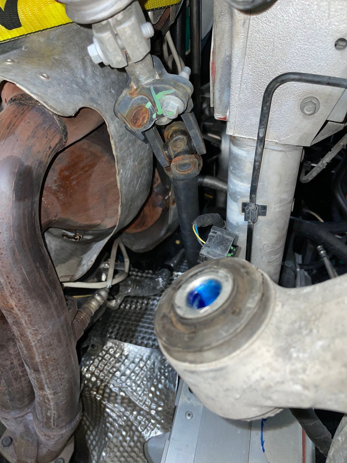

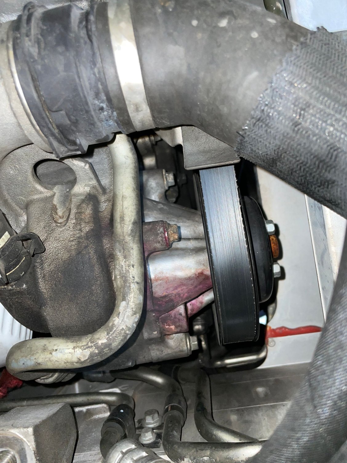

There are signs of water pump leak but it does not seems to have leaked recently. Debating to change it or not. Anyone with an opinion?

Water pump rarely fix them self over time.

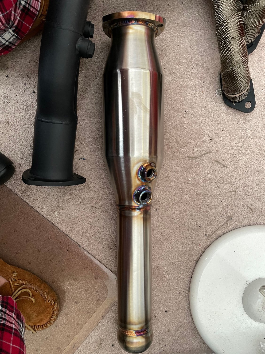

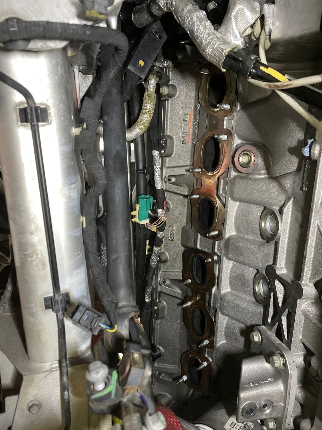

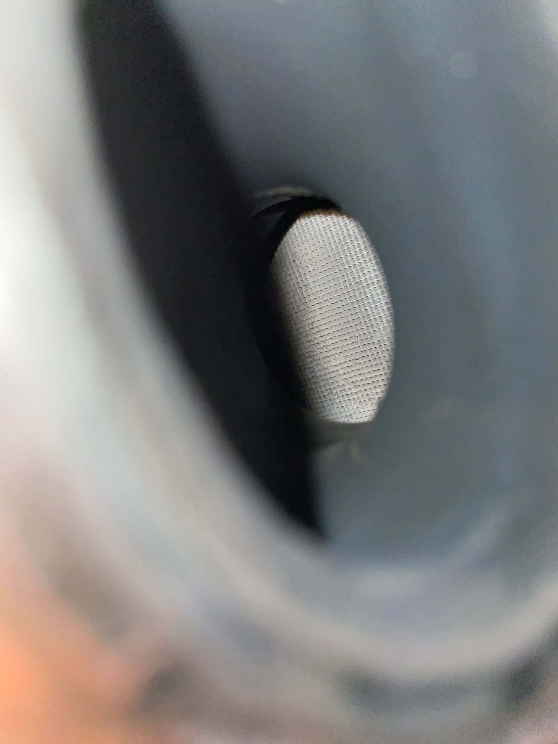

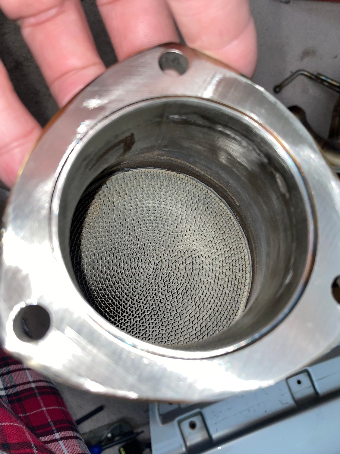

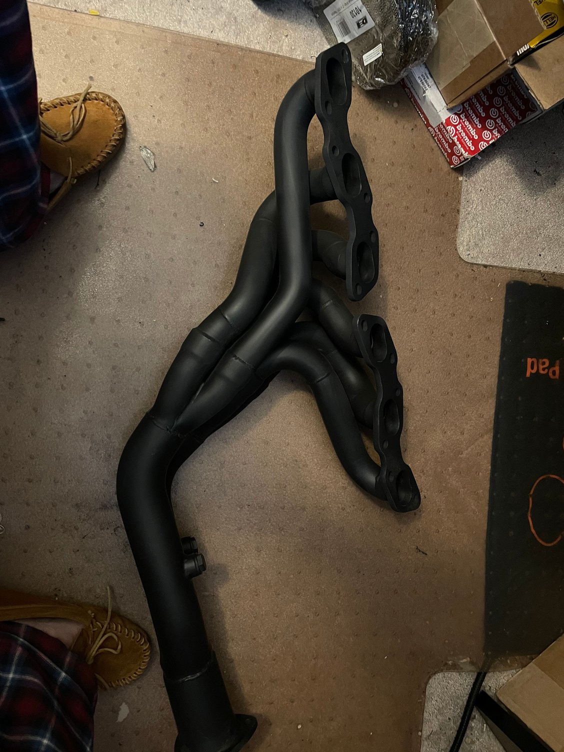

both OEM manifold/cats off.
OEM cats don’t look too bad, absolutely no “pieces” missing except normal surface erosion (70000km). Very happy.
Got right side new header back in with the new 200 cat, might do left side this weekend.
This DIY is crazy fun….! Until something goes sideways. Touching wood.

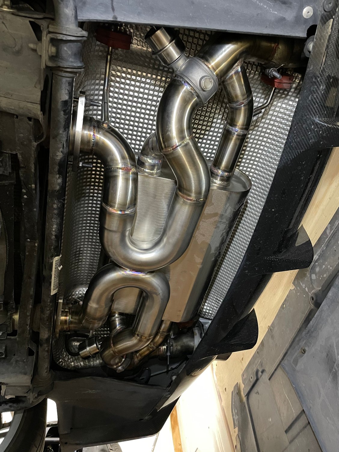

That’s the muffler going in, with valves and the remote control for the valve.

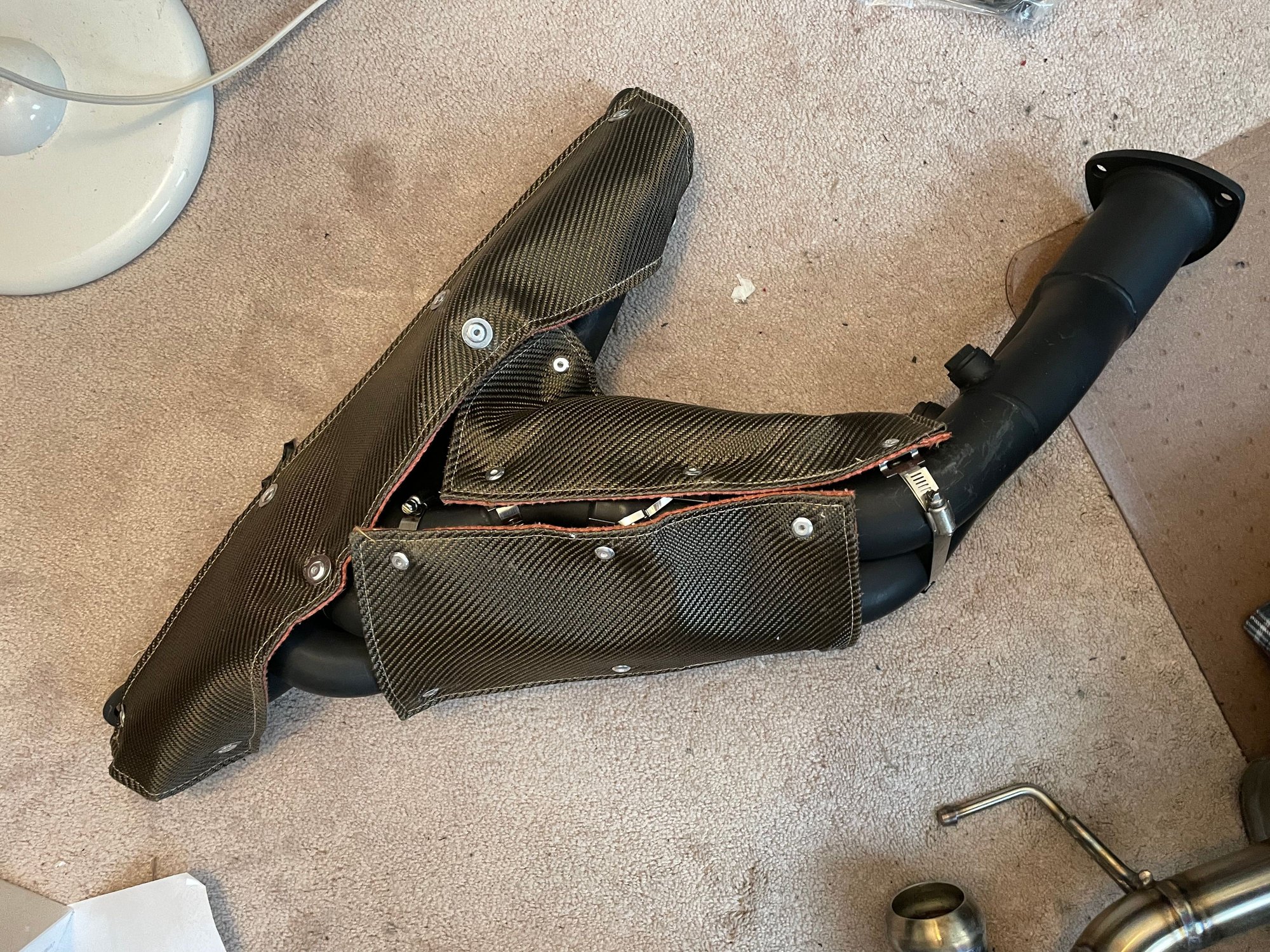

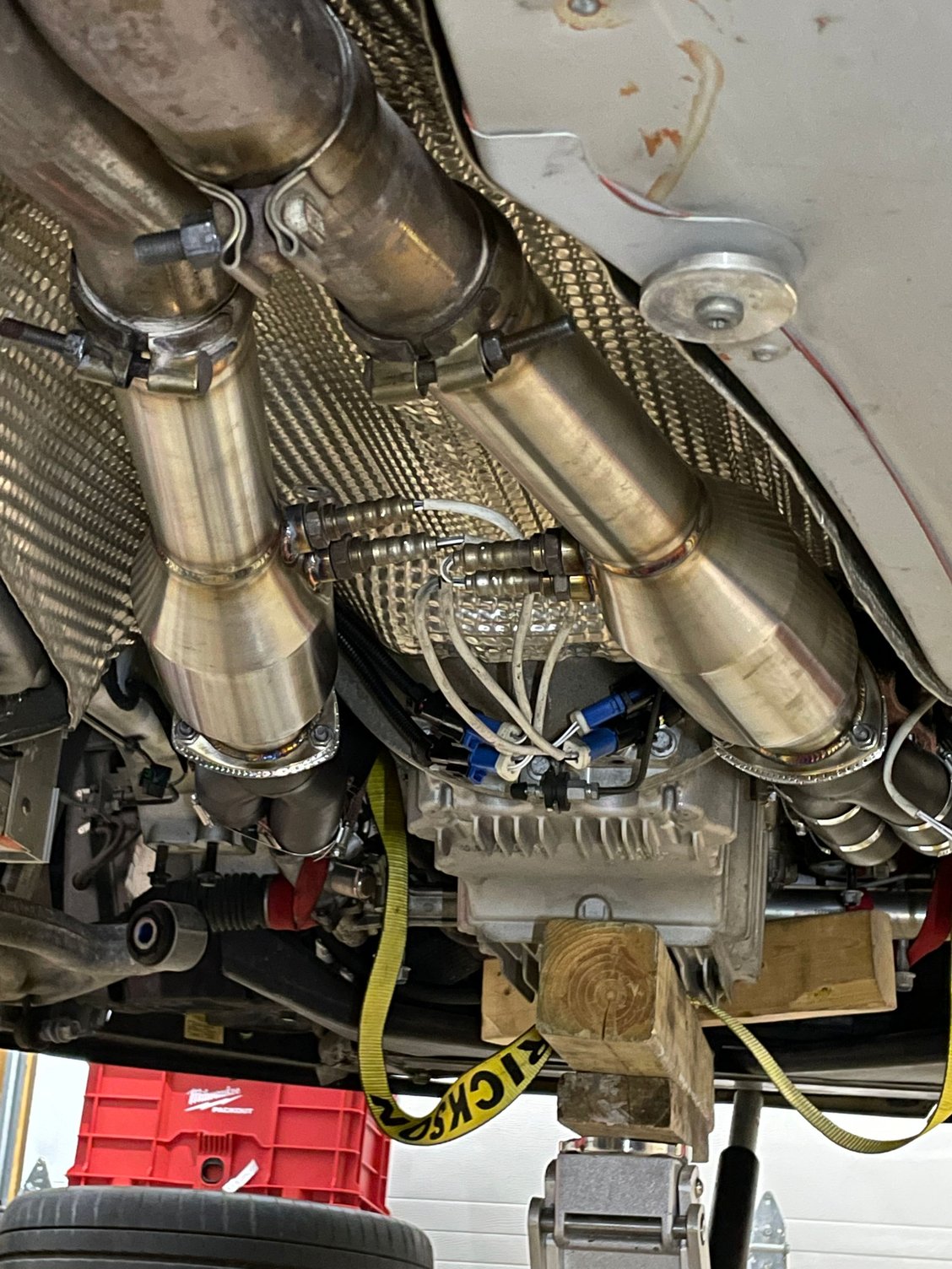

This pic might raised some concerns from some people. I tried the classic wrap first but I did not like the results and it might run the header pipes too hot. So I’m trying these blankets to help shield the heat a bit. Will see how the heat looks with a Flir and I might take them off.

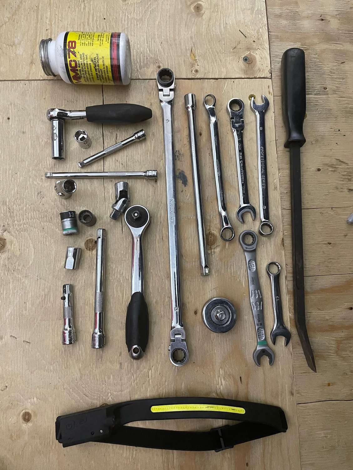

The weapon collection for headers install.

O2 sensor wires need some heat shielding and securing but the mid-rear is done. Next is to review everything, get the subframe back in, oil change and a few service catchup. And battery reconnect with associated procedures and finally ECU update for the power pack. The sound clip will eventually show up.
