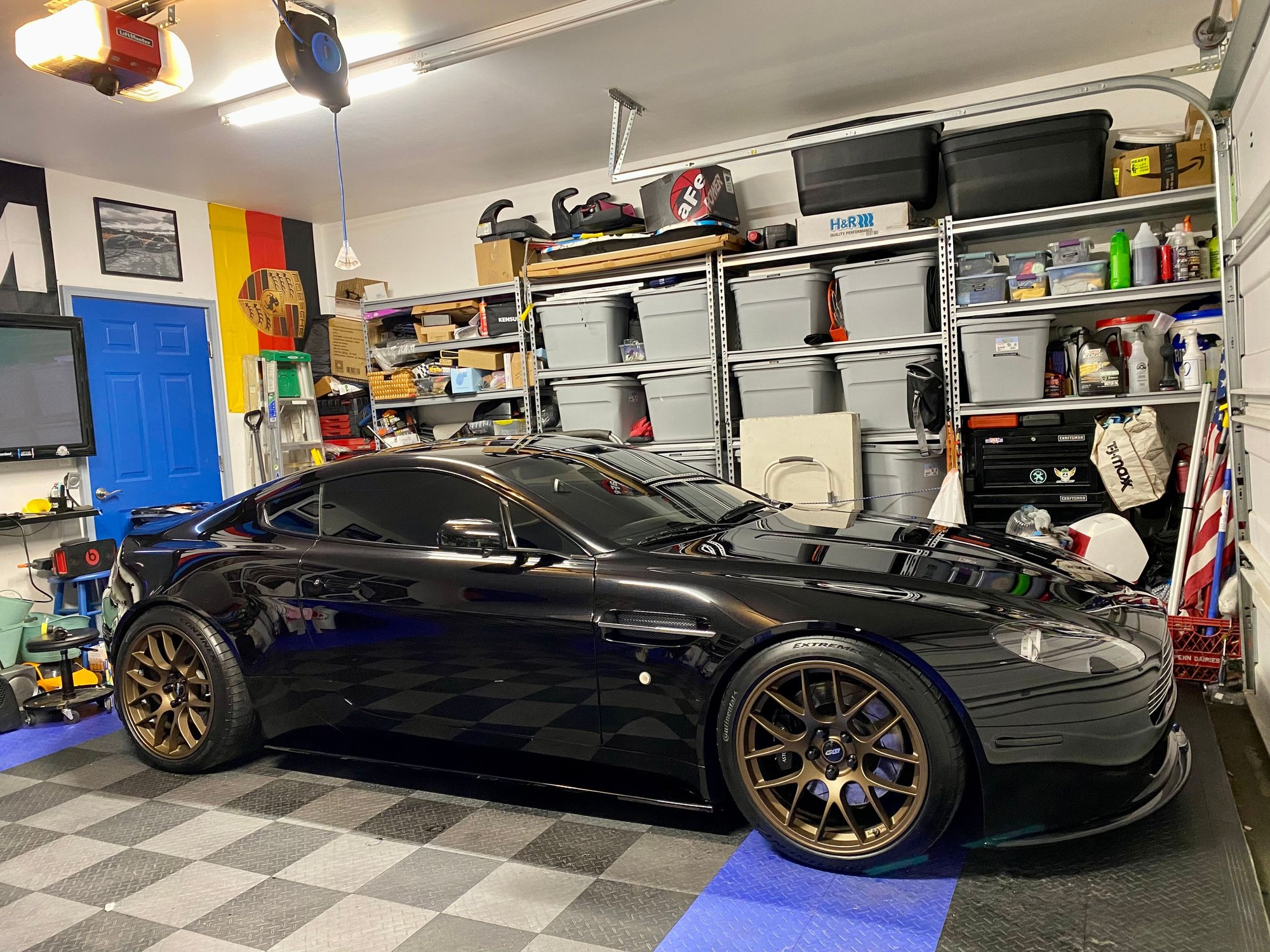

Hello all,
I’ve owned my ‘07 Vantage V8 w/ about 35k miles for about 2-3 months and there’s an issue that I’ve been having ever since I got the car.
Upon cold start, the car fires right up with no issues. If you shut it off and start it within about 5-10 minutes, it will also start up but not as quickly. If the car sits somewhere between 20 mins - 3 hours, it takes a while to start it up but it eventually starts and it struggles for a bit but then idles fine.
Usually after this happens I smell fuel.
Has anyone else experienced this? Trying to figure out what it could be.
