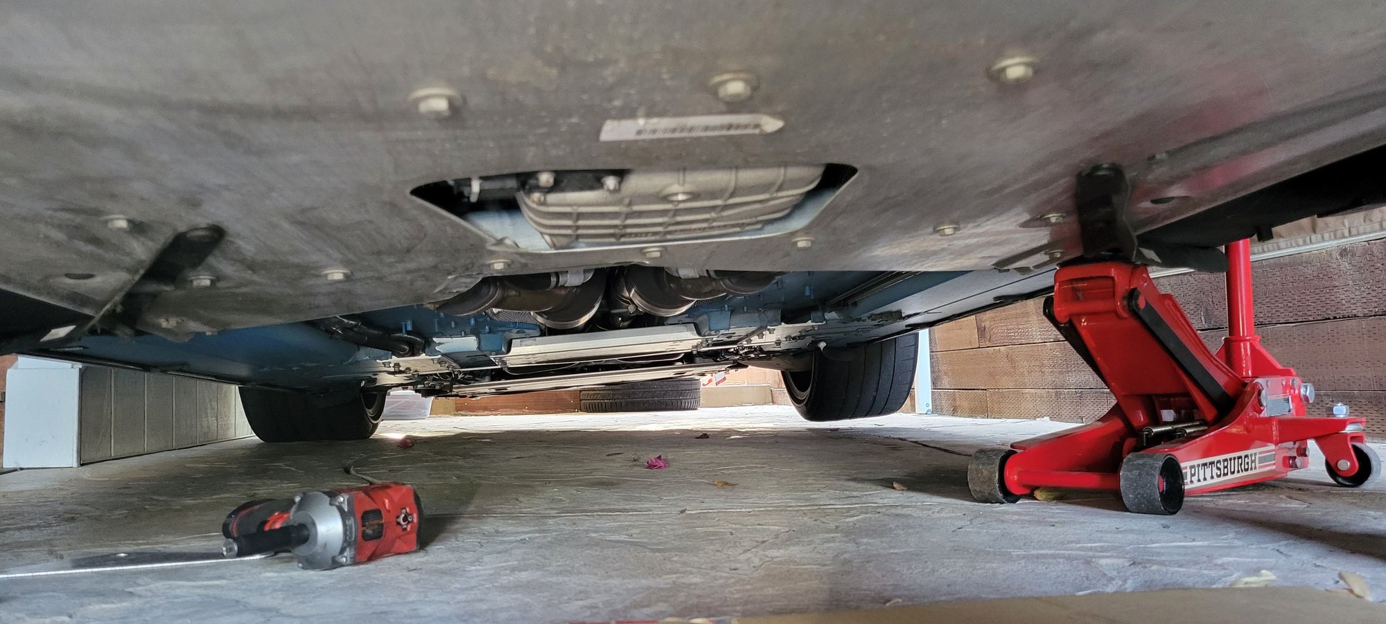

Just did it yesterday. Jack up driver side front. T40 torx for drain plug. 24mm socket for filter. Remove 3 bolts behind the cutout of the oil pan to get to filter. 3 bolts remove a triangle shaped cover that protects oil filter. Filter # E155hd122
9 Liters of motul 8100 0w40. Take pictures to keep warranty clear.

I have a 2019 MY. There was no obstruction for me to access the oil filter, so no need to remove three bolts or any cover. I’ll have to go back and look to see if it was removed and not replaced in a previous oil change or perhaps the design was changed post 2019.

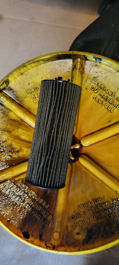

This is the triangular aluminum piece I removed to get to the filter housing. There were (3) 10mm bolts.

Old Oct 13, 2022 | 01:19 PM

I just crawled under the car out of curiosity. I think I see the triangle you are referring to but I was able to remove and replace the filter/ housing without removing it. Just need to angle it a bit.
Next time I get the car off the ground I’ll take a closer look.
