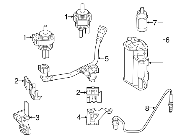

Can anyone tell me if this part ( JY53-9B051- SO ) PURGE VALVE for a 2019 Vantage has a Mercedes Benz AMG equivalent? The Aston Martin one is on Back Order with no ETA?

I am quite familiar with MB EPC and given that the new vantage is a M177 engine, I am guessing it's this equivalent 205-470-87-01-64. Item 1 in the picture below.
That said, if you have an actual picture of the AM purge valve, it will really help. Strongly recommend you do some research as well before purchasing. Good luck!

Thank You so much. That diagram is exactly what it looks like. Really appreciate this info
